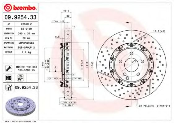

No bro.,
Slk55 Front Rotor is (340x32)..!
Front 6-pot calipers from SLK55AMG. Can I use 345mm brakes?-slk55-1714210112.jpg
Front 6-pot calipers from SLK55AMG. Can I use 345mm brakes?-john-s-c55-rotor-6-pot-caliper.jpgFront 6-pot calipers from SLK55AMG. Can I use 345mm brakes?-john-s-c55-rotor-6-pot-caliper-1.jpg
Front 6-pot calipers from SLK55AMG. Can I use 345mm brakes?-john-s-c55-rotor-6-pot-caliper-2.jpgFront 6-pot calipers from SLK55AMG. Can I use 345mm brakes?-john-s-c55-rotor-6-pot-caliper-3.jpg
,,ZAYED,,

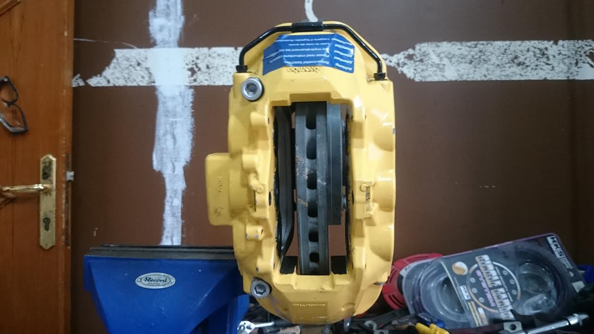

Changed my mind on painting calipers, because my car is silver and I don't think yellow or orange calipers will suit my car. Just done a touch up to mask scuffs, I'll leave original color Not like new of course, but I think on a car it will be OK

Looks NICE,, i think you will use 2-piece Rotors isn't..??
