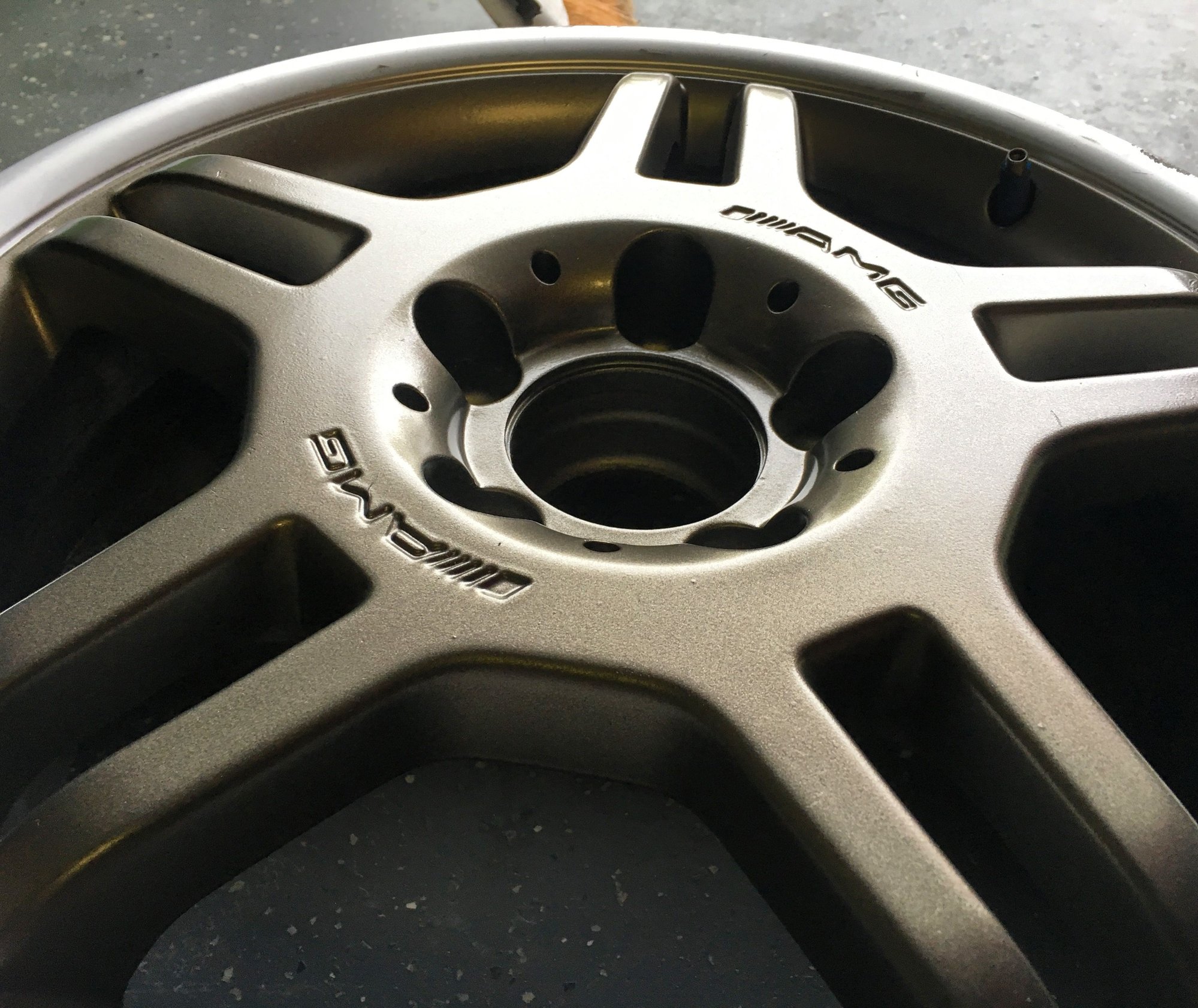

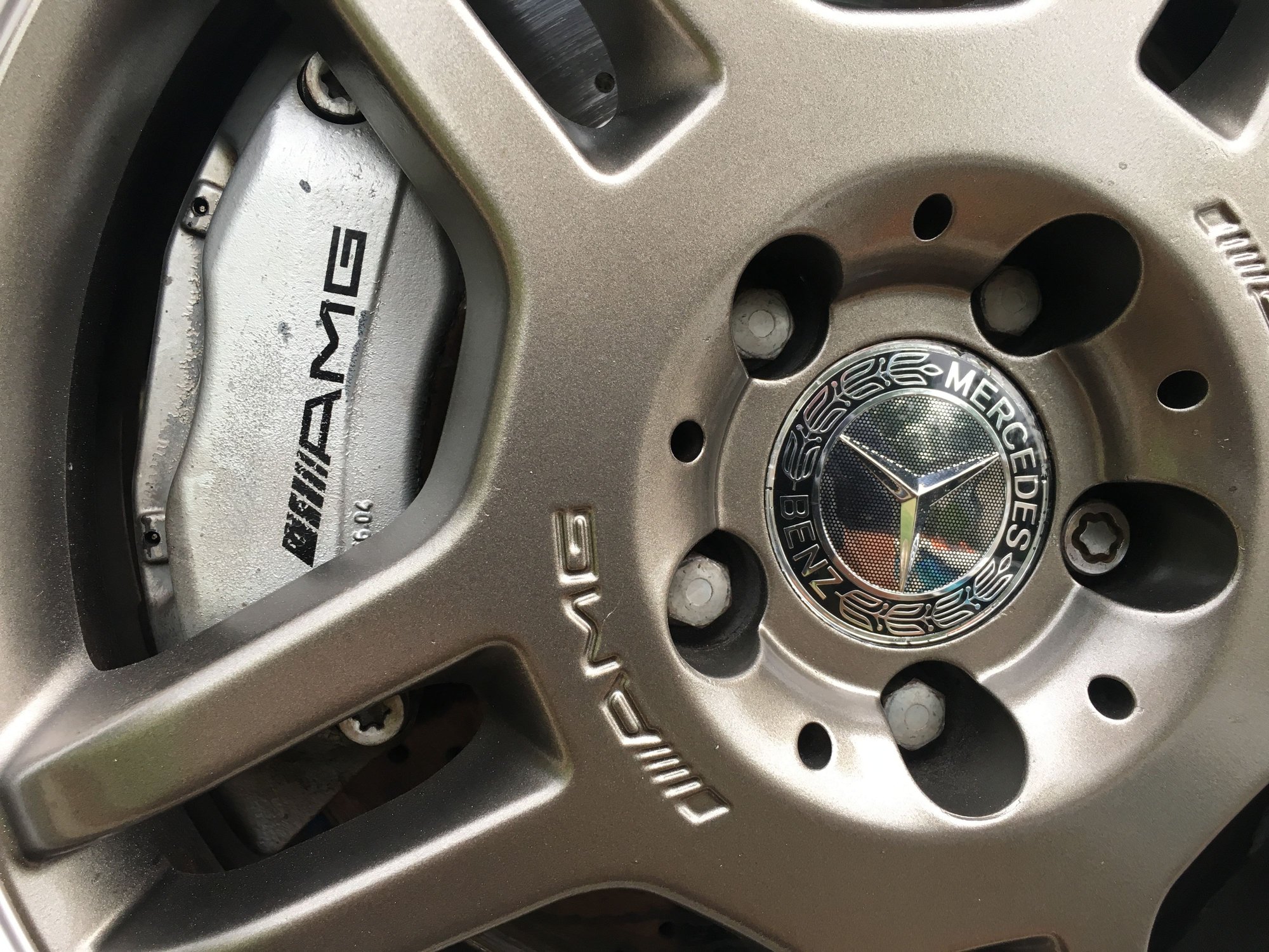

The paint on the wheels had gone to crap from brake dust and improper use of cleaning chemicals, so when I changed the tires, I did a quick rattle can respray.

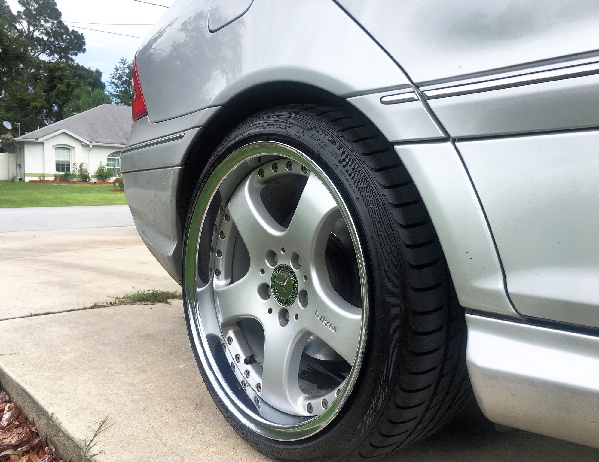

Well, I know that I have more important things to fix on the car, but I got a new set of wheels for it, lol. I wasn't planning on it, but a set of fairly rare Carlssons in a very attractive width and offset popped up for sale for a fairly ridiculously low price, so I couldn't resist. Oh, and they came with good tires in correct sizes for my car.
Carlsson 2/5's 18x8.5 et35 and 18x10 et30!
They're not perfect, but I only paid $350 for the set. Considering that they're worth about $1200, I really can't complain.
