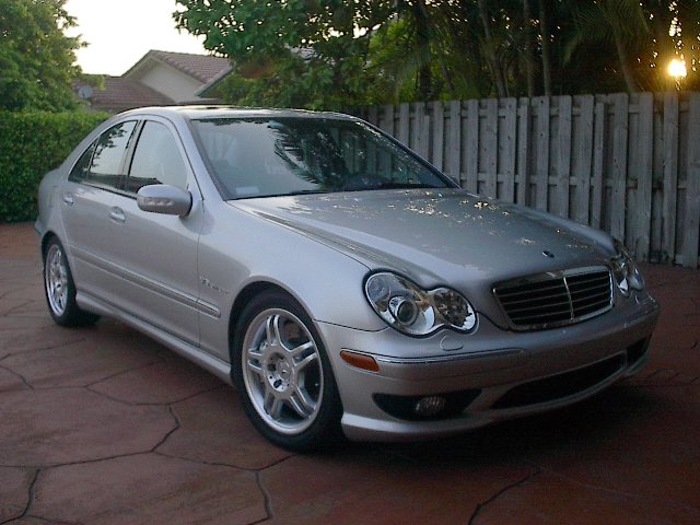

trunk full of luggage and 2 ppl in the back seat...
Attached Thumbnails RENNtech spring guys where r u? help needed.-img_0478.jpg

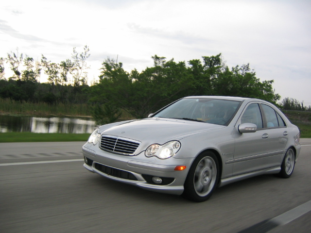

from a further angle.... 2ppl in back seat and luggage in trunk..
Attached Thumbnails RENNtech spring guys where r u? help needed.-img_0476.jpg

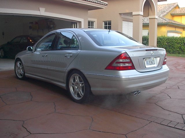

what about without people in the rear? any picture of that?

this was be4 the springs settled and the car got a little bit lower.. probably .2 inches lower after they settle in!!
Attached Thumbnails RENNtech spring guys where r u? help needed.-im002131.jpg

thanks for the picture. I'll probably go w/ either #2 or #3 pads.
