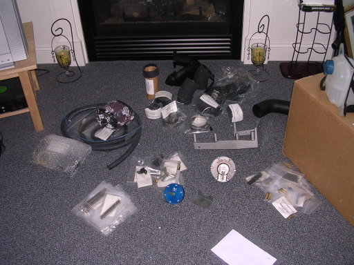

Car went in today guys, I had to acept the fact that I just don't have the time or proper facitlity to support this install. I promised myself I wouldn't pay to have this installed so I feel a bit defeated. It's been too long and it needs to go in.
I just hope these parts work better as a supercharger than a dust collector. I have to admit they have been damn good as a dust collector. My girlfriend seems to think that all the car parts really tie the room together. A nice industrial look edge to the room.
Pray that things go smoothly.........

Sorry for my ignorance, what are all this parts for?

It's a supercharger.

What are the power gains ?

What's AFR?
I hope to get around 315hp at the wheels. My baseline was just under 240hp so around +80hp at the wheels making the engine a little over 400hp.
AFR: is air fuel ratio. The supercharger will force extra air into the combustion chambers so additional fuel is needed to keep the ratio proper. I've purchased a better fuel management unit than what was supplied. It will allow further adjustment which is good if I deciede to up the boost or modify anything that alters fuel needs.

Does the HPS unit come with a "chip" ? I would think that if it did, the chip would address the fuel management issue.

I actually love the sound of it. It sounds like an SVT cobra. I think the SVT cobras use the same magnasun MP90 that the HPS kit does. I also think the ford lightnings use it to but I'm not certain. The air filter actually mounts behind the passenger headlamp. It should have very little exposure to road junk. The system really is damn simple. A basic but proven design.

No chip. An adjustable FMU(purchased separatly) to keep fuel pressure at the motor, and a little electronic box that wires in line between the ECU and MAF sensor. The rest is pretty much plug and play.
