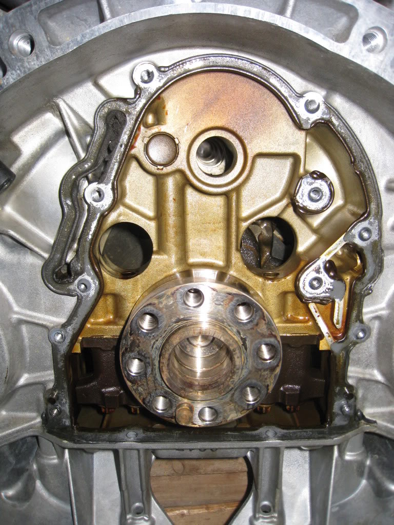

I had originally left the 55 flywheel on, but it was worse than it is now - wouldn't idle at all (whereas right now it barely idles). The part numbers are the same, and I figured if I had somehow bent the 55 flywheel when bolting the engine and trans together, I would go back to what the car knows. Clearly, no luck yet!
Old Oct 11, 2011 | 07:40 PM
  #524
911mot's Avatar
Joined: Jul 2011
Posts: 18
c43 amg
I can't see how its possible to fit the flywheel wrong with the dowel there.
Did you turn the engine backwards at any point? Im guessing the timing chain has slipped on the front lower crank pulley
