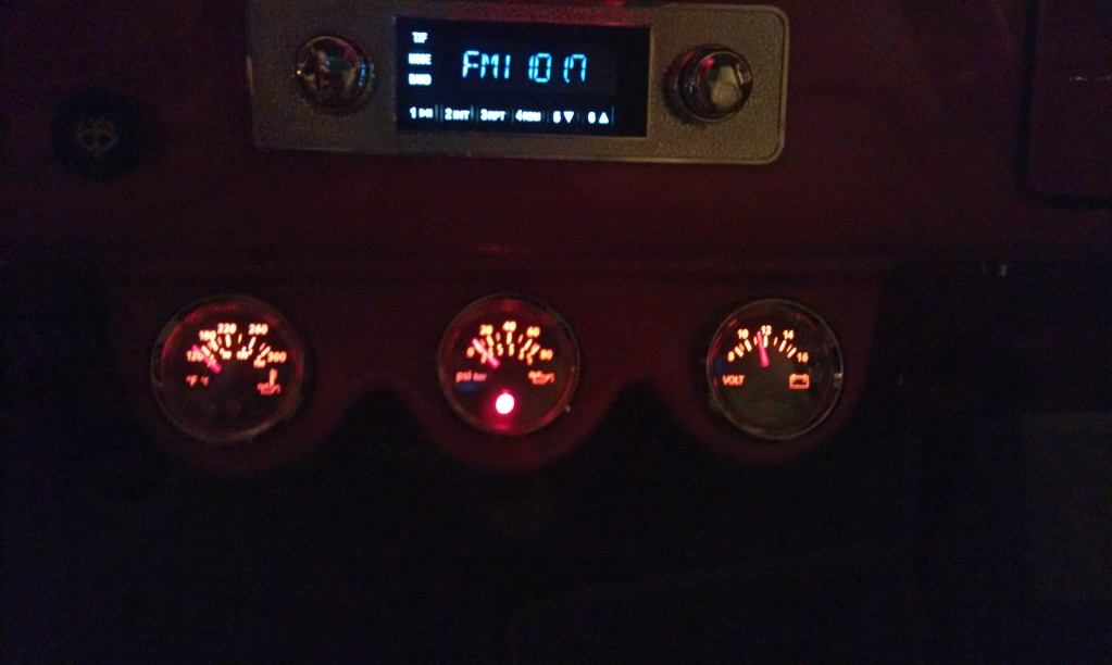

Originally Posted by kowalski
when you buy 1 gauge kit from VDO you get 2 color hats, green and red and all necessary mounting parts.
you just press the hat onto light bulb.
our clusters have orange illumination, it will look weird if you have three 52mm gauges with other than orange backlit color.
ask your nearest radioschack dealer if they can sell you 3 rubber hats?
I am curious if you're ever going to need that adapter for oel pressure sender?
Also for the viewline gauges, this is how they look illuminated
should be close enough for me

could this cubby compartment be used with plastic gauge cover?
how many bots are screwing this cubby compartment in place?
is it 2 in front of the gear selector where original screws for ashtray is bolted?
I have that cubby, so I guess we'll find out the answer soon!

when you buy all parts necessary for this gauge mod please decribe each part with correct partsnumber for all of us following this thread.
Sorry SAABO I now realise we have hijacked your thread.
Pliz forgive us.
