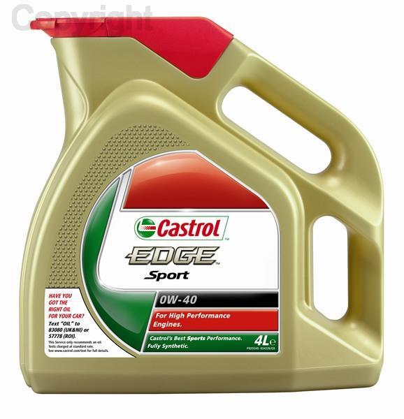

isn't castrol edge the best engine öl today?
do they come in 0w40 viscosity?

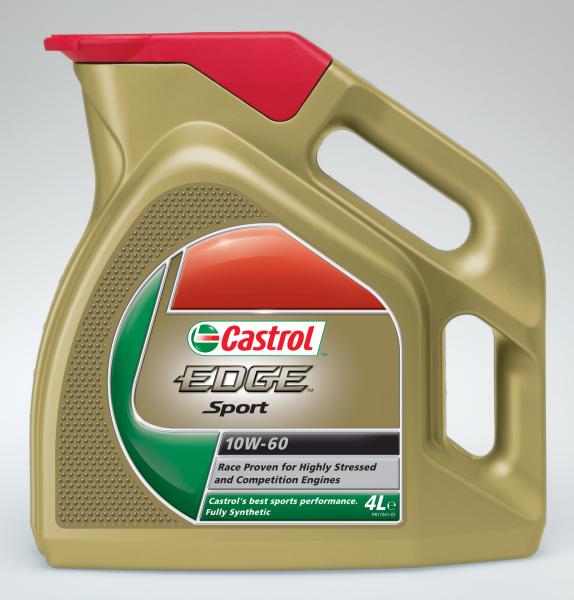

Agreed,,
I always using Castrol Edge sport "0W-40 or 10W-60", they’r great......
