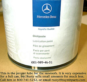

I found some info out. Mercedes carry's some special sunroof grease but its pretty pricey. Its called Gleitpast Grease.Here is the part number # 001-989-46-51. But people are saying to email this guy rusty@mbparts.com and he can hook it up for a better price.
Also if anyone wants to buy the tub heres the website, http://www.pelicanparts.com/cgi-bin/...art%3A%20PASTE
Attached Thumbnails Anyone has any tips or Diy, doing some maintenance and lubricating on the sunroof of-special_lube.jpg

People are saying don't use lithium grease because it can start getting runny on a hot day. And people say that dust sticks to it. Every where I read people say to be really careful with the stuff you use to lubricate the sunroof. I read that the special grease that mb offers prevents dust and dirt from sticking to it. HERE'S a PDF file on which parts to clean and grease on our power sunroofs. IT looks fairly easy. Just use a soft micro fiber cloth or Terry cloth to clean the rails.
