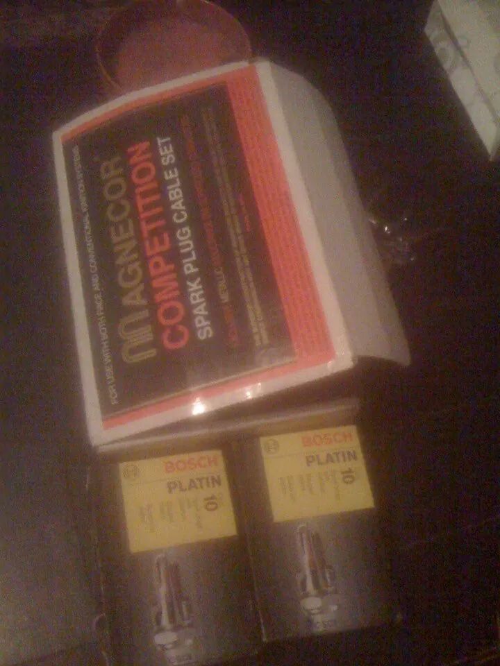

These are the ones i put in. Bought from a member here brand new
you tell me if they are original or not but it really doesnt matter to me right now. Got them for a good price with plugs...

Can't tell from the box..!
