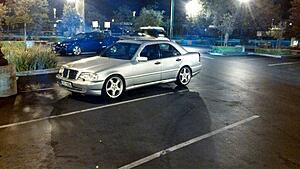

Well guys, got everything wrapped up, here's a quick shot of her. Sorry for the low quality pic. Im pretty happy, a few little things to wrap up still but I think she's good......For now
Let me know what you think, and thanks for all the help.

Looks great!! Are those SL wheels?

Thanks man! They are w211 amg's, almost identical to sl's but I think the offset is different.

yea looks good. you are right that drop does look like alot. were they new springs? they look like that are already "settled".
Im debating on swapping my euro springs for the H&R sport, but no direct feedback on them being any stiffer than that ones i have.
