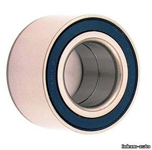

Yes, hub got one big bearing only, i prefer to remove the bearing and inspect the bearing area, it could be expanded,
*if you want bearing kit, part #: "202 980 00 16"
*if you need only bearing without hardwares, part #: "202 981 01 27"
