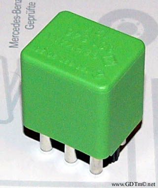

Yes this relay comes in green or orange(as optional), and it's located in trunck, above spare well..
*Green #: 001 542 96 19
*Orange #: 001 542 97 19
Attachment 297983
Attachment 297984
ZAYED,,
Thank you zayed, interesting because I only see one relay in the trunk next to the fuse box. And it's black and the prongs are flat not rounded like your pictures and it does not have a fuse mounted on top of it.
Maybe it's because I'm in the United States?

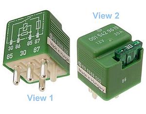

It's good point, i didn't know U.S version got a Black relay with flat pins,
your black relay #: 002 542 13 19, isn't..?
*Bosch create that fuse at the top of relay (as safety) to avoiding damaging relay line circuit,,

Yes zayed it's that black one. I ordered the beck arnley fuel pump. I know it's not bosh but I hope it makes the car run just as good. $103.00 shipped.
