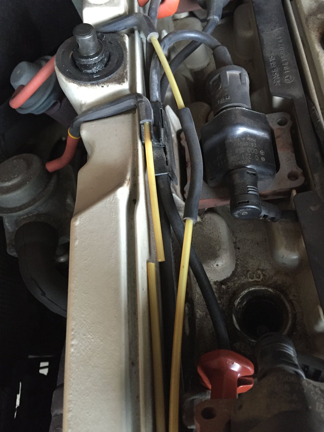

Was changing my plugs and snapped this brittle plastic line. What the hetch is it and is it easily found or replaced?
Thanks in advance!

Vacuum line! just did all my most visible and easily accessible ones.
Super cheap, I bought like 10-15 feet off autohauosaz.
c36 are notorious for these lines cracking and breaking, new lines are night and day difference, look and feel wise. New lines are clearish white with flexibility and they get yellow and hardened over time and tend to break

On Autohauz now. Is this what you bought Jasssc?
Cohline 0001581435 - Vacuum Hose/Line; White; 1mm ID x 4mm OD; Bulk

buy about 6 or 8 feet of it and replace every yellowed, aged vac line under the hood.

just fix it with the black soft rubber piece which u see next to it and u are good to go.

Hello Dutch,
I see the black rubber piece u speak of and assume the vacuum line just sticks in there (and can pull broken off piece out of there). Could you be more descriptive in your response as I may not be following?

Yep! remove the old stuff, cut the new piece to the right length using sharp cutters (I used air line cutters) then you should be good to go. I bought (10) pieces of that

correct.
just get that soft rubber coupler and stick in the broken ends. its basicly the same whats on the right. (excuse my ****ty english..) name a lengthener(????) //coupler..
ive used this to fix my pneumatich seats .. in the as the car ges older these piping tends to break.. with the black rubber couplers its not nessecairy to replace the complete hard plastic tube/line.

Thanks everyone I'm just waiting on lines to come and the rubber pieces seem to be in great shape so hopefully won't need to replace those.
