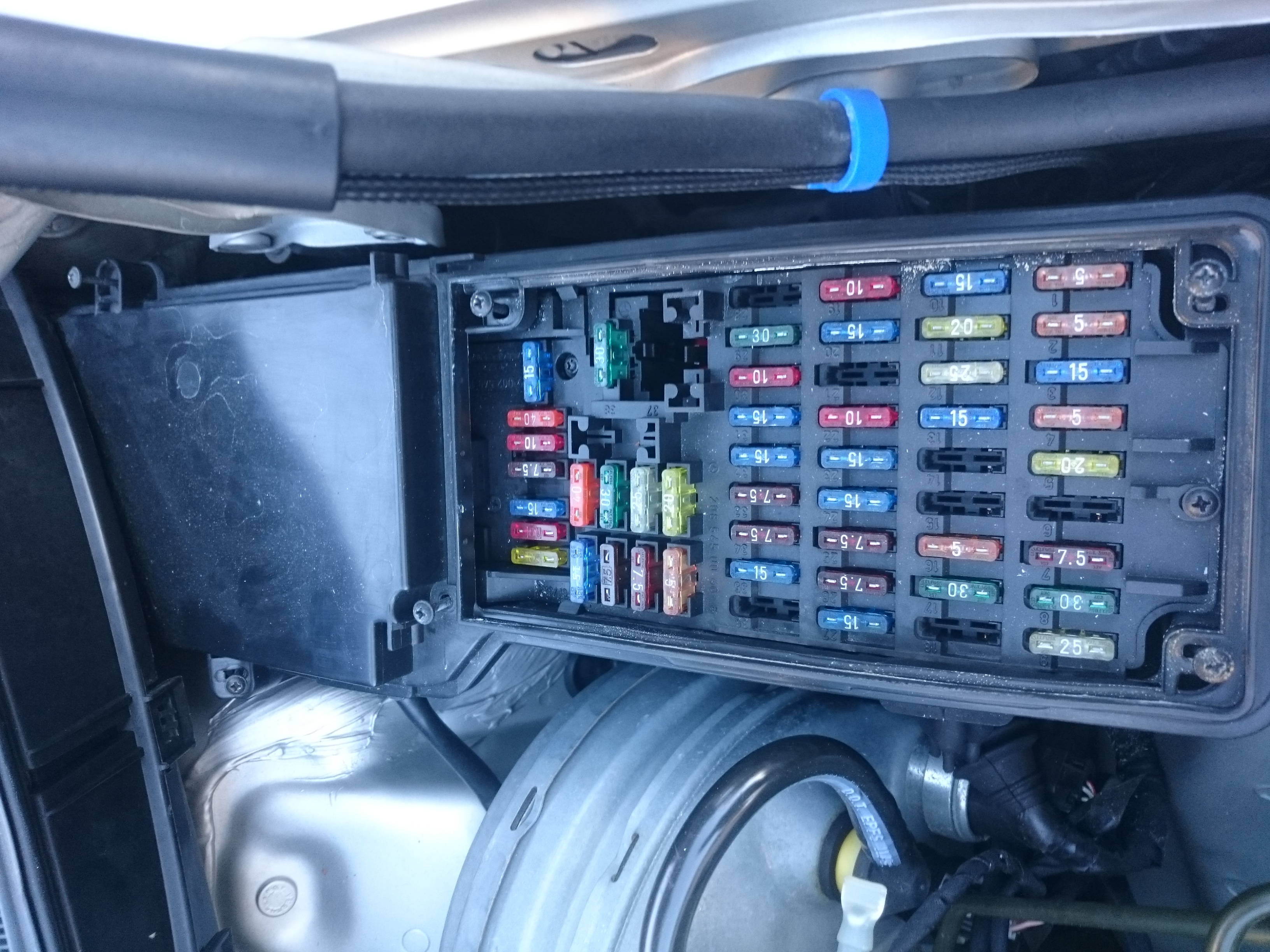

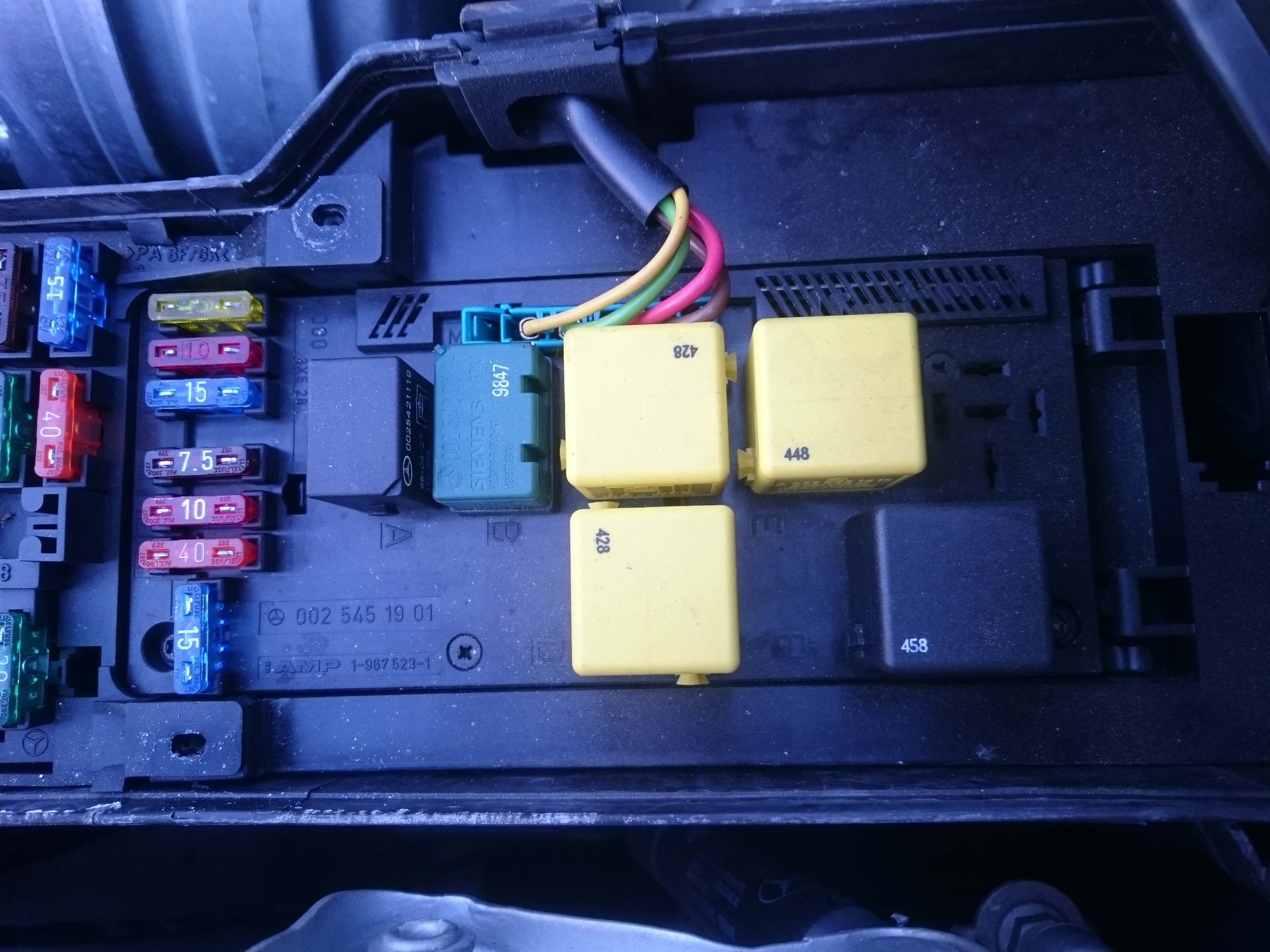

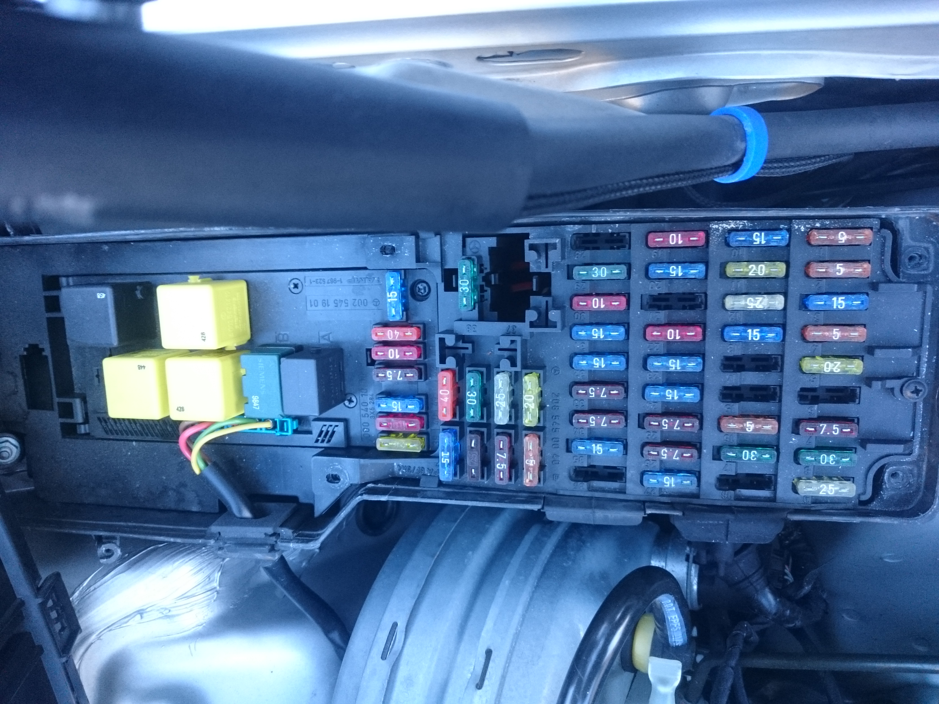

Kowalski better answer your question and light up your bride, I went out and made some photos of the fuse box and relay box behind (not those in the trunk).
First of all open the engine hood all the way up vertically. It will greatly help you get to the back of the fuse box.
Remove the fuse box lid (I imagine you know how to do that...). Check the fuse card identifying all the fuses etc.
Fully unscrew the 6 cross head screws holding down the surround without removing them from the surround. This is to ensure they are not dropped in the engine bay and lost.
Pull gently forward the surround. It is a bit fiddly but it comes out without any other surgery. You then have access to the relays behind the fuse box.
Reassembly is the reverse and should not be problematic. All told the whole operation took about 10 minutes including taking photos.
Hope that helps
