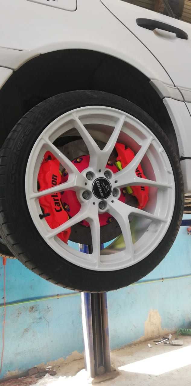

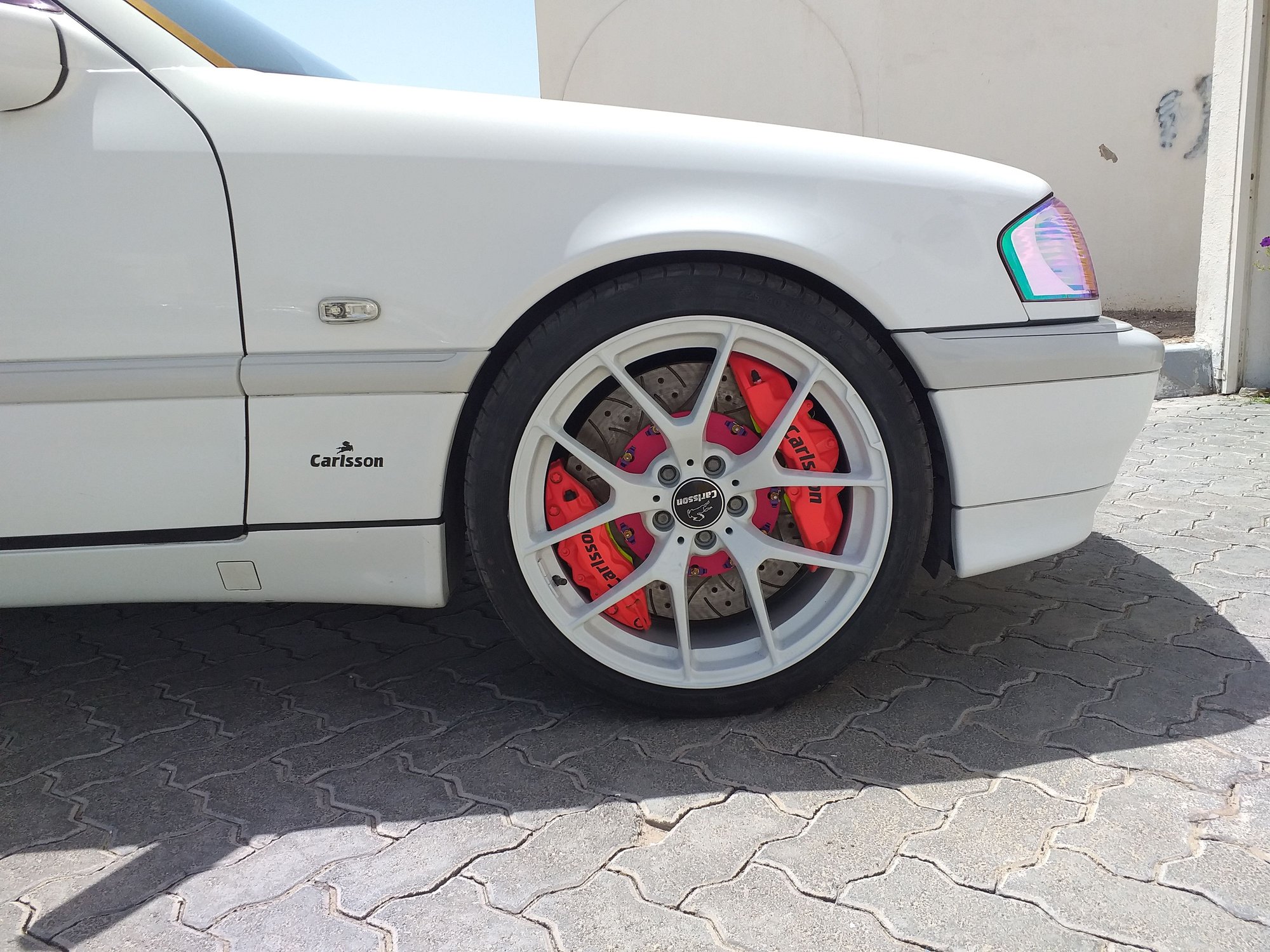

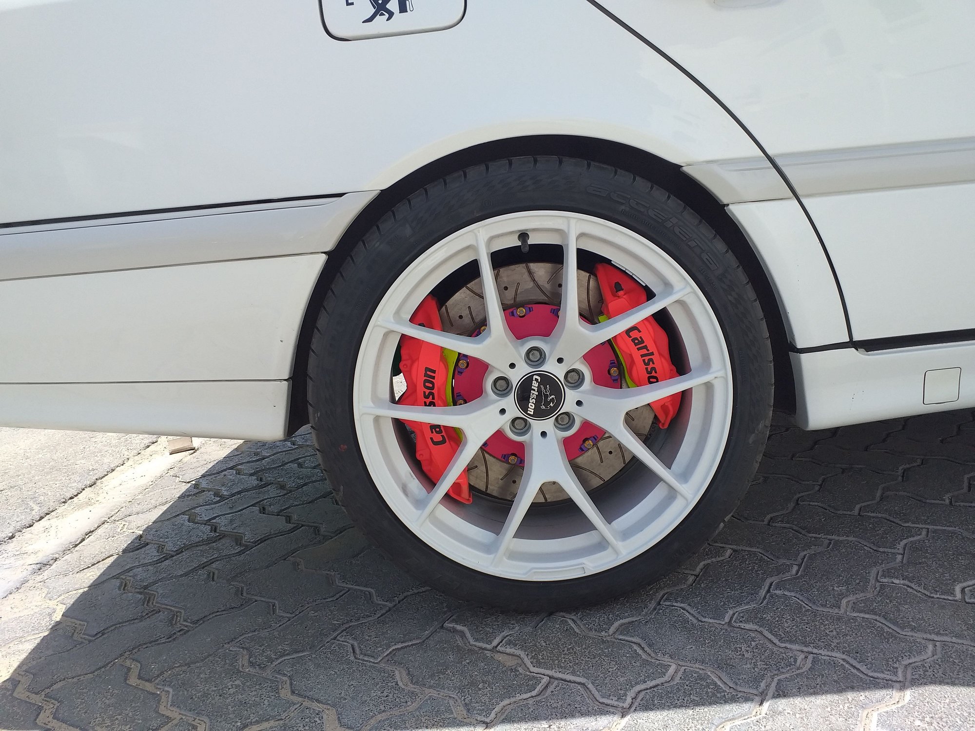

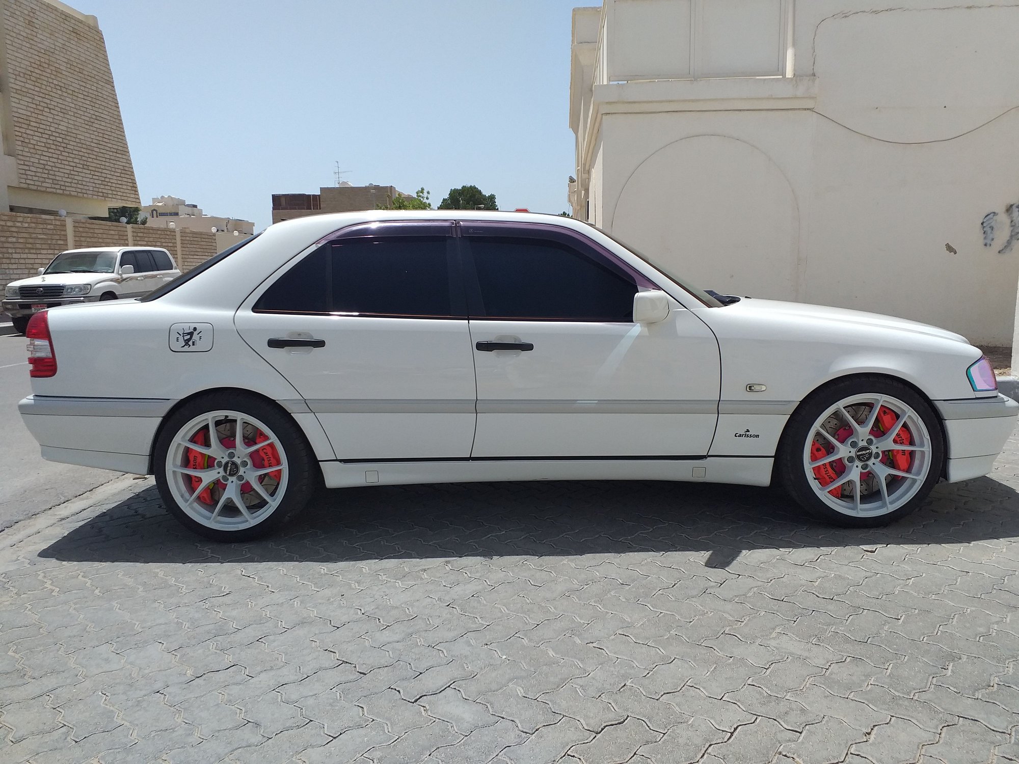

Just installed dual Fronts (8/6) & Rears (6/4) calipers in 00 "C200",,
sorry for poor pics..!!

Needs so many things bro.,
"cutting with making holes on many places in F&R spindles/made 2 Front brackets & 4 Rear brackets with special titanium flat head screws/T-type brake fitting adapters with banjo hoses/S210T Rear hub & bearing to handle the weight"..

i can't keep stock M/C & booster, replace them with "R230 SL600", with some minor works with "wiring/lines/hoses",,
brakes are sooooo aggressive, can't imagine how spaceship brutal stopping power..

No problem with ABS or even unsprung weight to the braking limit bro.,
while the pressure sensor reads properly back signals from "ESP" to the "ME2.0/ECU",
cause this 4cyl. "C200", doesn't has "ESP/ABS" additional module,,
module attached to the "ABS/BAS" pump..
