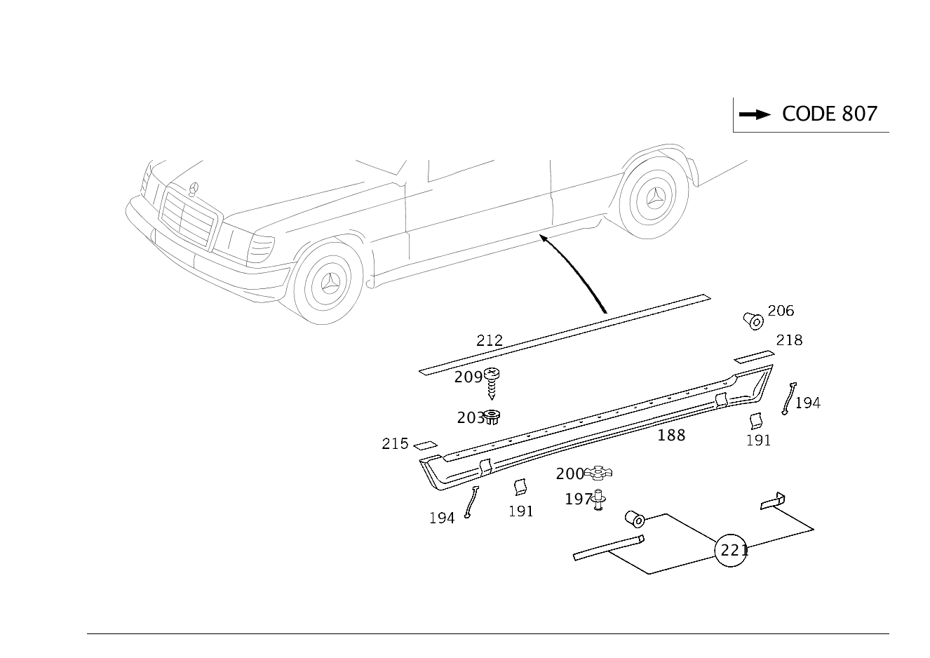

I’m going to take advantage of this myself. I have a C36 which appears to use double sided tape to hold the rockers in place. However parts 375 and 385 appear to be an evolution on the c43. What are those MB part numbers and doesn’t anyone know if that will work with the c36 rockers?

On this photo only, 375 and 385 are not double sided tape, they are the rubber seal pieces between the top edge of rocker panel cover, at the front and the rear end.
It will may possibly be a different reference # for the C36, C43, but essentially the same seal.

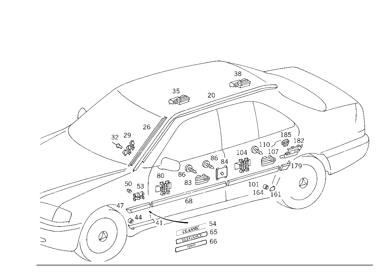

Checked the Daimler parts info on-line for US C36. Does this help?
C36 N. America
Old Mar 25, 2020 | 10:29 AM
DRBC43AMG's Avatar
Joined: Mar 2010
Posts: 5,889
Likes: 323
Or this??
C36 N. America

This is the correct diagram for my car. What is 194 and 221? Is the only mechanical fastening the screws on the top and bottom (203/209 and 197/200)?

194 is part #A 201 698 02 14 - it's the hanging strap for the jack hole cover on the rocker panel cover.
221 is part #HWA2026900214 - BRACKET PARTS KIT,ADHESIVE VERSION,LEFT SIDE SKIRT ATTACHMENT AMG &
part #HWA2026900314 - BRACKET PARTS KIT,ADHESIVE VERSION,RIGHT SIDE SKIRT ATTACHMENT AMG
EDIT:
203/209 are the fasteners that hold the top side of the rocker panel cover to the rocker panel/ 203 part #HWA2029880281 fastener button amg / 209 part# N000000000529 scew /
197/200 are the fasteners that hold the underside of the rocker panel to the rocker panel/ 197 part #197 A 000 990 46 92 expansion rivet amg / part #200 HWA2029880181 washer amg
There may be interchangeable parts for these - photos of where they will be used helps.

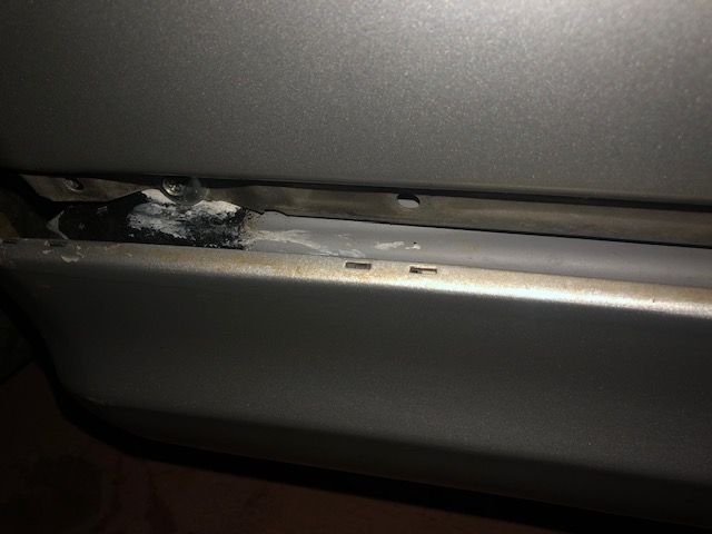

Alright, you see the 3 clip holes that run across the bottom of the front fender? (in the picture i caught 2) These need a clip that fastens the side skirt to the fender. They sit inside the weather seal that goes across this area. I don't know what MB calls it. What you think?

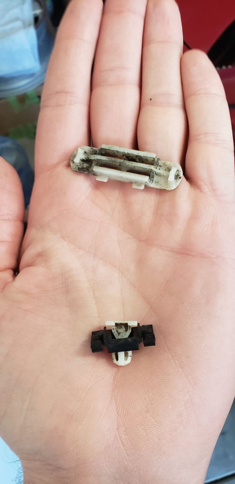

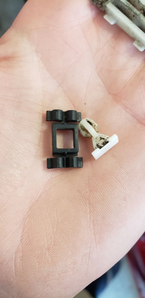

Yes. The frnts are two piece clips
Old Mar 25, 2020 | 08:18 PM
PJmak's Avatar
Joined: Sep 2007
Posts: 4,566
Likes: 421
Top pic is the rear clips and bottom pic is front clips
part68?
You are referring to the bumper trim fastener. (Need to describe it better)
A 202 880 07 93
maybe 65... A 202 880 02 93
Old Mar 25, 2020 | 08:37 PM

I see, PJmak has it exact. I have the rear ones. Thanks Khomer2, not bumper trim, c43 doesn't have bumper trim.

Sorry I didn't get back to you sooner and I realize that my attachment didn't contain the list of the part #s. So here goes with apologies for the lateness, but guess better late than never.... BTW the pdf file contains a blank 1st page but all the info is on the following ones
