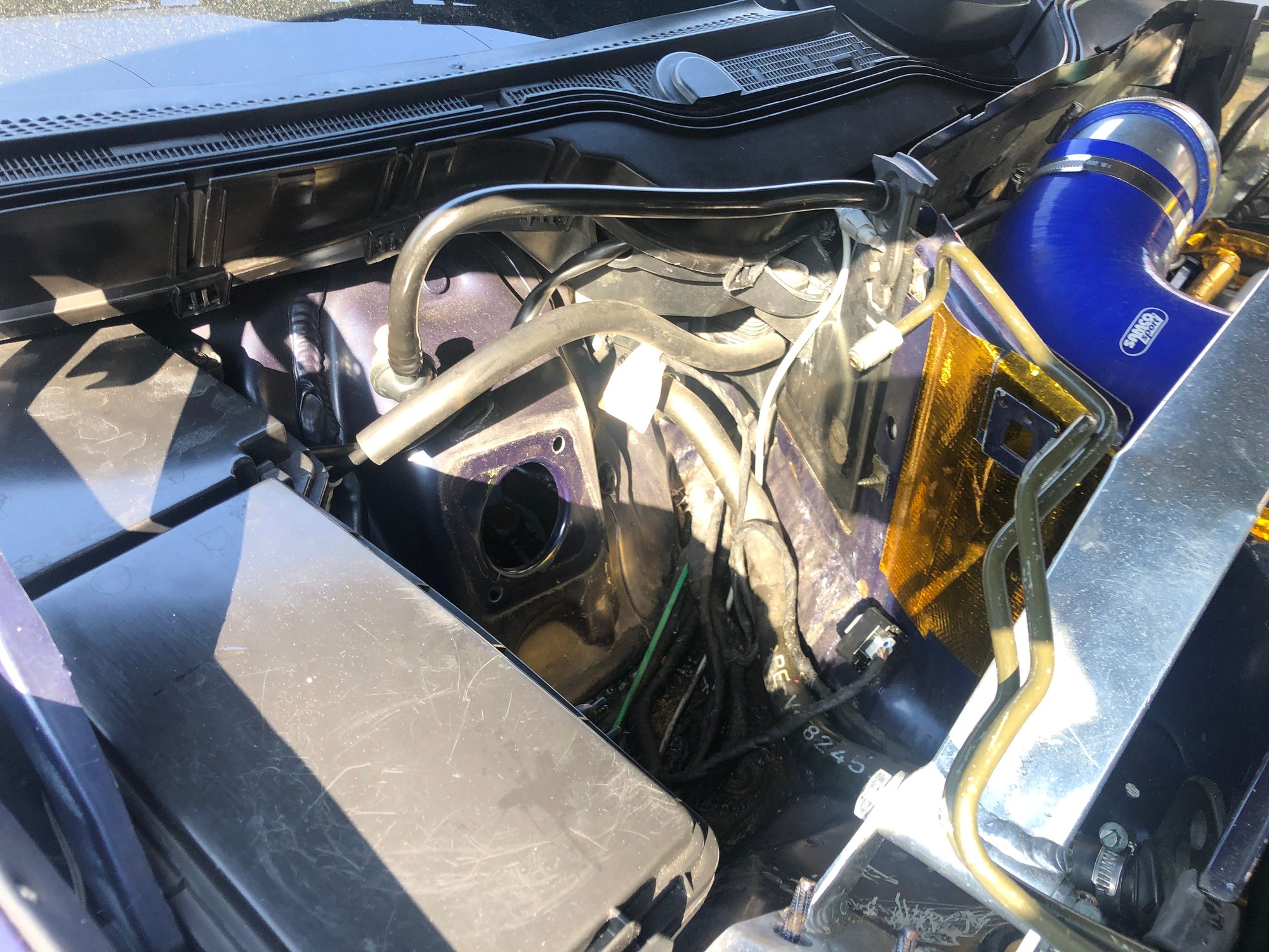

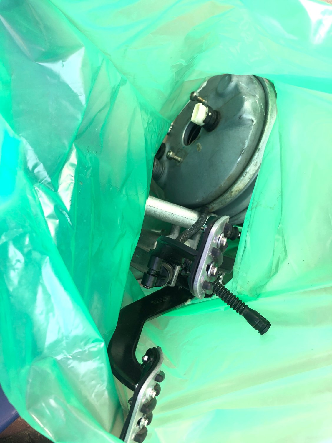

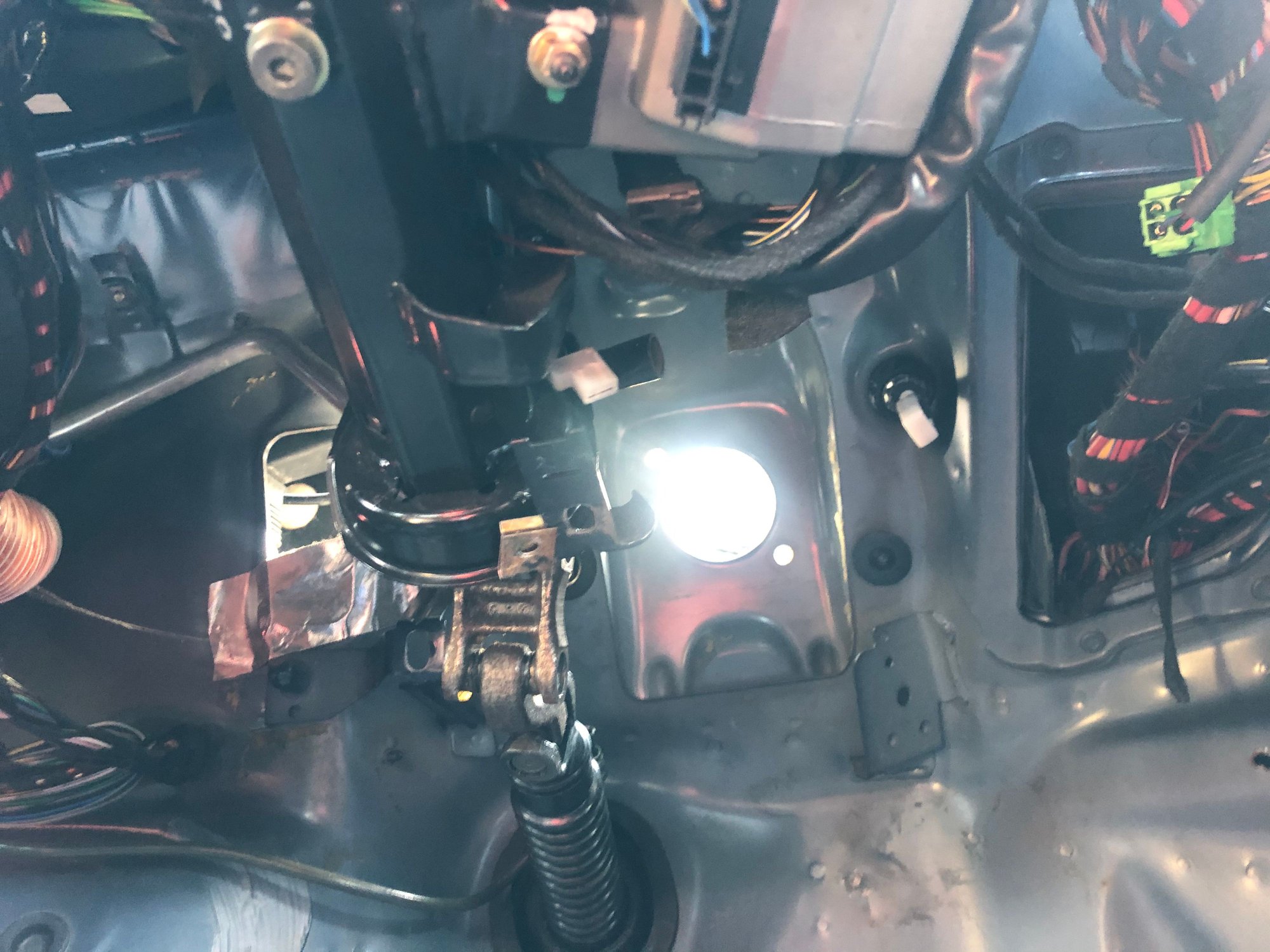

Stripping out the old parts

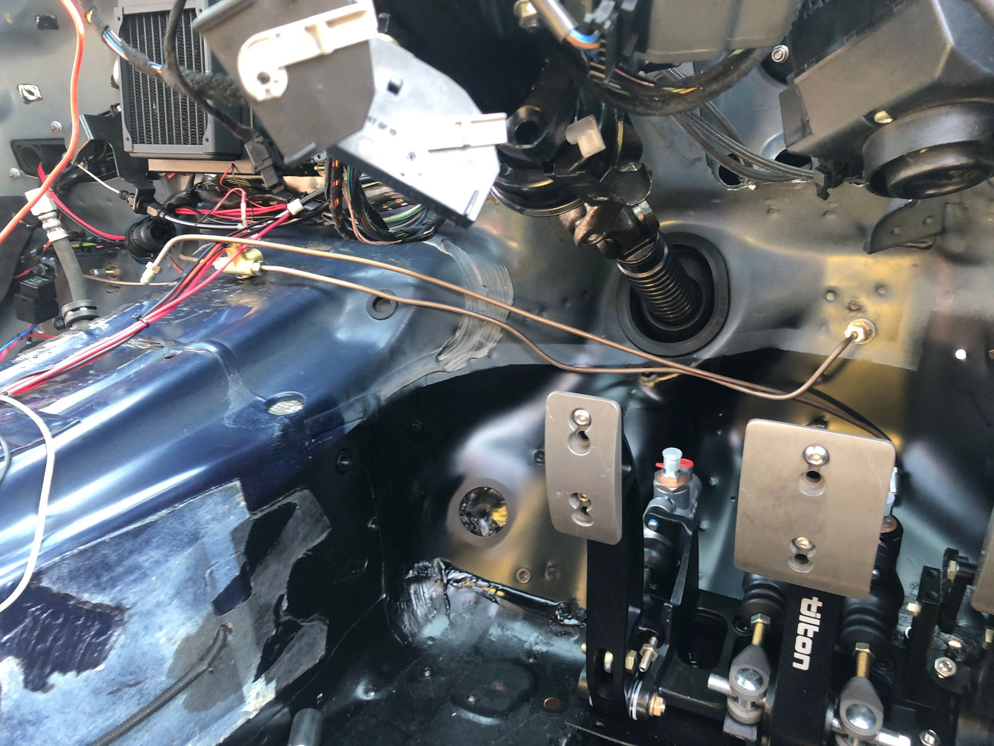

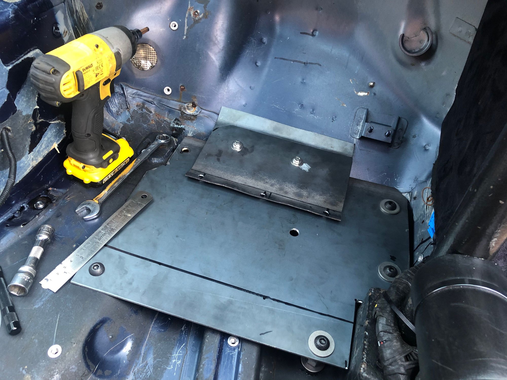

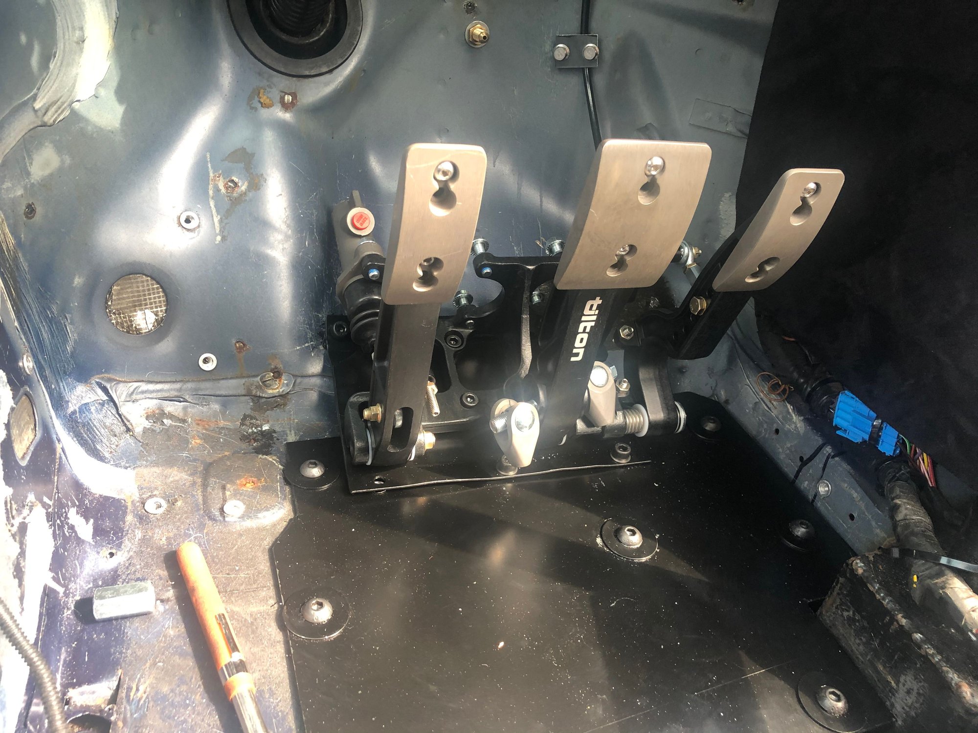

Making the base plates with the pedals angled up the bulkhead

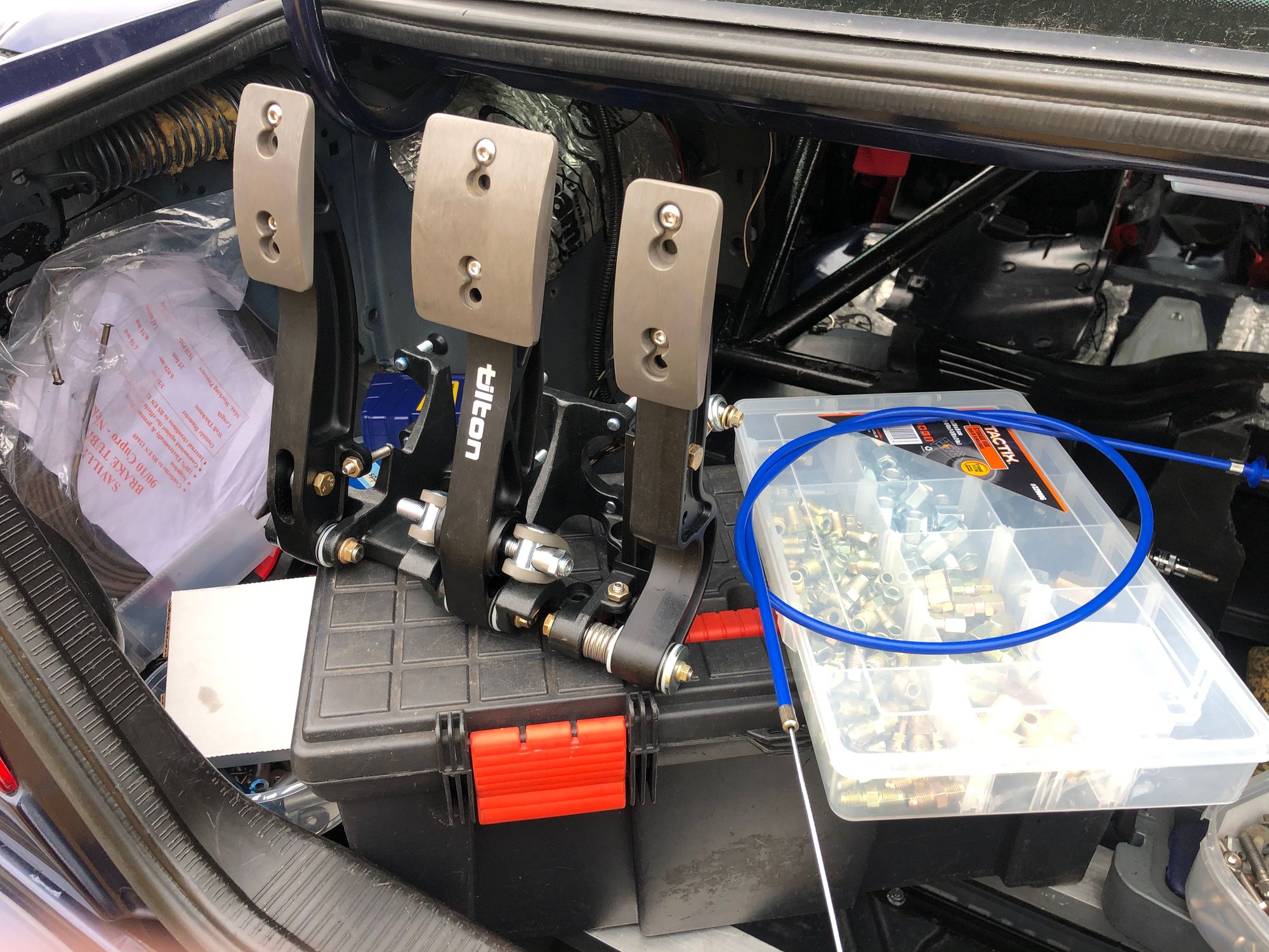

Tilton pedals are made top notch also quite east to mount

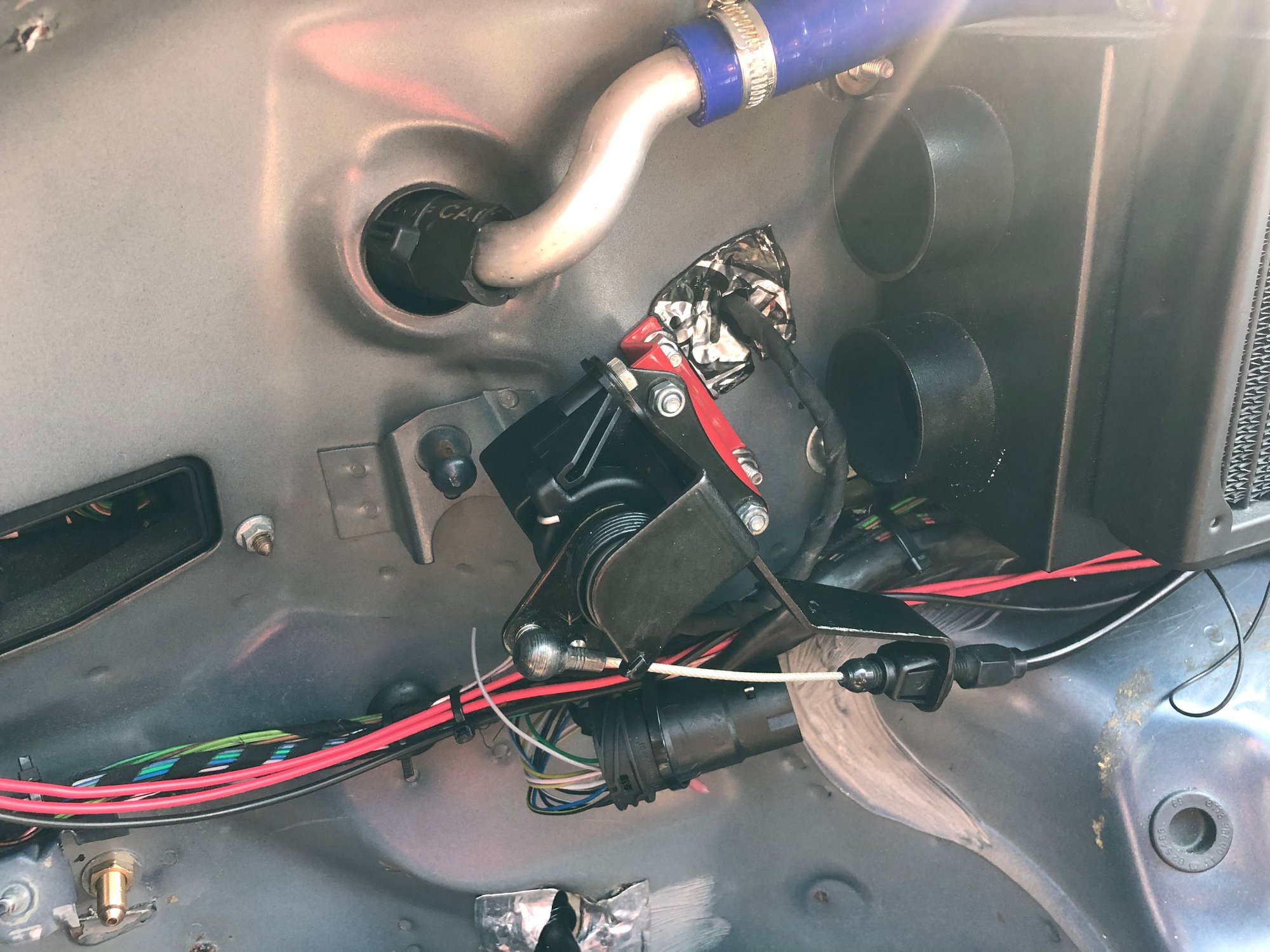

Moved the throttle control inside the car to make throttle rooting easy

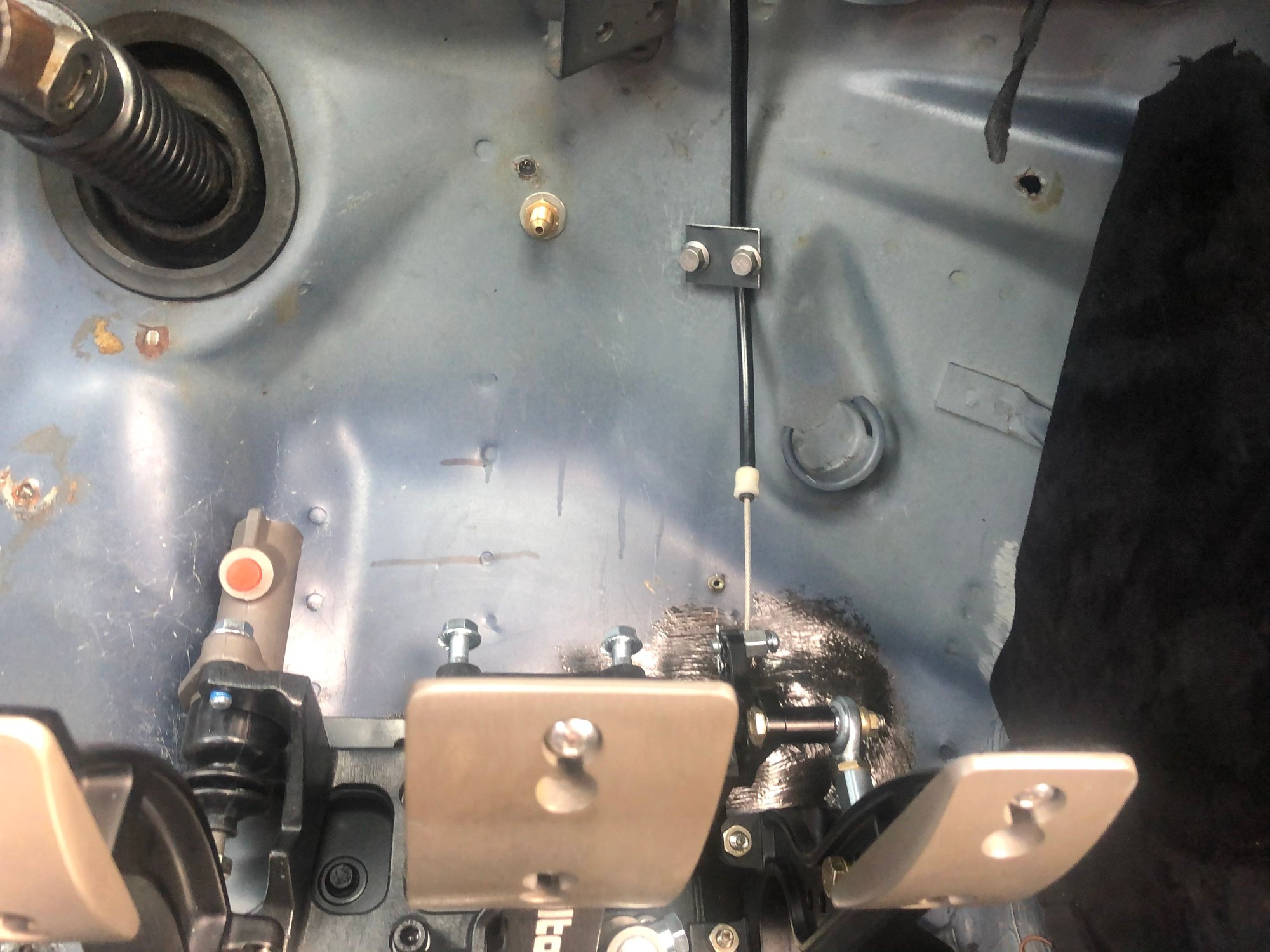

Got some cheap cylinders first cut them down to have pedal box as far back to fire wall as possible
Throttle cable rooting

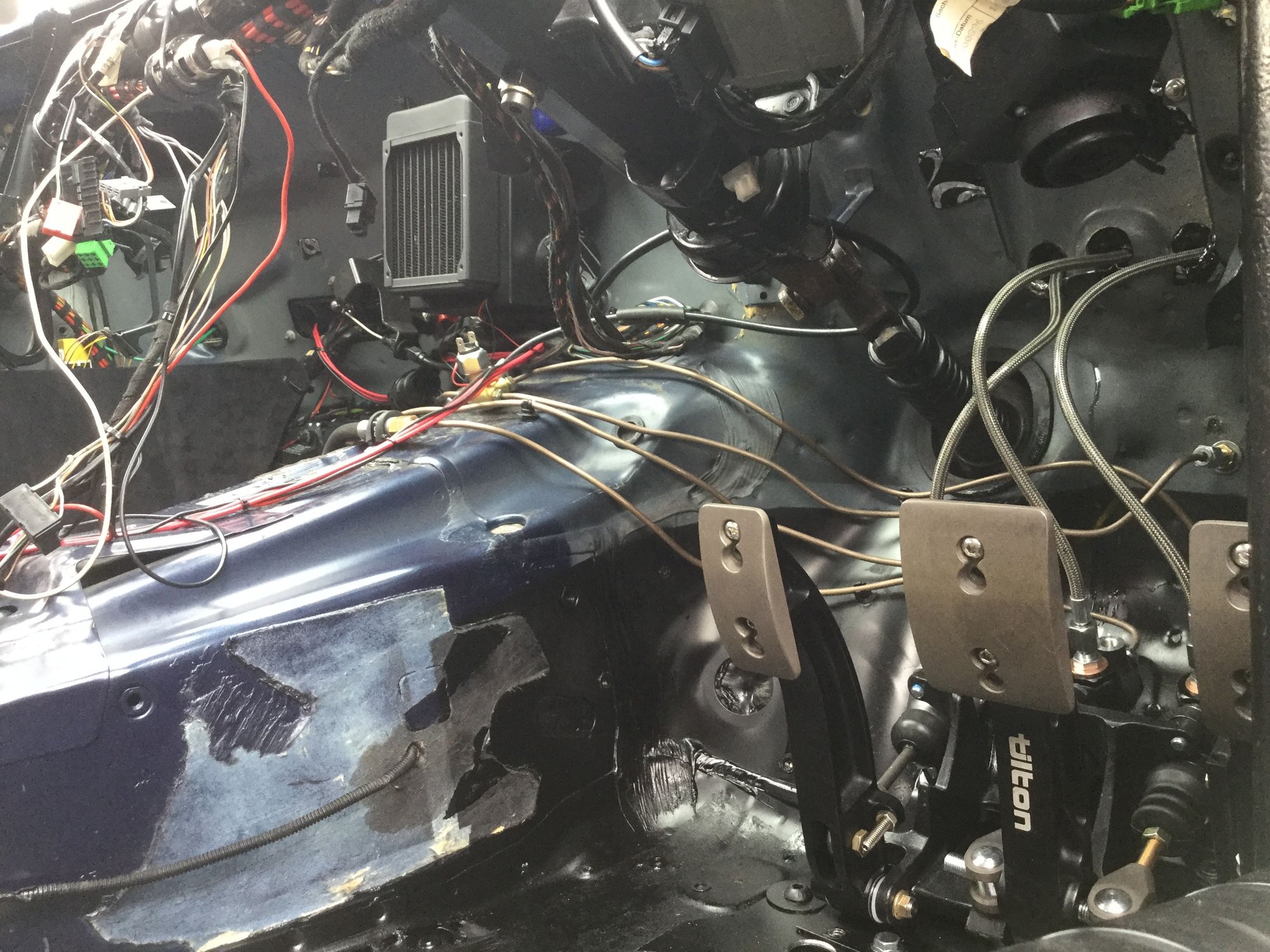

I feel like a plumber

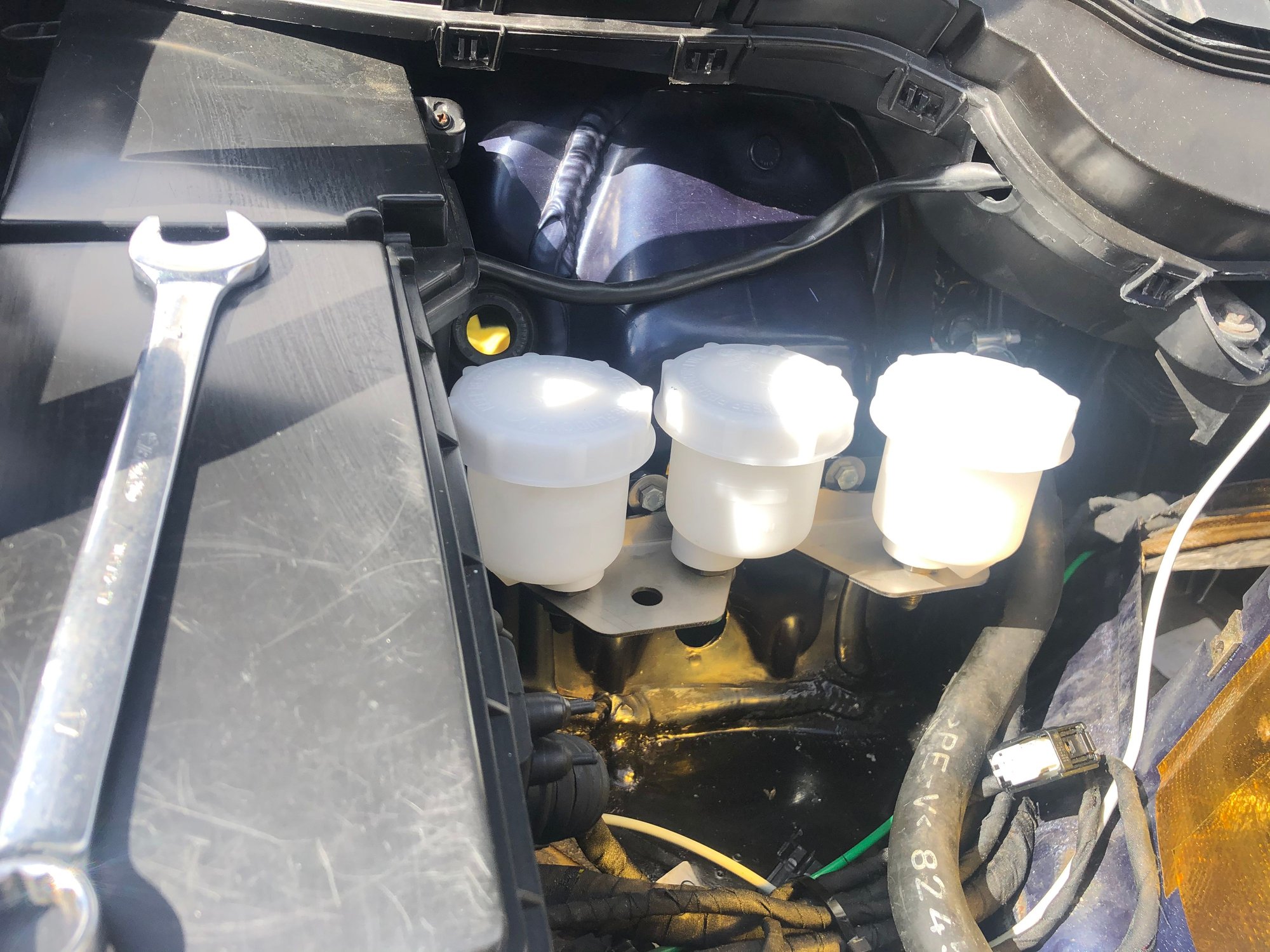

Fitted the Tilton master cylinders

I assume you are also using SS braided lines like those offered by Goodridge. I changed mine to the SS type on all four corners and this improved pedal feel (less sponginess).

So with the new set up there is no servo but 2 mastercylinders 1 for the rear brakes and 1 for the front brakes these cylinders have been correctly sized for the callipers they are acting on. I can adjust the brake bias now to
