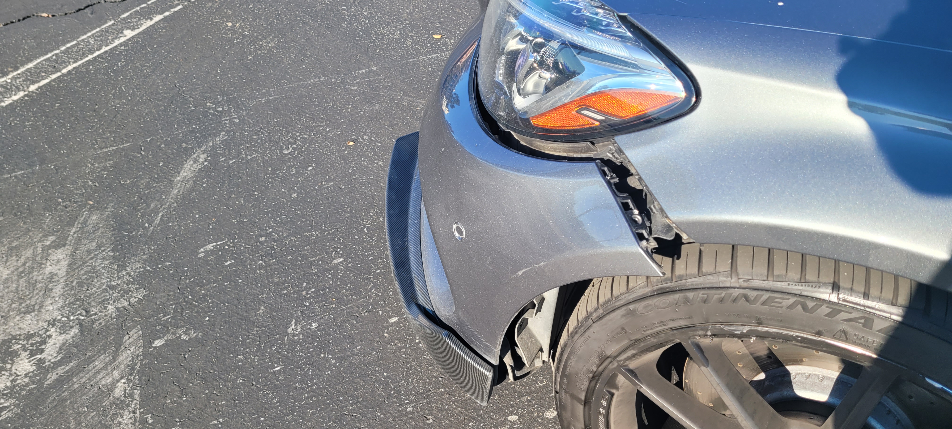

This happened to me too. There are bolts on the inside of the wheel well that hold the front bumper assembly on. If you have ever changed out your grill it is the same bolts you loosen to undo the bumper. Pull the front wheel and then take off the wheel cover that is on the inside of the wheel well. From there you will be able to see the bolts that hold the bumper on.
Attached Thumbnails Bumper ripped off by parking spot tire stop-20220102_144632.jpg
