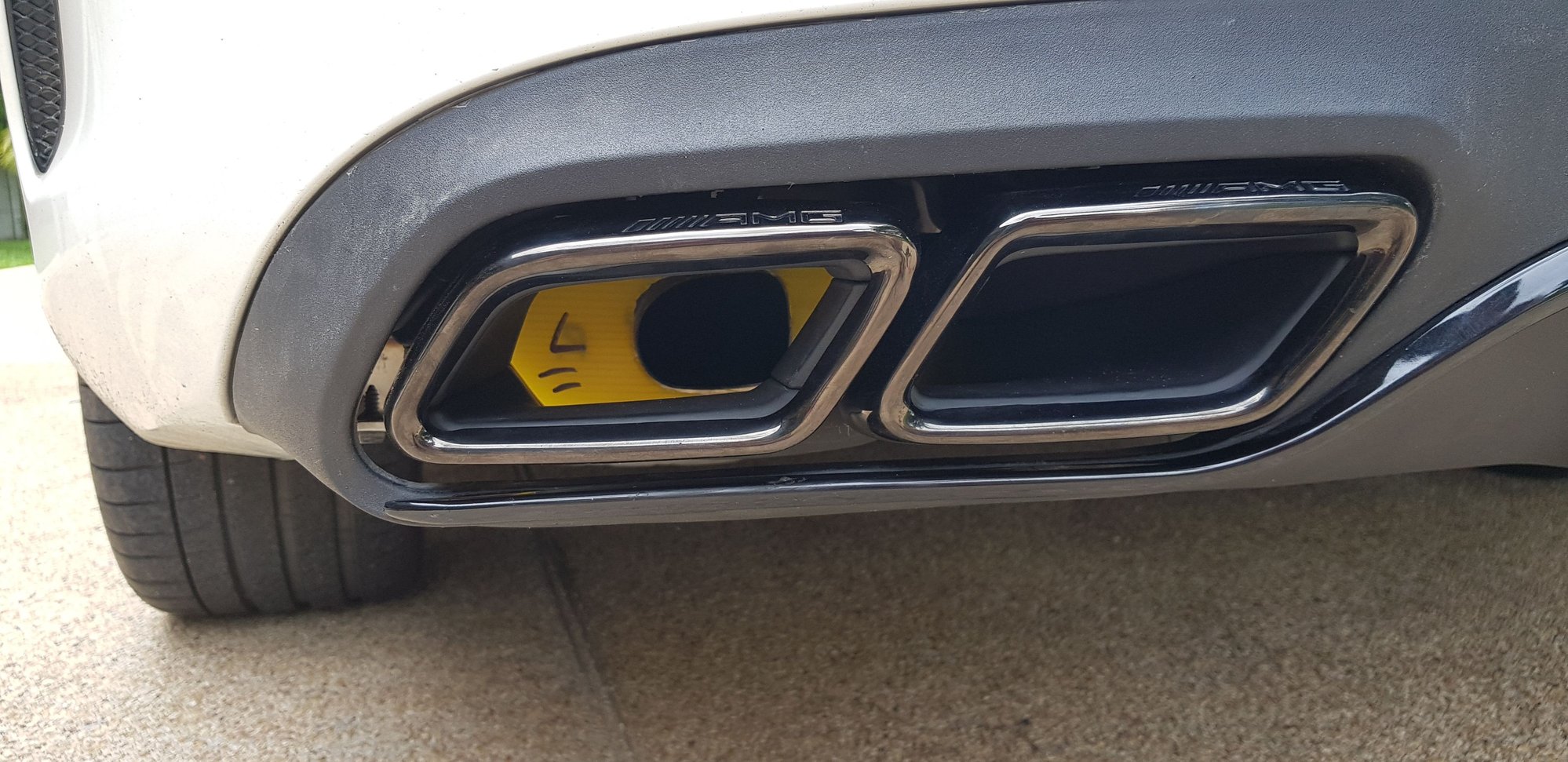

Left at start of project

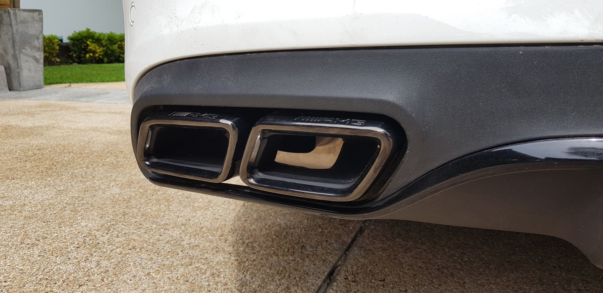

Right at Start of Project - Too much gap

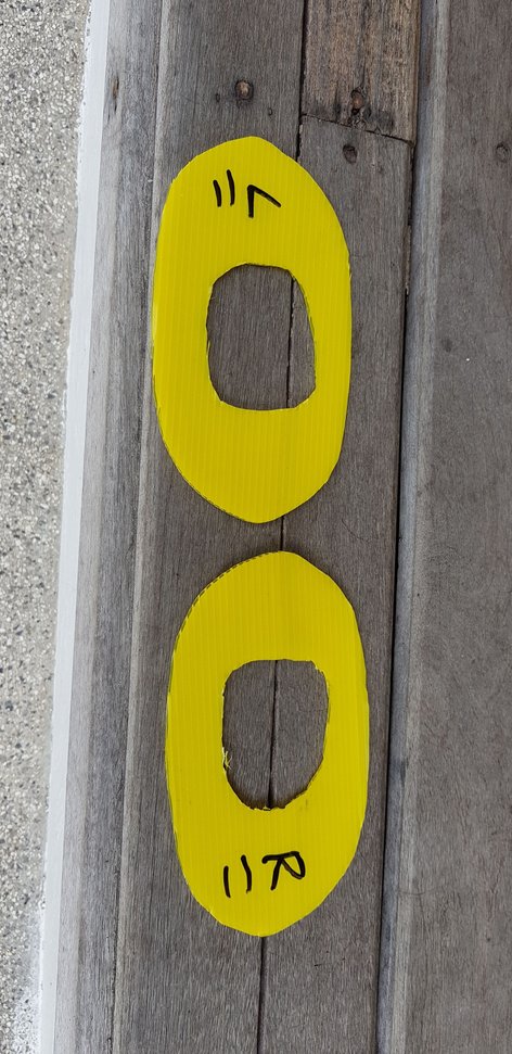

Create Template with some card and tracing
Completed Templates.

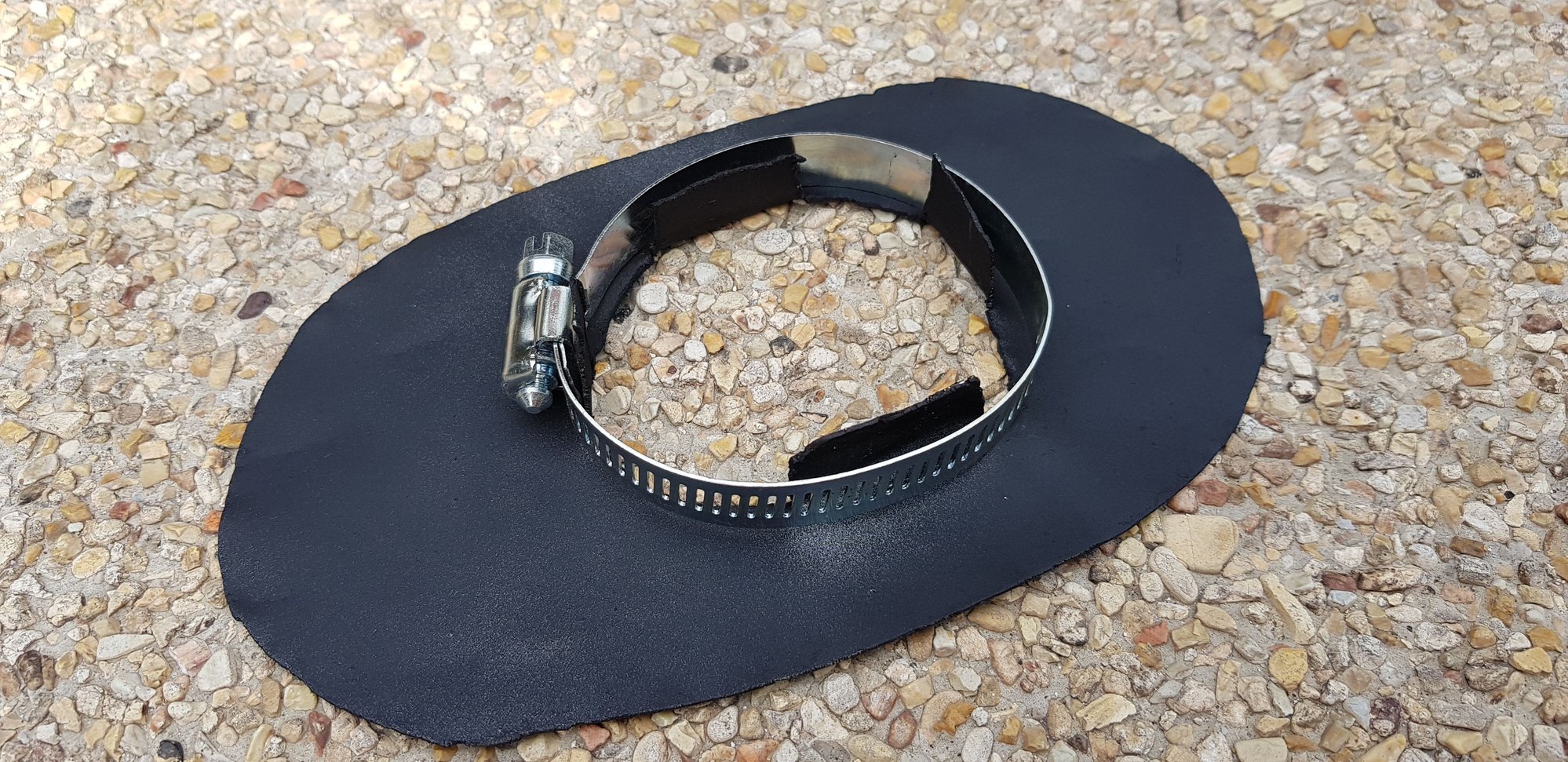

template cutout from 2mm galvanized steel. Create tabs from the exhaust tip cut-out and add a jubilee clip to secure. (Excuse the rough cutout with a hack saw - Its only proof of concept). Spray painted flat black High Temp Paint.

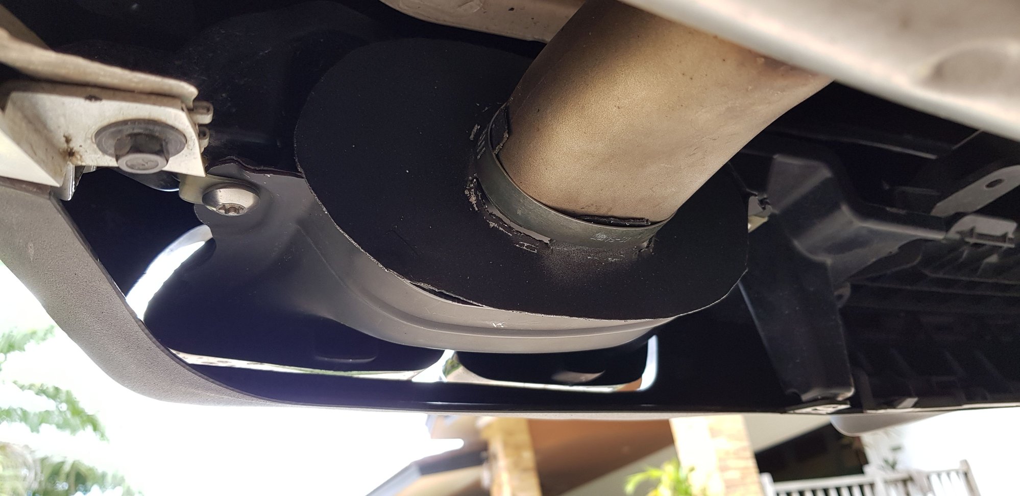

Installed image from underneath. Because its attached to the exhaust, it can move if and when the exhaust does without effecting the tips. It sits about 2mm off the steel exhaust tip as i was worried about squeaking.

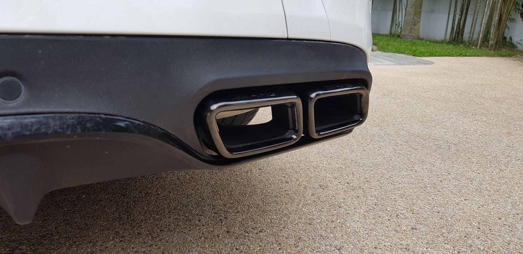

left after install
right after install
finished look. Heat on the tips is more or less the same as before the mod. Driven around for a couple of hours with no sign of a heat issue.
