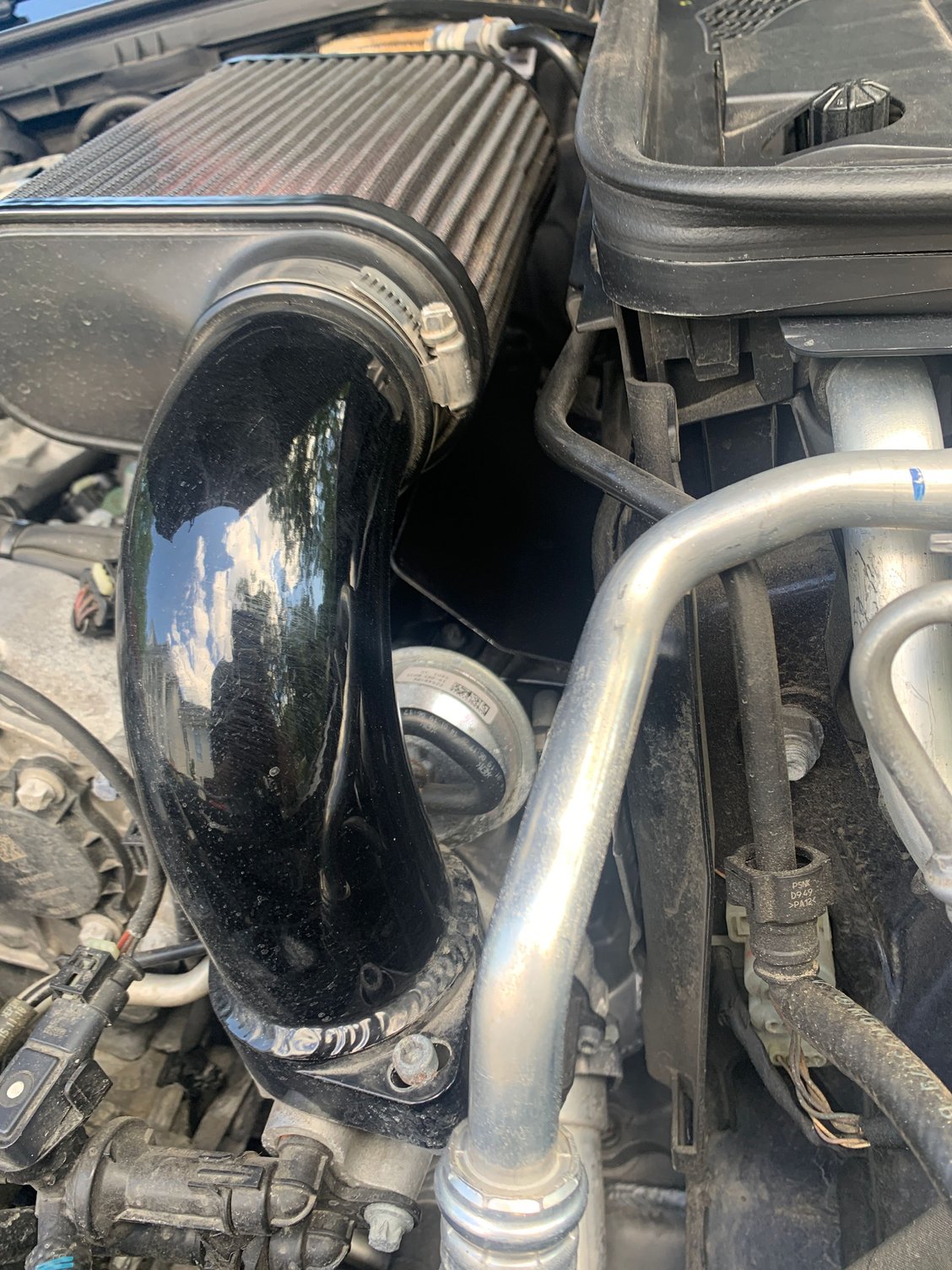

I went with the MHT.
After further review it looks like BMS's problem is the removal of those plastic intake tubes. The MHT "set up" makes use of this plastic piping to focus airflow directly on the intake filter. BMS probably has to work harder to pull in the air because these pipes are removed during install.
I think you meant it the other way around, that the MST has to work harder to pull in the air from the pipes.

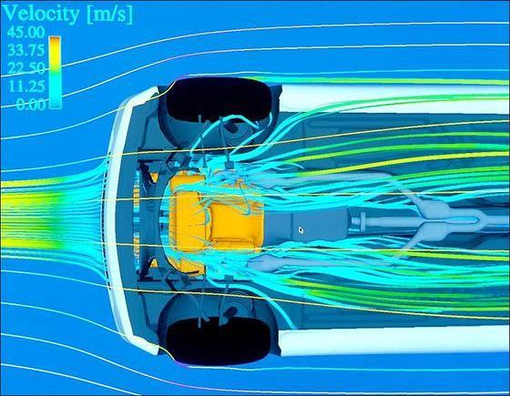

Originally Posted by gpouliniii
You went with the MST? I think the way it’s made makes for cooler air than the BMS. The BMS is sucking air straight from the motor. The “ram air” is no longer doing anything once it’s installed.
The way that the BMS is designed is so that cold air enters through the same front apertures at speed and creates a high pressure area at the top and rear area of the engine where the air filters are located, creating a denser charge.
At high speed the BMS would be superior in my opinion. However, at idle and in stop and go traffic, the MST provides a path for cooler air to be supplied to the air filters, although it is arguable if it even pulls the air through that path even though it is there because it is not sealed. Air will come in from paths of least resistance and that means surrounding air and not from those tubes when the car is not moving.
The MST retains the sound cancelling design of the original intake so it is quieter than the BMS. The BMS has enlarged intake tubes so you will get better flow than the MST, but much more noise.
Both systems are flawed, so it depends what you are using it for, and whether you can take advantage of their good points and if you can accept their bad points.
The true compromise all around is the stock air filter setup with drop-in filters, especially when you can’t tolerate the sound of the upgrades. That’s what I ended up using, having tried both the MST and BMS.

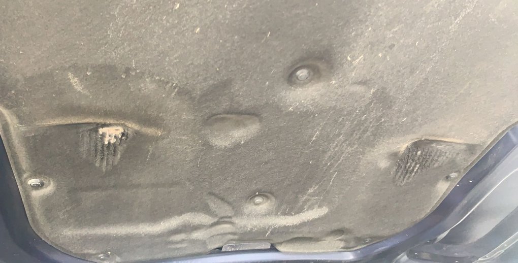

I have a facelift 19 and the bms intakes are designed so poorly that they suck the bonnet material from the top of the hood and they heat soak, I reached out to payam w a concern but they just didn’t care as the cash for the intakes was despoited into their accounts when I got the intakes now I regret them, they literally suck on the mesh of the top of the hood i even sent the pic to payam and he’s just delusional about his teams design as it clearly doesn’t work for my car and think that stock air box was good cause think about it amg tested this car over a 100 times, you can’t outsmartthe engineers that carefully made the car I think getting a intercooler upgrade is a smarter decision then spending 400-500 usd on these junky intakes from both companies that make your car sound like a toilet and the bms filters lol PS EVEN EUROCHARGED CANADA who are leading the c43 tune R/D said that the air intakes from bms are basically useless cant wait till a proper company makes proper air intakes for this beautiful yet growing platform , love jb4 HATEEE THE INTAKES GOD PLEASE KEEP STOCK
Heheh, yeah, that’s why I run stock air boxes with drop-in filters. The best compromise for me.
Good Intel, and I agree for the most part. I think between the 2 options MST is closer to stock. It keeps most of the OEM "plumbing" and simply removes the air box and replaces it with a "short ram" intake solution

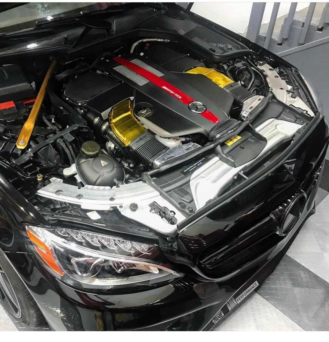

STOCK INTAKES FTW
The intakes only work when the car is running so stock airbox actually supports the flow of the air towards the car whereas the other intakes don’t help the colder air flow to the intake
Y’all can make y’all stock intakes Like this works better then bms or mst
Looks like you could still do that with an MST.
What's the name of that thermal foil stuff again? Got a link?

It’s just reflection gold heat tape lol it helps w warm temps but I wouldn’t reccomend mst be to Frank if you love your car stop experimenting w half assed designed intakes I’ve had my car for about 60k kilometres on a facelift c43 I’ve tried/tested about most of the things out there for this car and the intake market/support for this platform is *** atm but Ik some reputable brands working at the moment to make some nice intakes THAT ACC WORK just be patient guys it’s the greatest gift you have in life, I went from feeling hopeless about this platform to seeing the growth and things actually move forward again give it time and patience and watch beautiful things flourish for this platform

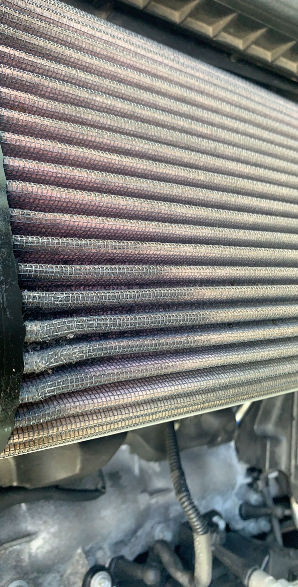

I’ve readjusted the intakes a million times to no avail they are just designed so poorly if you want a intake that sucks the mesh on the bonnet have fun 😂😂 I gave up and stopped using them
As you can see it presses agaisnt the mesh HOPE YOU SEE THIS PAYAM OR WHOEVER FROM THE BMS TEAM make a version 3 fix your mistakes and make the intakes a tad smaller yeah maybe then I might think about it.... sike I lied y’all had my trust till I saw what garbage support y’all have for your customers
The BMS intake offers the largest filters by far and is the only one that addresses the actual restriction in the intake path. In terms of the top of your filters touching the hood insulation we had a few reports of that with V1 and lowered the filters around 1/2", not had any reports of it since unless filters are tightened down in a tilted orientation when installed. There is so much filter surface area even if you tapped up half of each filter it wouldn't matter as far as performance goes.
I'm not surprised a tune competitor would say our intakes are bad, lol.
