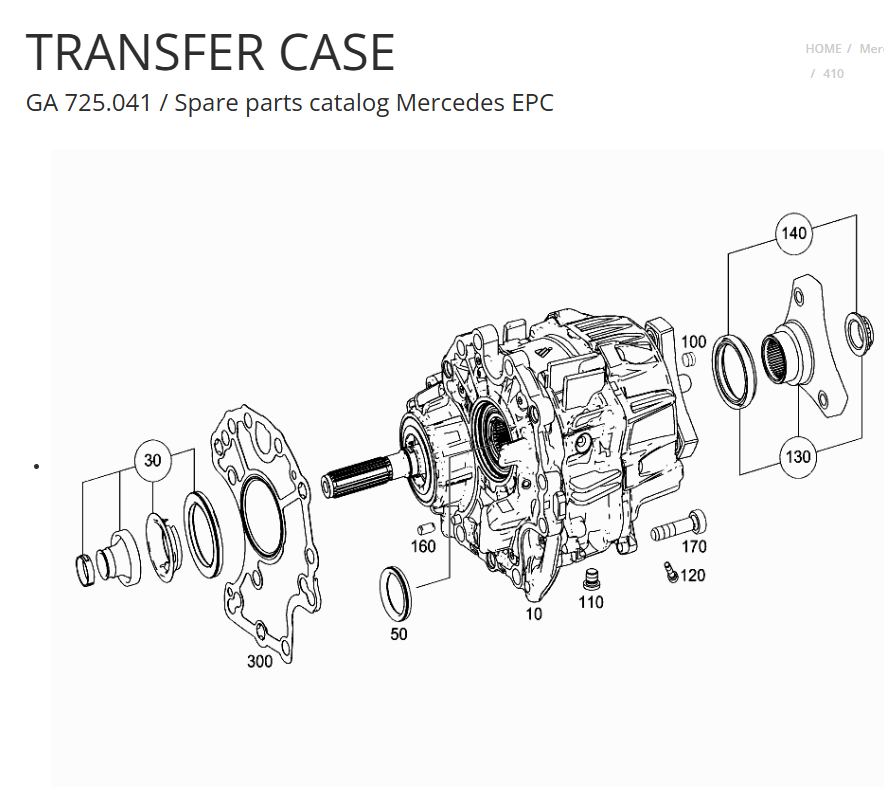

The 725 transfer case is separate and does not share fluid with the transmission. When viewing the transmission it does look similar to the 722.9 on the outside on some, the ones on suvs like the GL look different.
https://mbworld.org/forums/attachmen...819d1681766939
Thanks Tim! Great visuals!

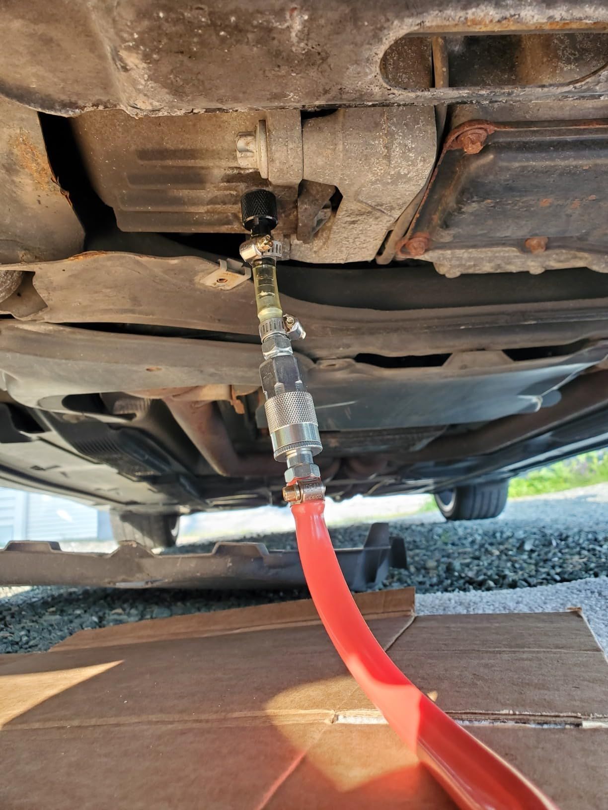

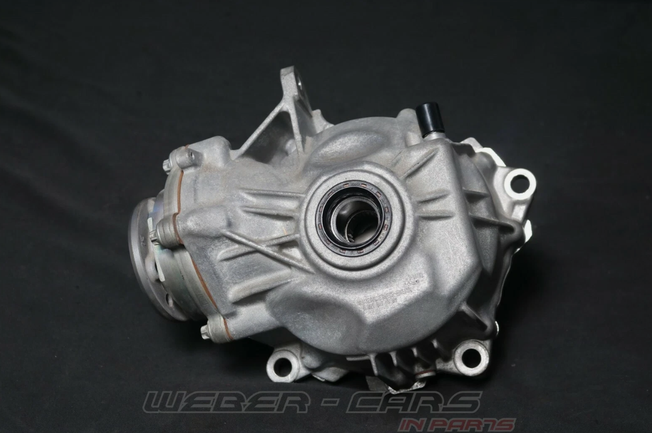

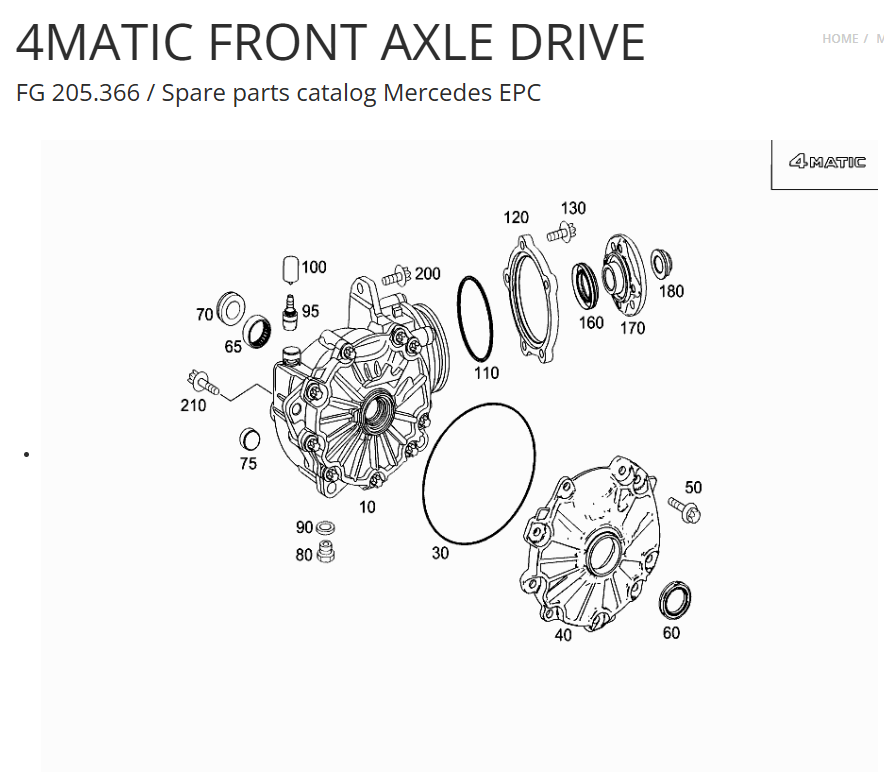

one question, is it nescessary to loosen up the steering rack first before performing ront differential oil change?
Old Oct 22, 2025 | 05:57 PM
TimC300's Avatar
Joined: Aug 2023
Posts: 3,701
Likes: 1,114
From: MA Coast
I cant imagine needing to touch the steering rack to get at the front diff. I looked up the parts diagrams for W204 C43 and see 4 different #'s for the diff so not sure which one you have. Looks like one has a fill plug on the side which is great then the other just has the drain plug on the bottom.
On the differentials without a side fill plug MB says to remove the passenger axle in order to add fluid which is alot of work. When I did my W204 I just pumped in the new fluid from the drain hole. I measured the amount of fluid that came out which matched with how much should be in there. Added that amount plus a tiny bit extra just to compensate for drips when re-installing the drain plug. Dont forget to use a new gasket part# 007603012102.
Can see the diagrams here: https://nemigaparts.com/cat_spares/epc/mercedes/1/205/
Heres how I did my W204 front diff:
