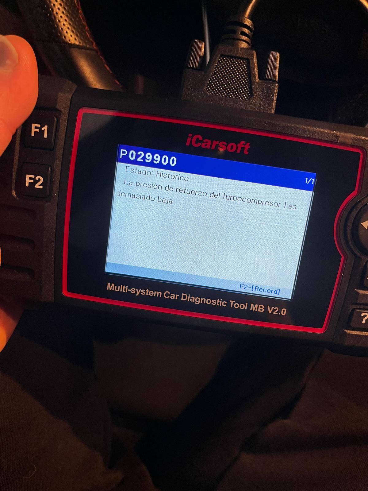

need to hear a recording of the sound and know what code is stored in the computer.
This is the error I get when I try to do a standing start. I turn the car off and on again, and then it runs fine. It’s been doing this for a while now, whereas before my times were around 4 seconds.

and that error I get when I try to launch
I'll look into changing that valve. It's quite cheap and I'll do it myself at home and see how it goes…
