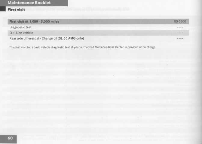

The SL65 is the only model that has the limited-slip standard, but the book makes it clear it gets a free diff oil change.
