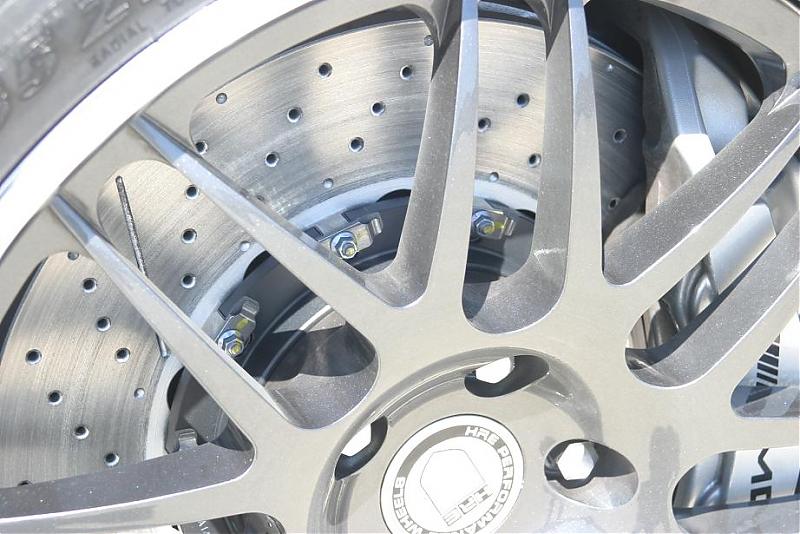

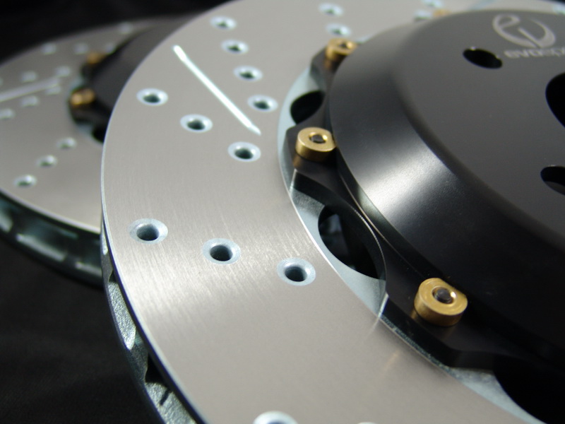

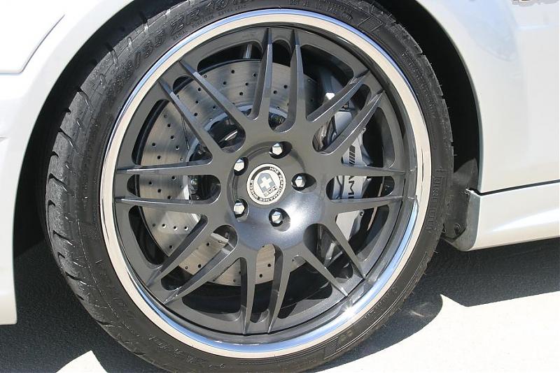

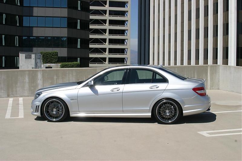

Installed my two piece rotors today. I saved 6 lbs. per corner. The factory one piece rotor weighs in at 36 lbs. and the new 2 piece weighes in at 30lbs. It's a pretty pricey upgrade, but taking off unsprung weight is always good.

Yes, that is what should have come on the PP. They are factory MBZ rotors and cost about $900 a piece, ouch.

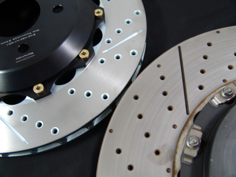

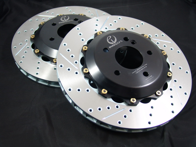

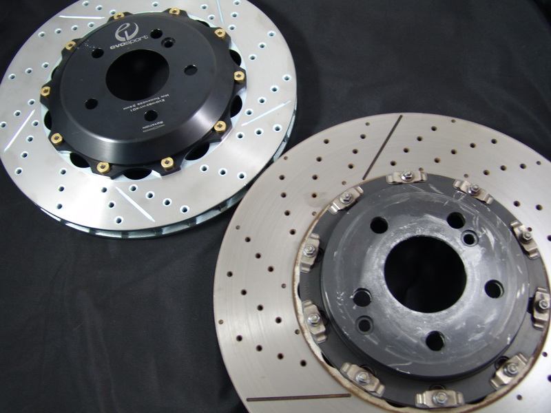

Apparently 2-piece rotors are not available yet even on PP cars. The 2-piece rotor is the same one that comes on the CLK63 Black Series, SL55 030, etc.
Here are pics of our 2-piece REAR rotors we just released for the CLK63 Black Series. We will be offering a 2-piece REAR rotor for the C63 as well. We are currently evaluating offering a 2-piece FRONT rotor for the CLK63/C63 which would be much cheaper and most likely lighter than even the factory 2-piece.

They are the same size as the one piece rotor, 360mmx36mm i believe.

Rims look great. I also have this rotors on my car with excelent result.

HRE 841's looks HAwt.
