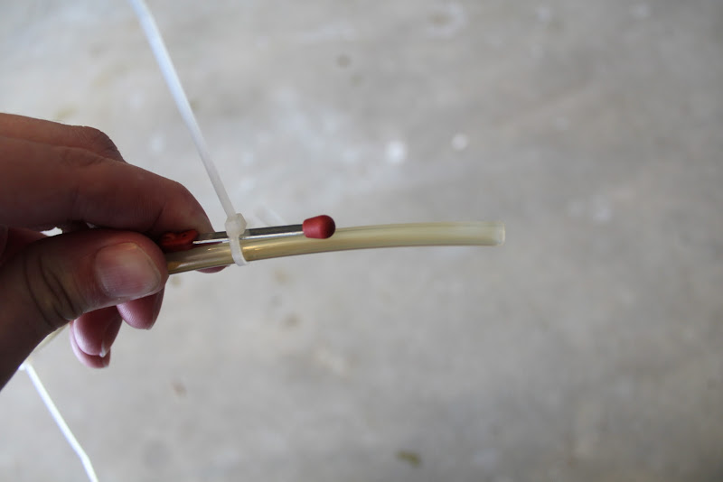

Quote: - I got the vac tube to go all the way down. I marked it with my hand and compared to the dipstick. They were the same length.
Ok, but the bottom of the dipstick is not touching the bottom of the pan.

Quote: Ok, but the bottom of the dipstick is not touching the bottom of the pan.
You are absolutely right. I just eye-balled/hand-marked it the first time to make sure they were similar lengths (I.e. not too short).
When I insert the vac line into the dipstick tube it certainly hits bottom.
I went back and measured again. I marked the vac line with a Sharpie, even with the top of the dipstick tube when fully inserted. Then I measured that portion of the vac line against the dipstick. The vac line goes in 1.5" deeper. I edited my previous comment. Thanks for pointing this out.
Here some quick pics. The vac line is pretty firm/coiled so I had to tie it to the dipstick so you could see the length/depth comparison.
