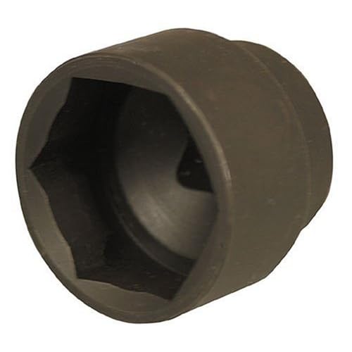

I found a great socket for the oil filter cap. I just test fitted it today and it fits like a glove!
It is 32mm and works with any 3/8 wrench. Only $6.99.
http://www.amazon.com/Lisle-14700-Fi.../dp/B0009OMYAQ
Good find. Now I need to find a few more items to hit $25 and get free shipping.
The filter socket is a must have, I bought one like 15 years ago from a German company called Hazet. Real handy thing to have.
