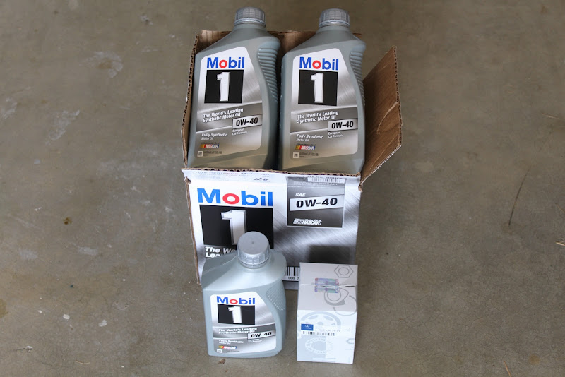

Originally Posted by superlubricity
After 2,500 miles and a ton of time on the dyno I knew it was time to give the car some fresh oil.
My shopping list:
  1. a Mityvac from Amazon.com
  2. an OEM filter (P/N 0001803009) from the local Benz dealership (Came with new O-ring)
  3. 9-quarts of 0W-40 Mobile 1 Synthetic from the local Auto Parts store
Stuff I already had in the garage:
  1. a big crescent wrench for the oil filter cap
  2. a small slotted screwdriver for taking off the O-ring from the filter cap
  3. some rags
  4. a small oil funnel
The procedure using the Mityvac was very simple:
  1. Just warm the car up. (I waited until oil temp hit 175-degrees F.)
  2. Shut off car.
  3. Remove the dipstick and fill cap.
  4. Insert suction line into the dipstick tube until you hit bottom.
  5. Attach the line to the Mityvac.
  6. Give it 10-full pumps and it starts to evacuate the oil.
  7. Towards the end I gave it a bunch of additional pumps every few minutes to get the last drops of oil out.
That's it. All the old oil was out. Pretty simple stuff and I didn't have to get under the car and I didn't make a mess.
Swapping the oil filter was also a snap. I used a crescent wrench to take off the cap. A 32mm socket would have been better and it will also allow you to use a torque wrench so you don't over-tighten. When you replace the filter element be sure to use a new O-ring. It should have been included with your filter.
I filled the engine with fresh oil. Took it for a spin around the block. Checked the oil level and it was just under the top red marker on the stick. Perfecto!
Photos below:
The Mityvac MV7201
Oil and filter
Filter box w/ part number
Close-up of filter
New and old filter
New filter snaps into the cap
Filter and fill caps removed
Mityvac line in the dipstick tube
Connected to the Mityvac
Here comes the oil!
Almost filled up
Hope this was helpful!
