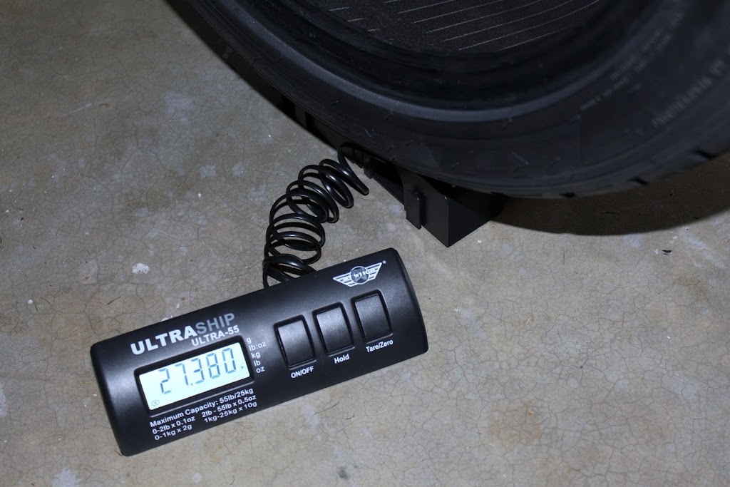

Nitto NT05 Tires (245/40-18, 275/35-18)
After reading many positive reviews online I pulled the trigger on the NT05. I wanted a street tire that could double-duty at the local road course. I don't have enough seat time with them to give a formal review but you know I threw them on the scale. Like most reinforced tires designed for extreme performance, they are a bit heavy. I actually gained some weight going with wider/stiffer tires.
Specs:
245/40-18 = 25.59" Diameter, 9.65" Width
2
75/35-18 = 25.63" Diameter, 10.79" Width
Weight:
2
45/40-18 = 25.09 lbs.
275/35-18 = 27.38 lbs.

Nitto NT05 275/35-18
