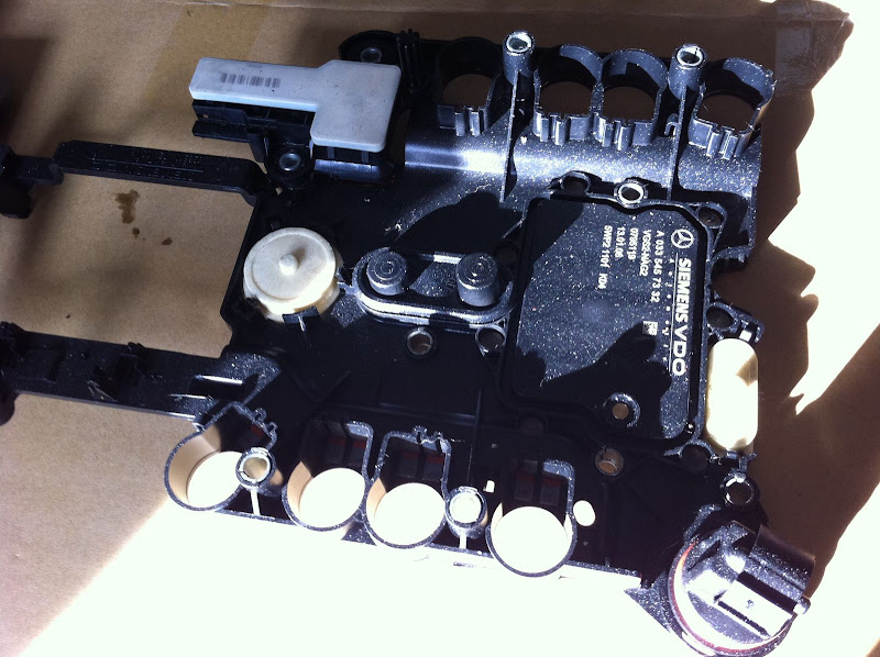

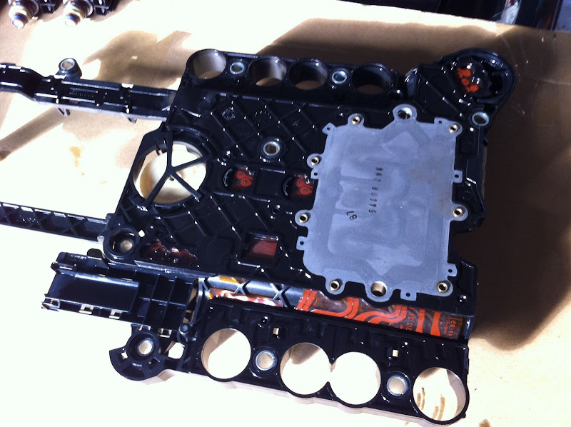

"Getting the TCU is the problem guys. It's buried in the transmission and epoxied in place. You literally have to crack the transmission case and tear it apart JUST to get to it."
This is not true. The control unit is on top of the valve body. It can not be opened though. There really is no opening it and having it work again.
Also some one earlier was talking about line pressure. The transmission does not have any pressure sensors. The values are calculated. It would not have any idea that you raise the pressure. Other than adaptations for the targeted shift values. The question is what will happen when the values reach limits. On the earlier transmission the tcu does not send any faults unless there is slipping or gear implausibility. I have not seen anything to indicate otherwise in this transmission. I raised the shift solenoid pressures the other day a little and saw adaptations change to counter. I am going to raise modulator pressure next week to see what happens. It will just be a matter of trial and error. The shift solenoid pressure should only effect the speed at which the shift valves move over to begin a shift. The modulator pressure is the fill pressure on the clutches. Higher pressure should speed up the shifts and make them firmer. It is just a matter of what ill effects there are from doing this.
