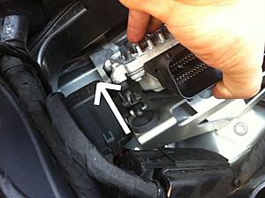

Now there are only 3 clips holding it in place that are here:
Pop the clips (the middle one pulls up). then pull the entire plastic cover straight up towards the sky.
Then, you see the ECU:

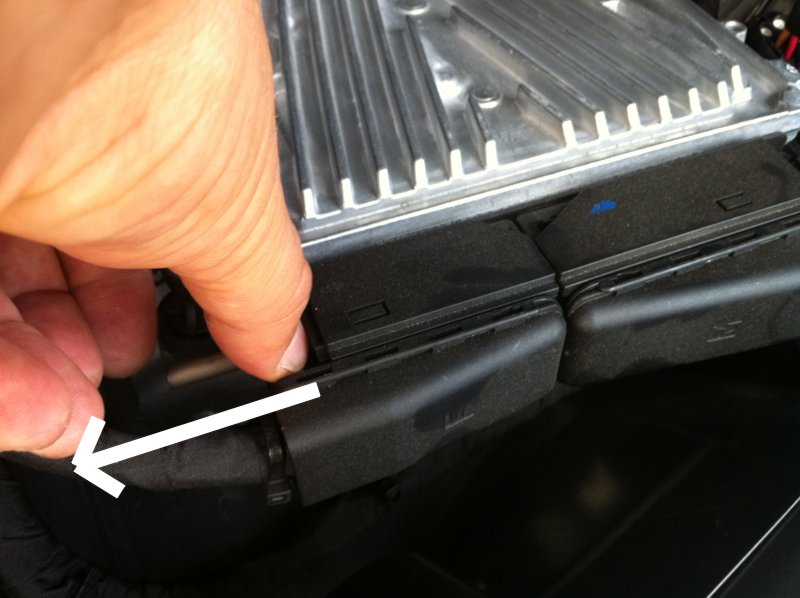

Then you need to pull out the 2 connectors. On the outside of eahc of these connectors is a big sideways T shaped PULL TAB. Just pull it out gently about 1-2 inches) and this will safely unlock AND pull out the connector:
Once this is done, all you need to do is pull out the ECU. It is not held in place by screws but rather slipped into 4 rubber mounts (1 on each corner):
So basically, you just pull the ECU straight out (gently) and VOILÀ !
