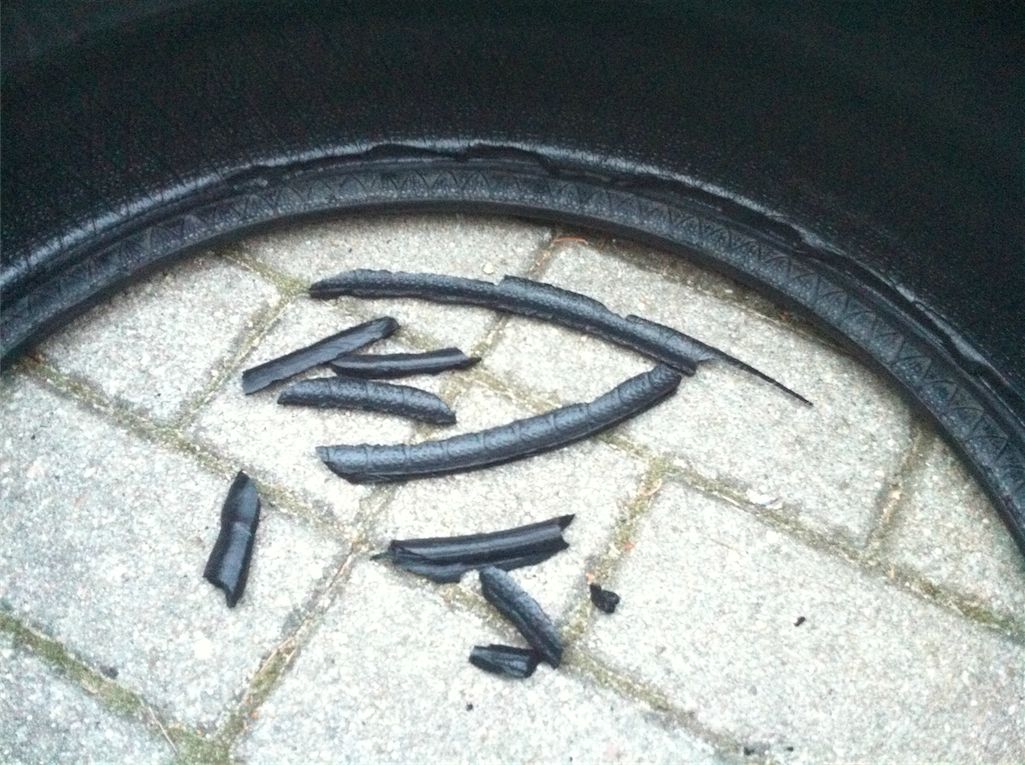

Thanks for the help guys.
I found out what the problem was but it took me the whole day.
After checking the suspension I checked the wheels. They were well balanced except for one wheel.
We could here something was inside the tire... After the tire was taken of the rim, this is what we saw. The whole runflat enforcement of the tire was ripped off and was flying inside of the wheel. The tires were new (prod. 2011) so I hope I can replace them under warranty.
Luckily it didn't blow up on the highway yesterday night while I was having fun with the RaceLogic.

Runflat tires are the worst.
They wore so badly on my stock sport suspension 335i.
Take all of them off and replace them with non runflat tires.

Wow, that could've been disastrous! Good job hunting it down.

Matt it does sound like you should dump the run-flats if you can and get regular tires.
What a pain in the a$$ and good work getting it figured out.

I needed tires that run narrower than P-Zeros and Yokohamas so I chose the Dunlops Sportmaxx GT.
I didn't even know they were runflats
Never thought this would be a downside to them.
I can only fit narrow tires in the size 245/30/19 with this drop and these wheels.
Any suggestions?

Any chance you can squeeze a 245/35/19 in there. Then you would have a much better selection?
