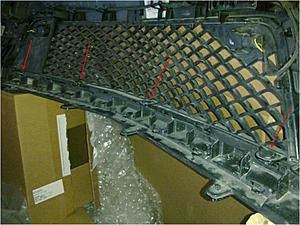

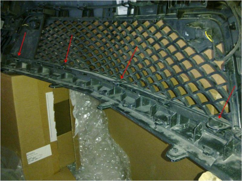

This is what you are looking at removing on the inside (red arrows) to get the front lip out. There are some kind of push pins like in the wheels well.
Even with the skid plate removed and the car on jack stands I'm not sure there will be enough space for you to work between the radiator/oil cooler etc...
