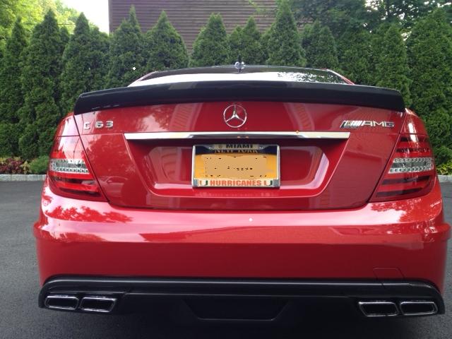

I had my Mode Carbon Spoiler installed professionally over the week-end on my 2012 C63 BS.
The fit was perfect and the overall quality of the boot lid spoiler is top notch. The Carbon design even matches the direction and pattern of the OEM carbon diffuser. The installer refused to use fish line or the like, as he position is it can and often damages the paint. He only uses a heat gun and then a wheel to remove the excess adhesive. On the BS the OEM carbon spoiler was held down with two layers of 3M tape..One on the spoiler and one on the trunk. An hour job in total.. The new spoiler really looks kool. pics to follow.
