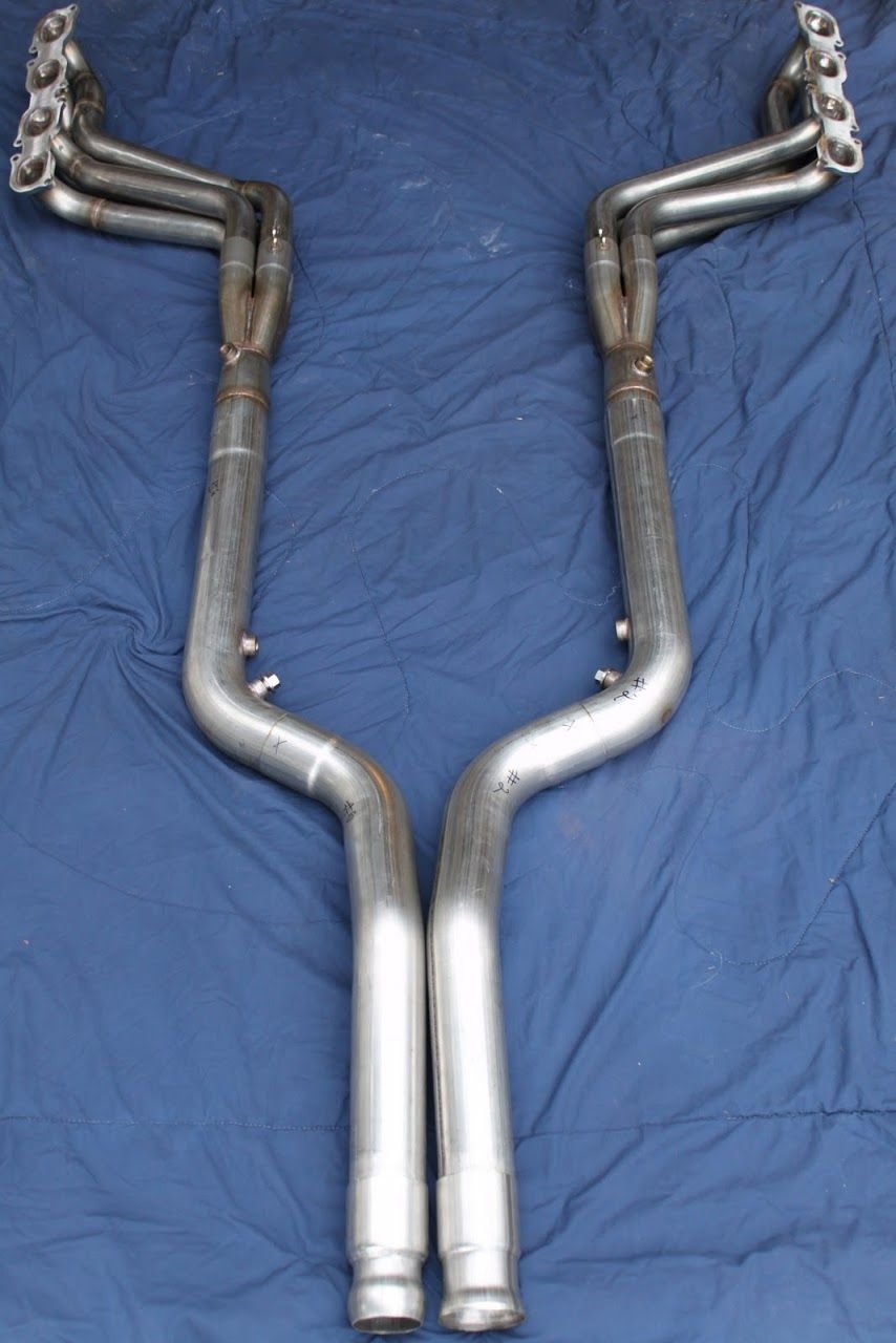

is the first picture you added from your own system? This is the first such picture I see that shows all 4 O2 sensor points, as well as cats. If so, which supplier is this from?

No not mine. Actually this one is a E63 set up very similar to the C63.
These LTH are American Racing Header (ARH). For the C63 they are sold under the MHP brand. The second picture are MBH headers if I'm not wrong. And you do see the pre and post O2 points. In this set up post-O2 points are not used.
Most true LTH will always have the 2 pre-O2 points. Then depending on the midpipe you choose you'll have cats or not with the 2 post-O2 points.
