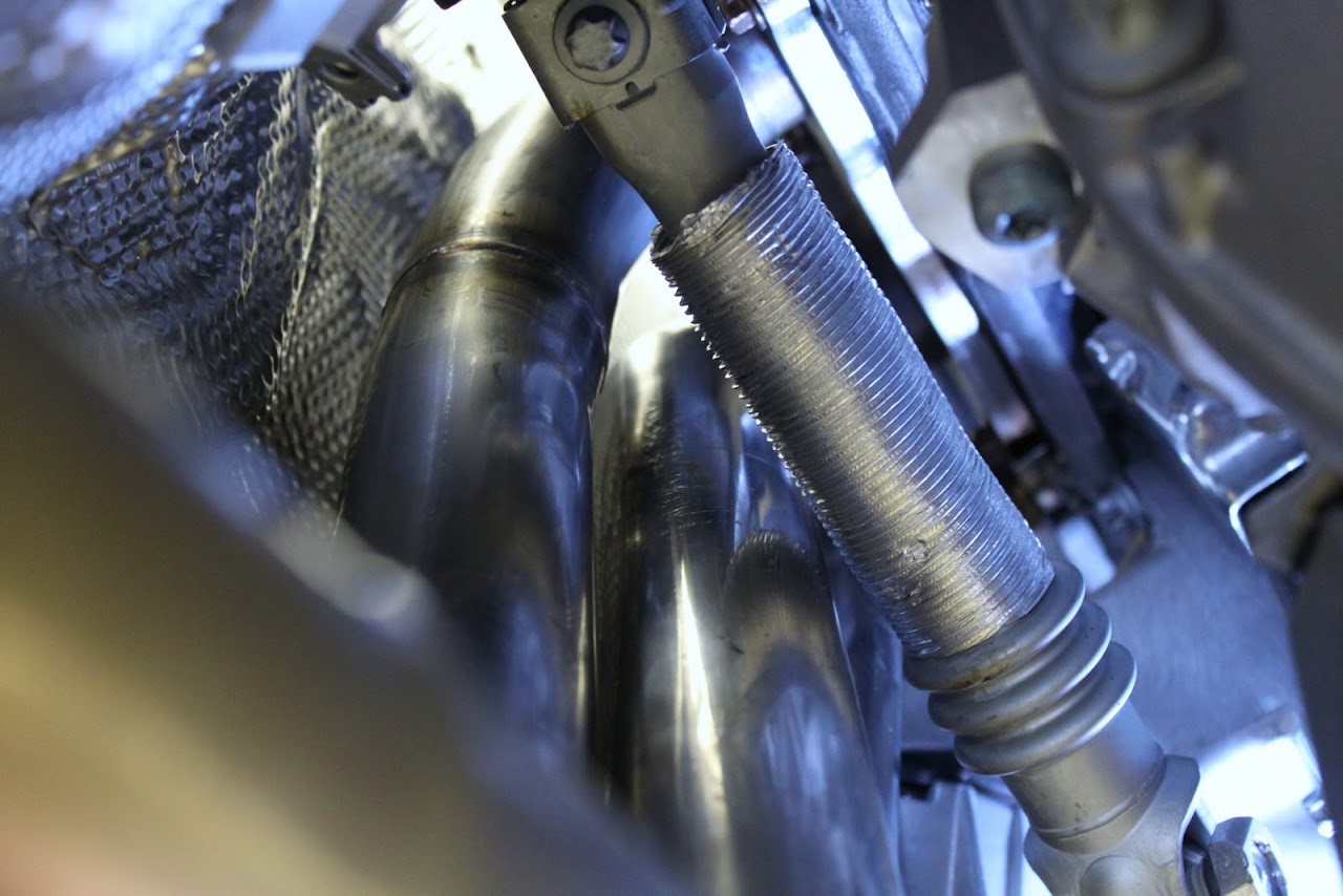

After independently testing PLM Exhaust Manifolds, the GT PRO Single X-Pipe and my own 2.5" catless bolt-in down/midpipes on the dyno and at the dragstrip, I've moved on to Long-tube Headers.
I sent my ECU off to Cory @ Kleemann to update the file to the same K2 version avengerboater is using with his MHP long-tubes. Got it back in 24-hours. Thanks, Cory!
Install was done by Sound German Automotive in Bellevue, WA this morning. The process was straightforward and took about 6-hours. Thank you, SGA!

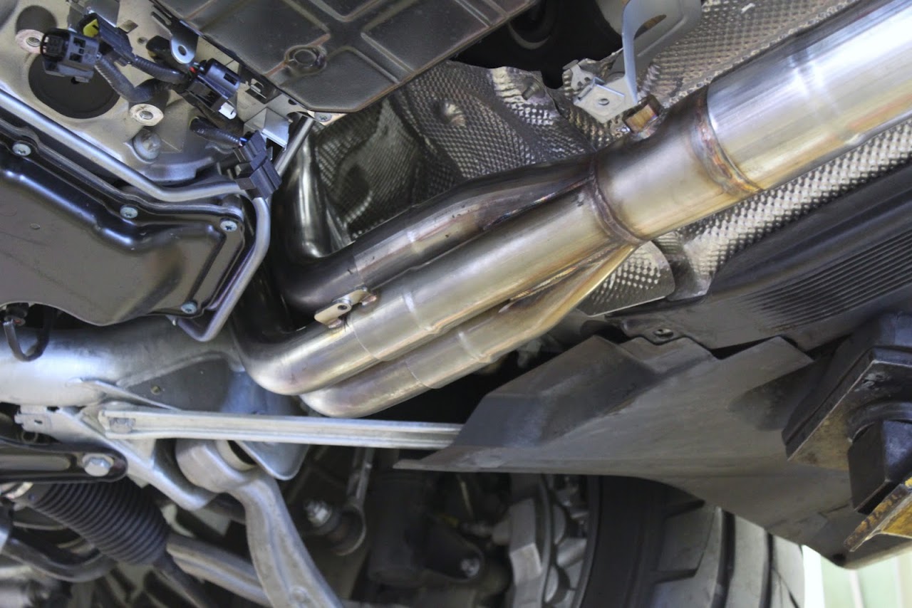

The only issue we ran into was unexpectedly having to trim back a very slim portion (no more than a 1/4 of an inch) from the drivers side plastic under tray. Slightly annoying not knowing about this potential issue. Apparently it can and has happened to "some C63s". No big deal in the end.

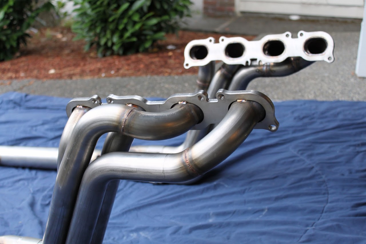

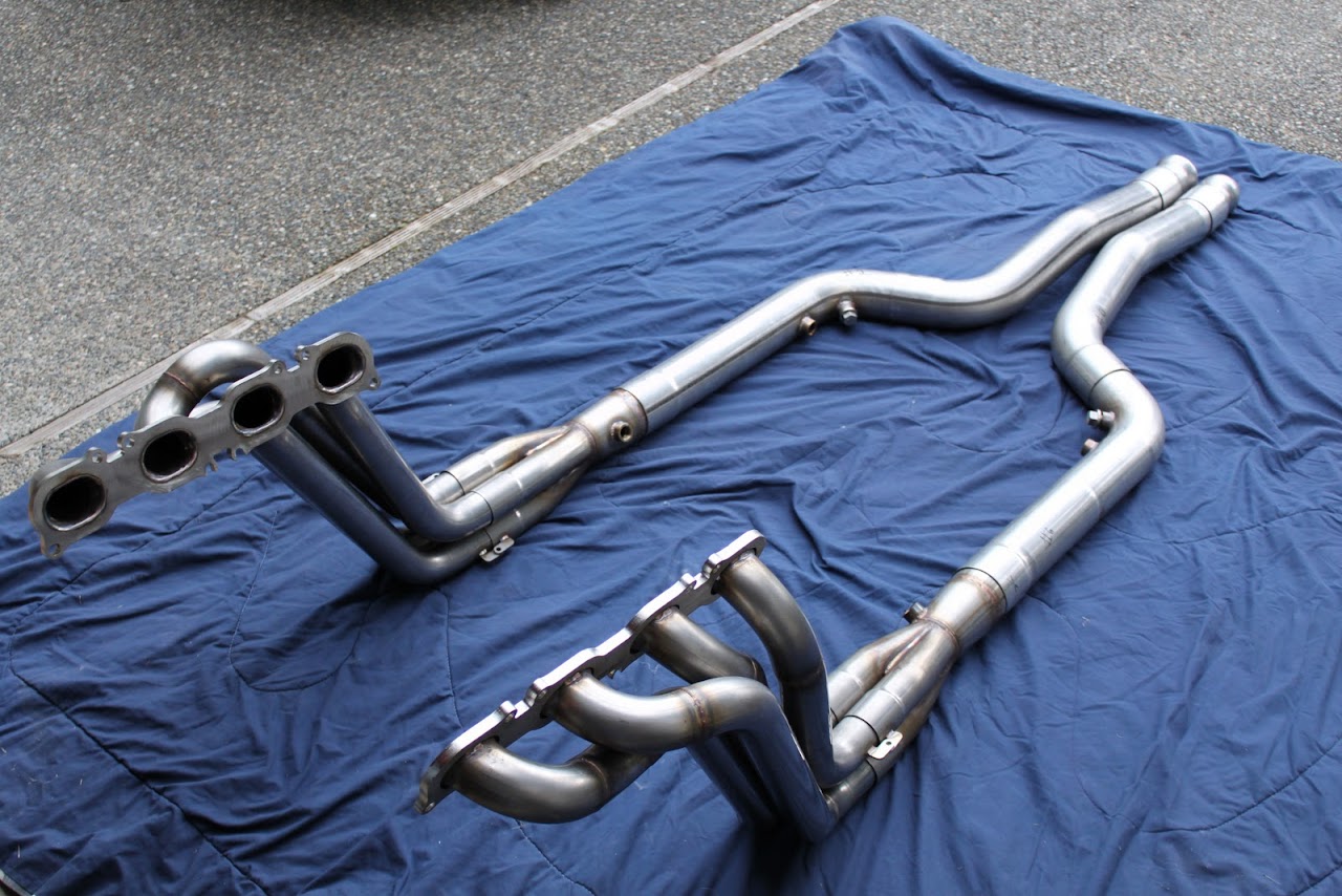

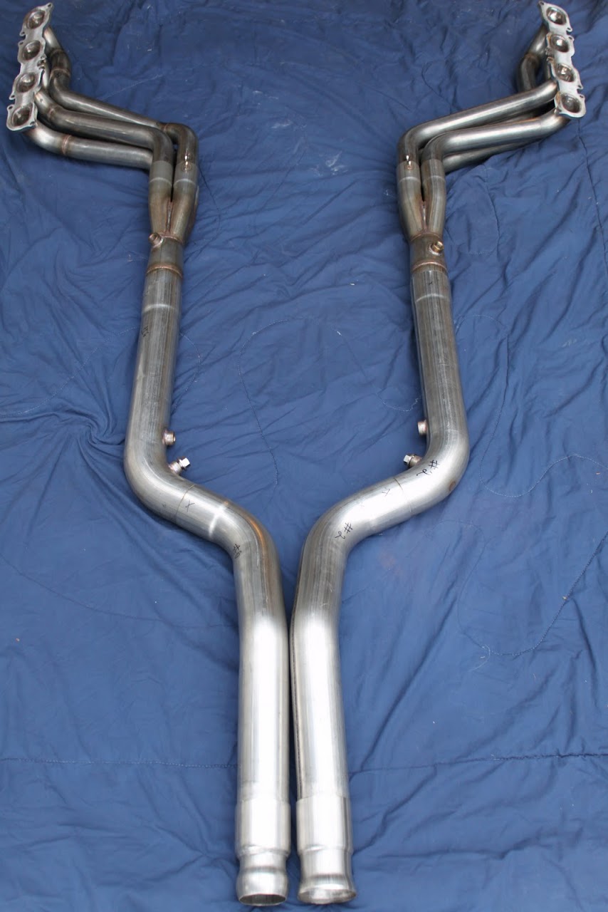

The 1 7/8" 4-into-1 Long-tube headers:

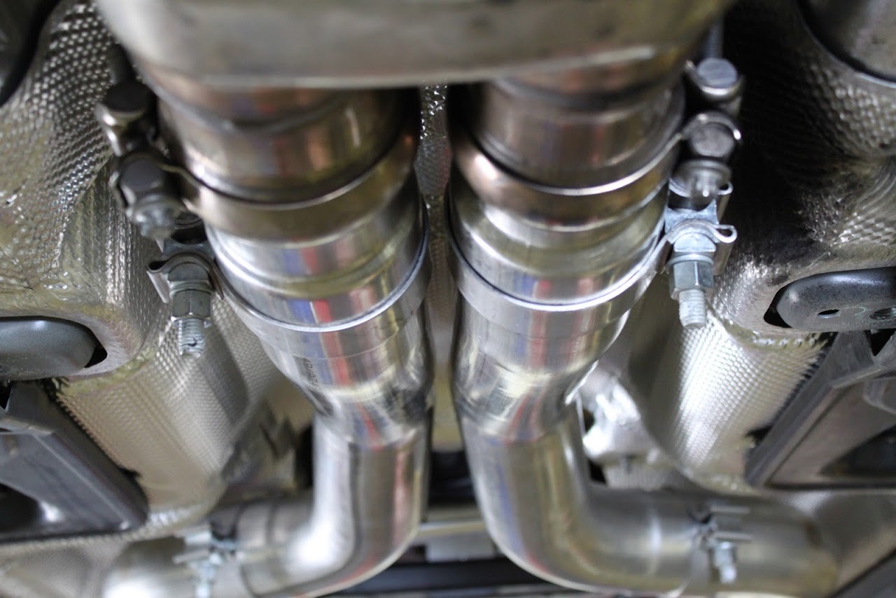

The complete system w/ 3" mid-pipes:

Installed:
The high-velocity merge collectors:

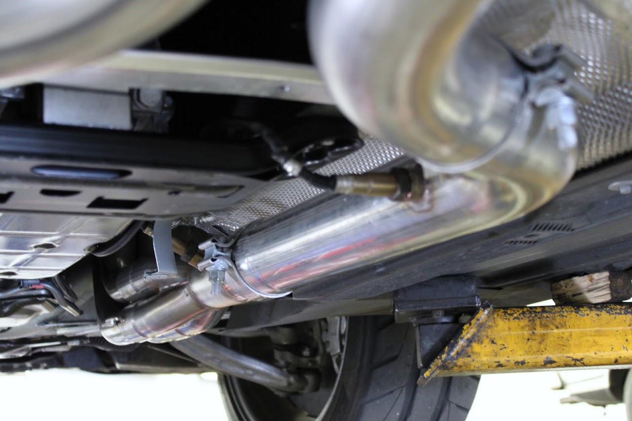

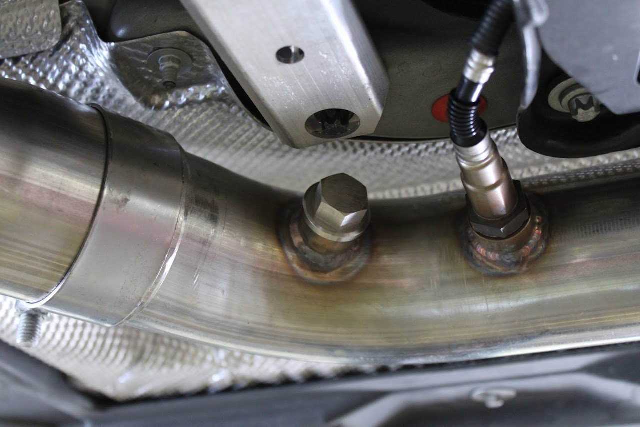

Extra O2 bungs pre-installed on the mid-pipes for optional wide-band monitoring:

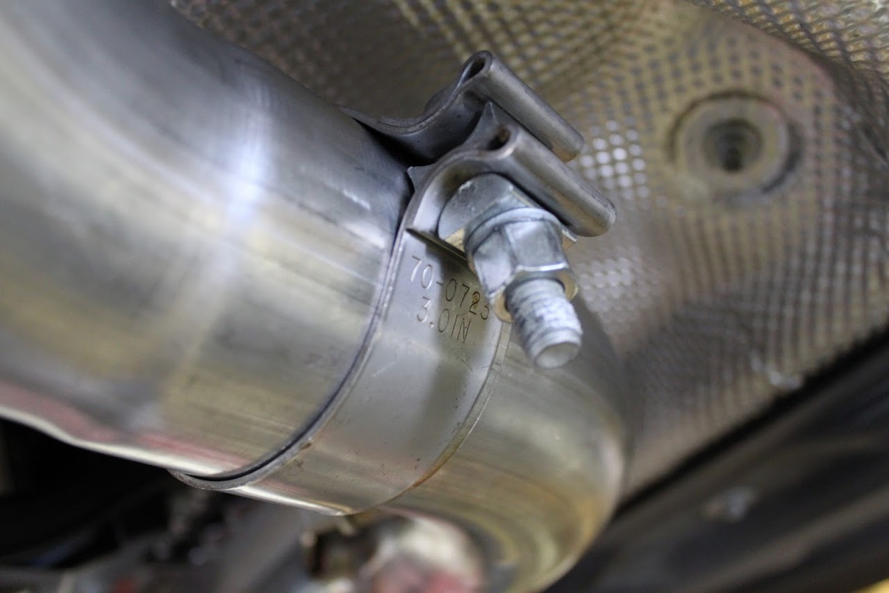

Close-up of the clamps used in the system:
Close-up of the steering shaft clearance:

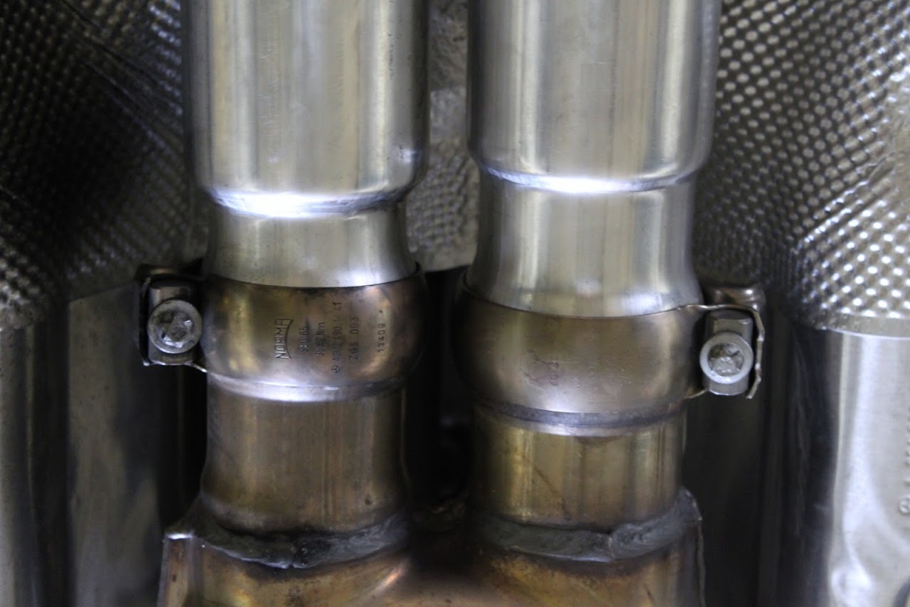

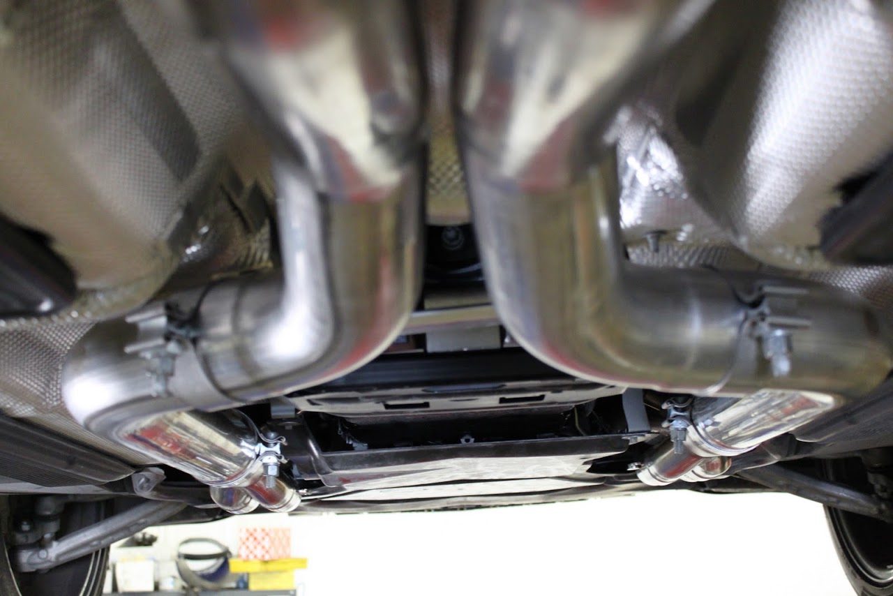

How it bolts to the factory resonator:
Shot showing the ground clearance:
