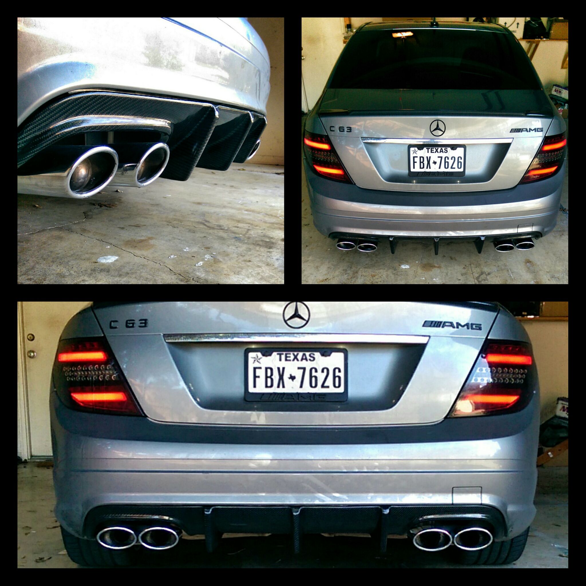

get the ones off of e-bay from either depo or ipexmotoring, they're plug and play with no need for SAM reprogramming. i ordered the latter, installed myself and haven't had any issues.
here's an older picture of my car for reference:
