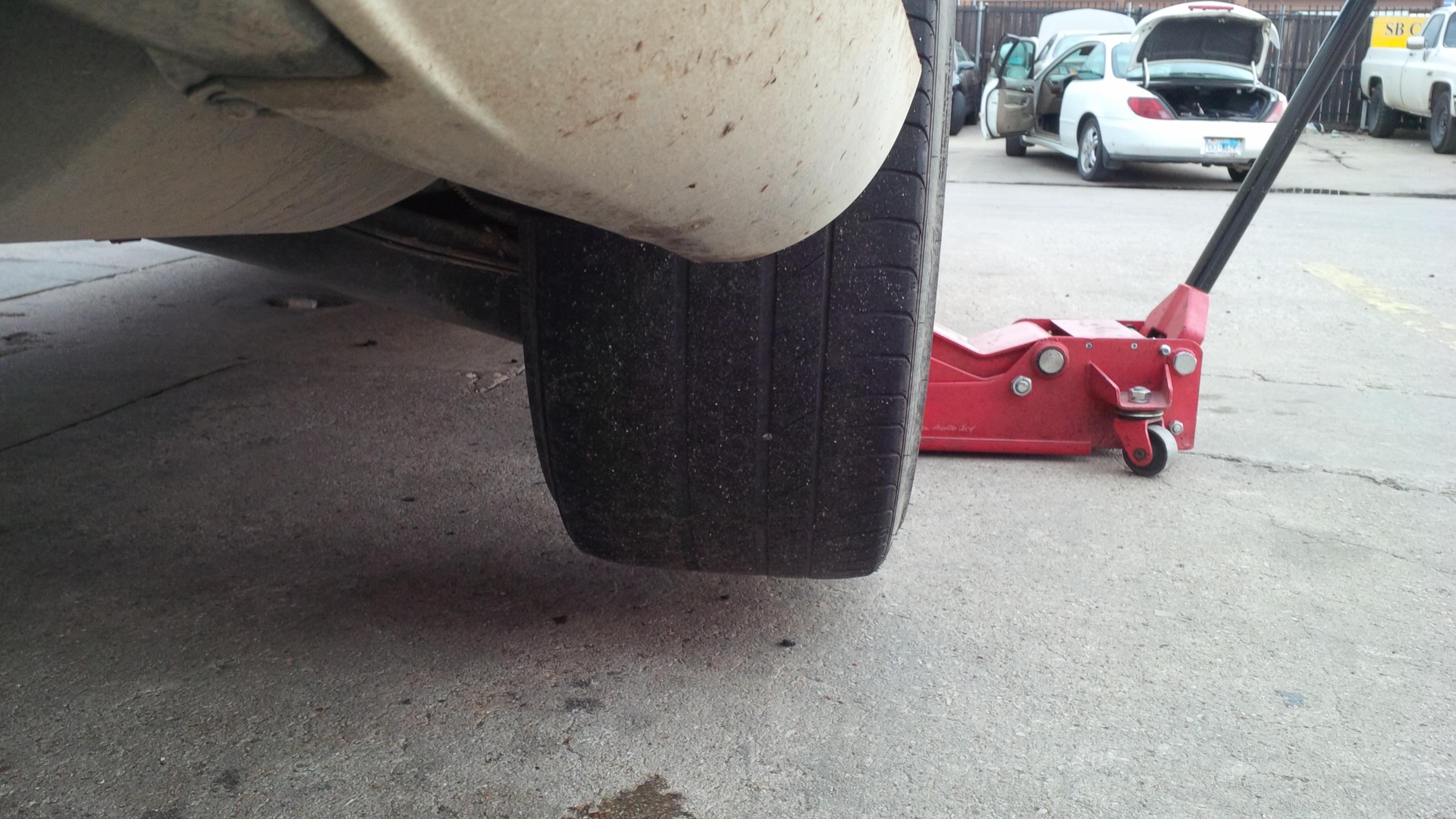

Normally, I would have replaced my tires long before they got this bad but it caught me by surprise since I've only been on them for 7551 miles.

Do you have a lsd installed in your car? I ask because you have more wear on one side.
Other than that, the wear is normal. You have to remember that you also have long tube headers installed in your car.

I'd say they look absolutely normal with a modestly agressive alignment other than extremely over worn

C63 has too much rear toe which causes the rear tires to be scrubbing 24/7 wearing them down quicker.
I removed all but a small portion of the rear toe and my rear tires wear more consistent.

Anyone think that my alignment could have helped to the tire wear or was it just that these tires were just softer than my previous...

if you got 7500 out of the rears thats not bad, from what ive read around here most get 5k on michelins so i think your alignments probably fine.
