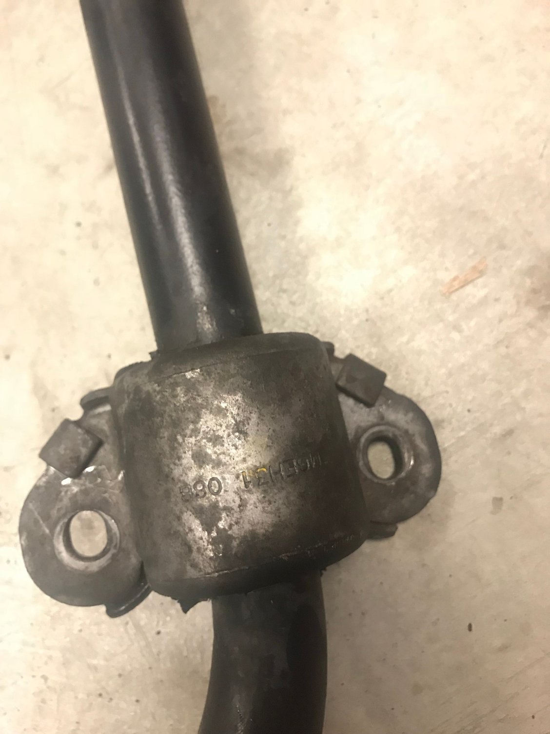

Help. I’m stuck. Getting that plate off was a pita and it supports the steering rack. With it supported I was able to get the bar out but my mounts don’t look like anything described. How the heck do these come off? Do I need to use a cutting whee to cut the tabs?? I’m stuck and this took way longer than I had counted on as there’s little room to get a wrench on the top nut.

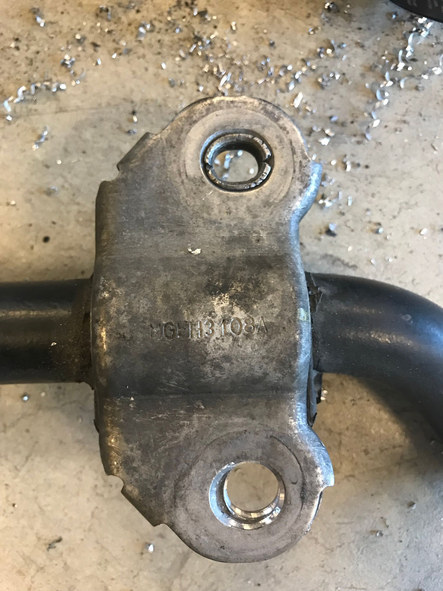

Ok so after tossing and turning all night stressed about the stupid $150 bar and whether I'd ever figure it out (was about to have my bro cut and weld the mounts back together), I kept thinking about the mention of needing to drill hollow rivets out, but when looking, I never saw any hollow rivets. But the ah-ha moment came after I spent more time studying it this morning and cleaned up the brackets. You see, each of the two holes on the bracket is itself the hollow rivet. After cleaning the one side, I was able to actually see what appeared to be the flange of the end of the rivet expanded. So, I set out to drill it and see if that would open it up and voila! A little prying and it came apart. So, all is not lost, though my Eibach bar doesn't have a provision for mounting the headlight leveler assembly, but that might get solved with zipties...
