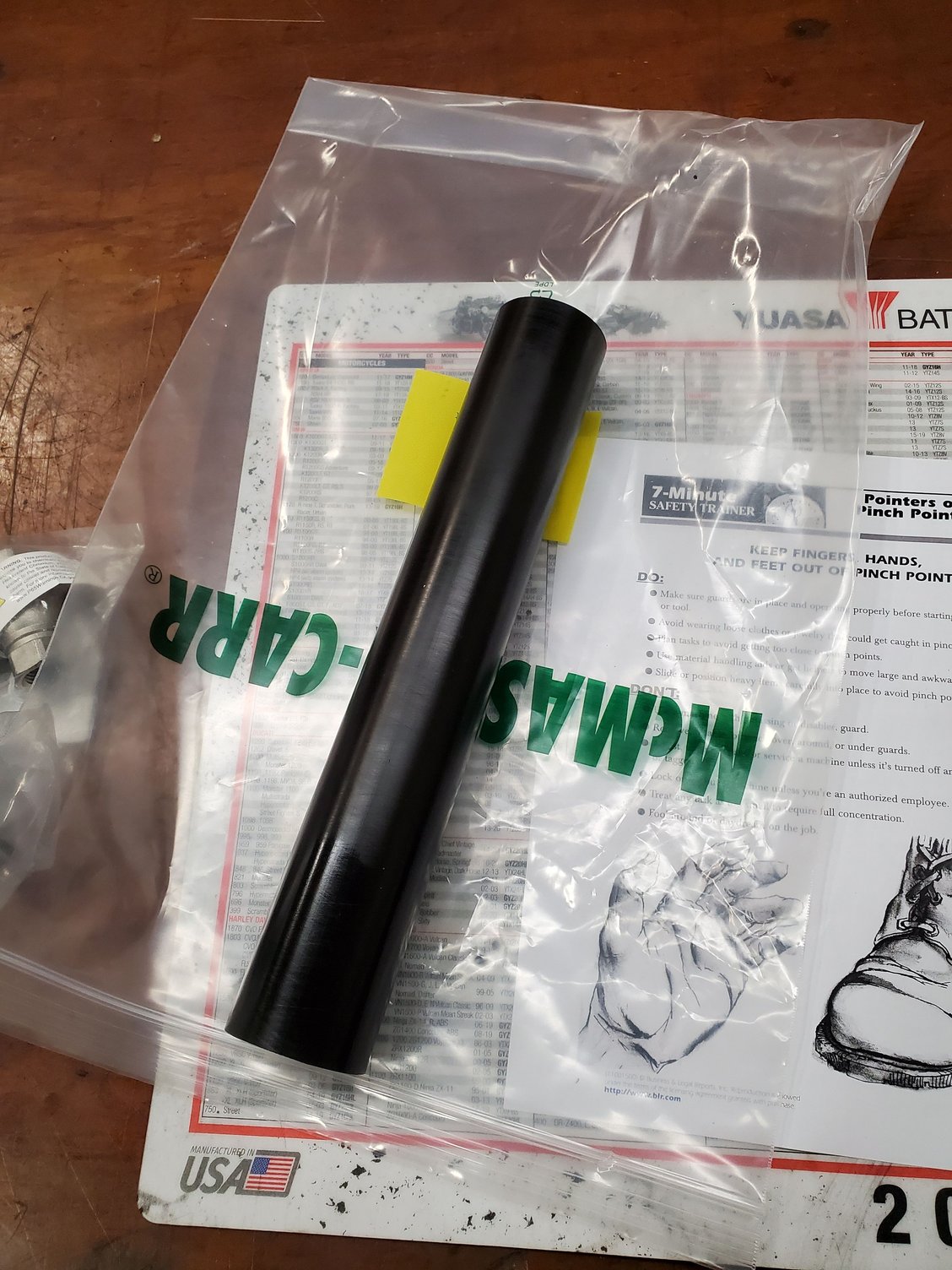

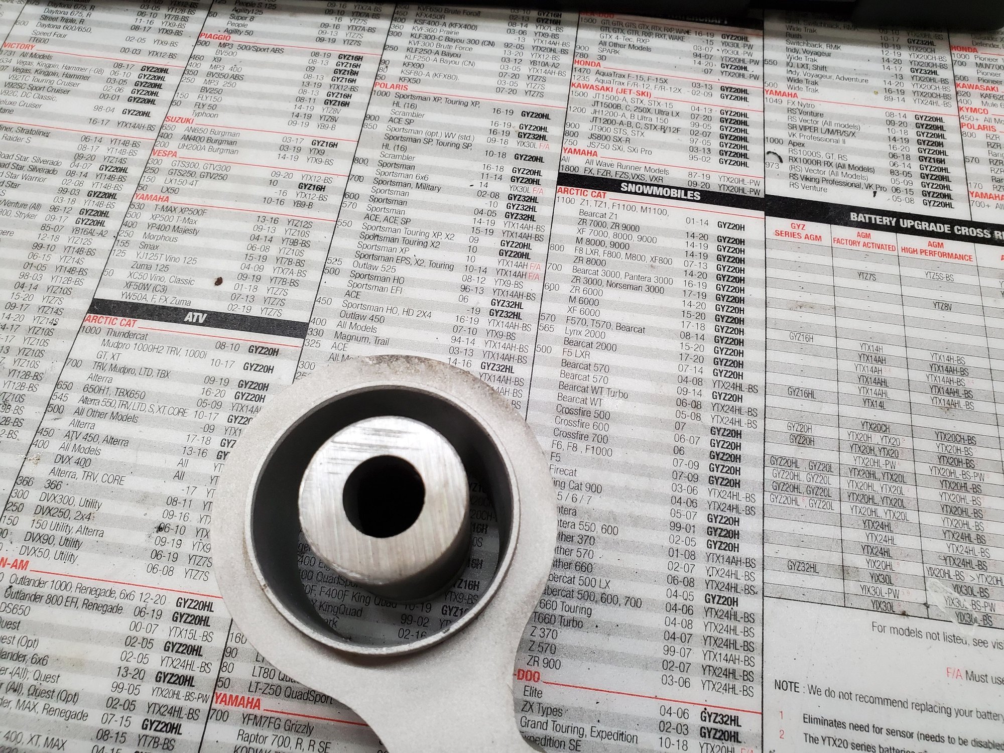

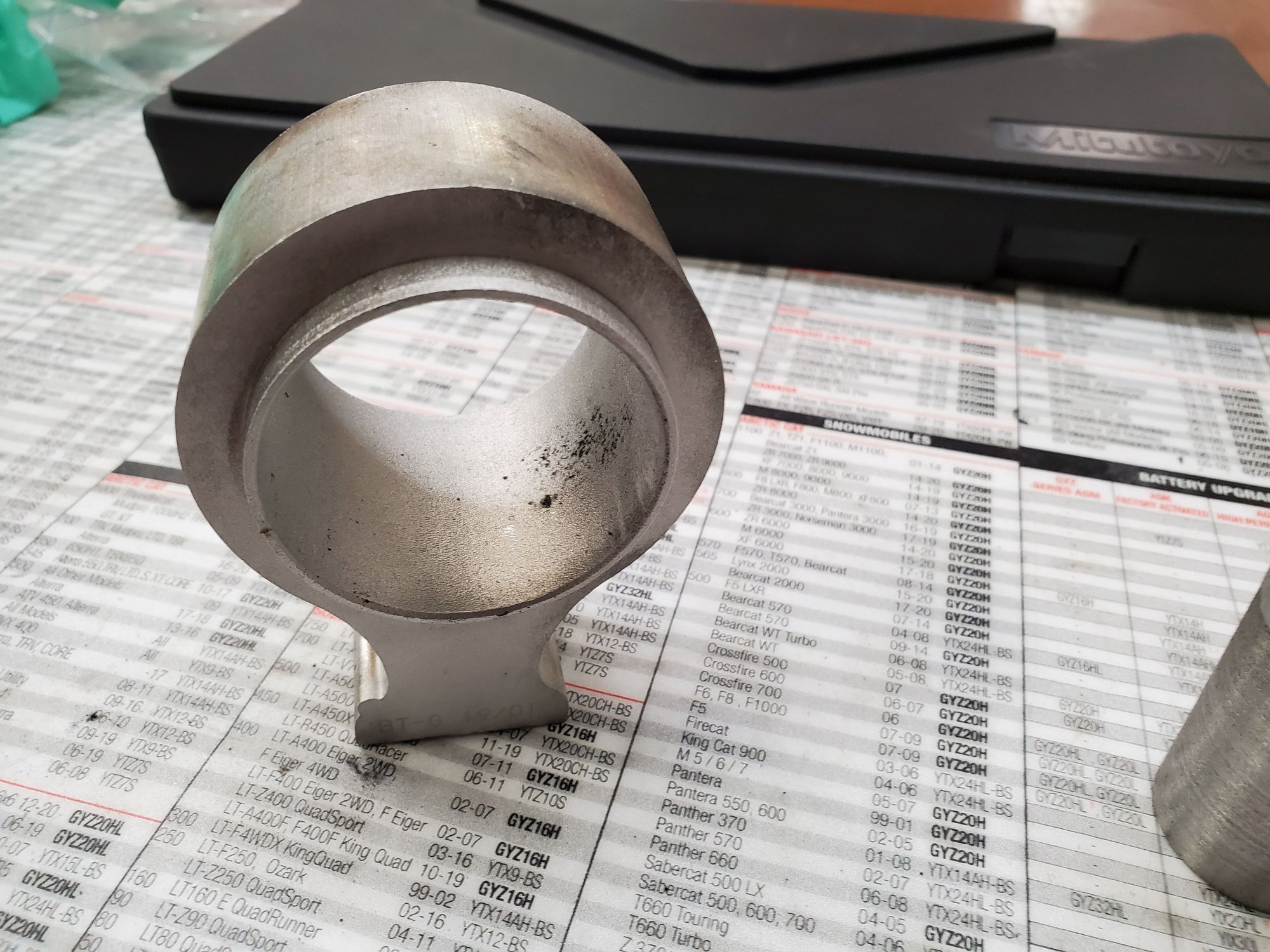

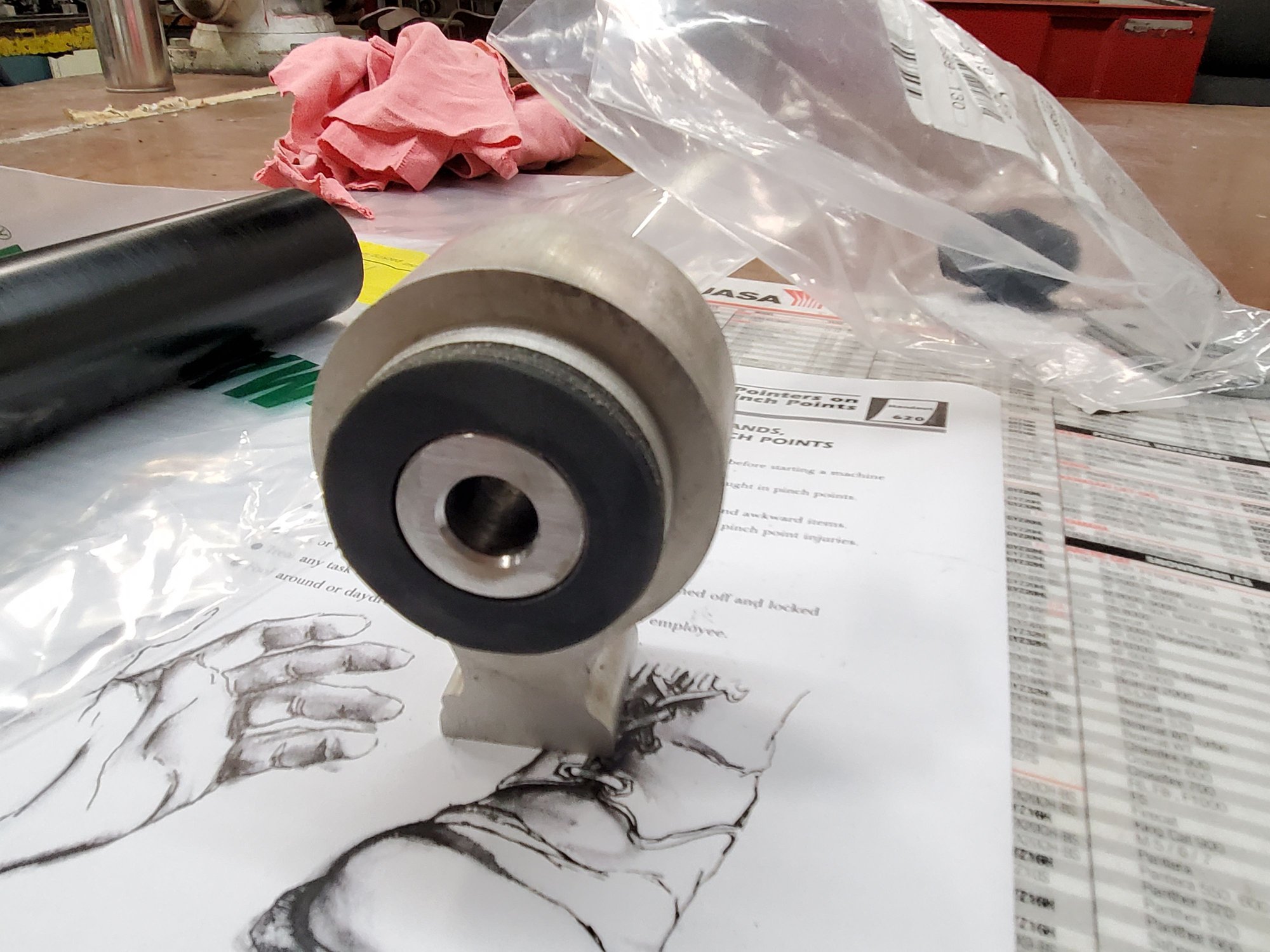

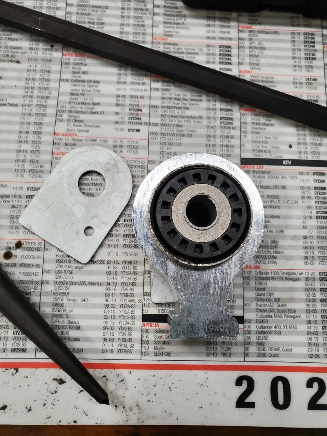

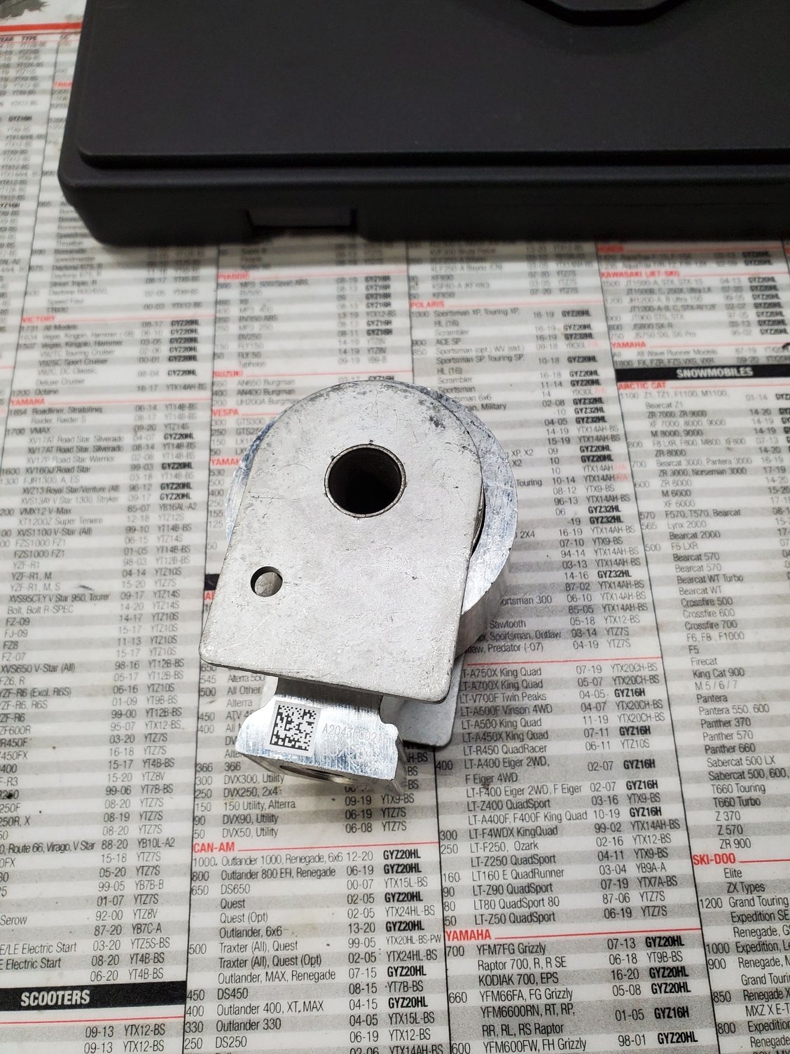

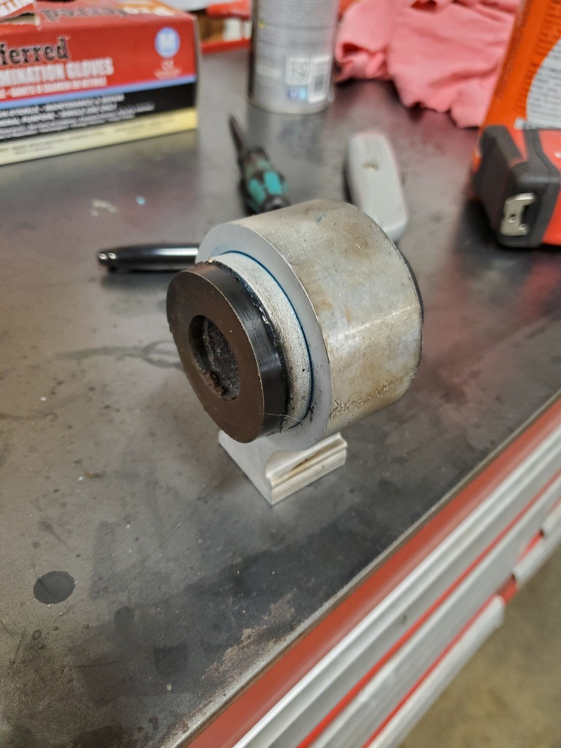

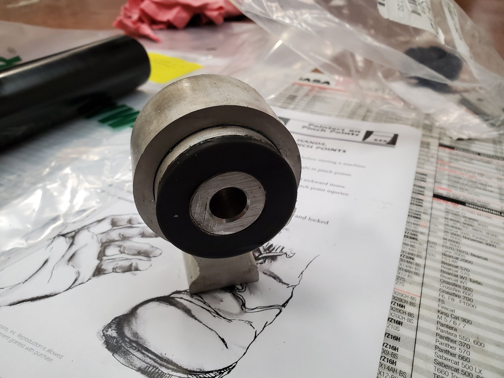

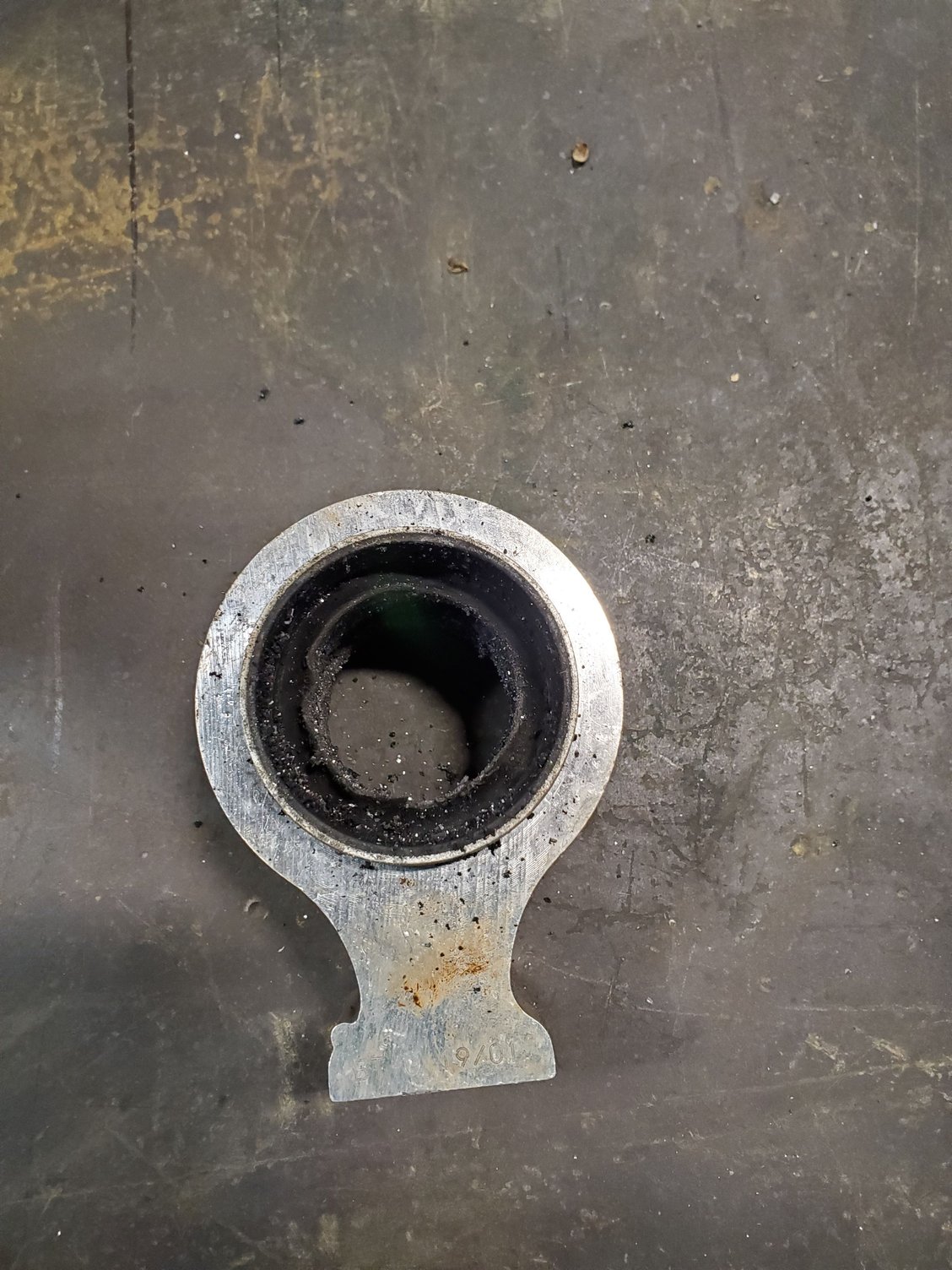

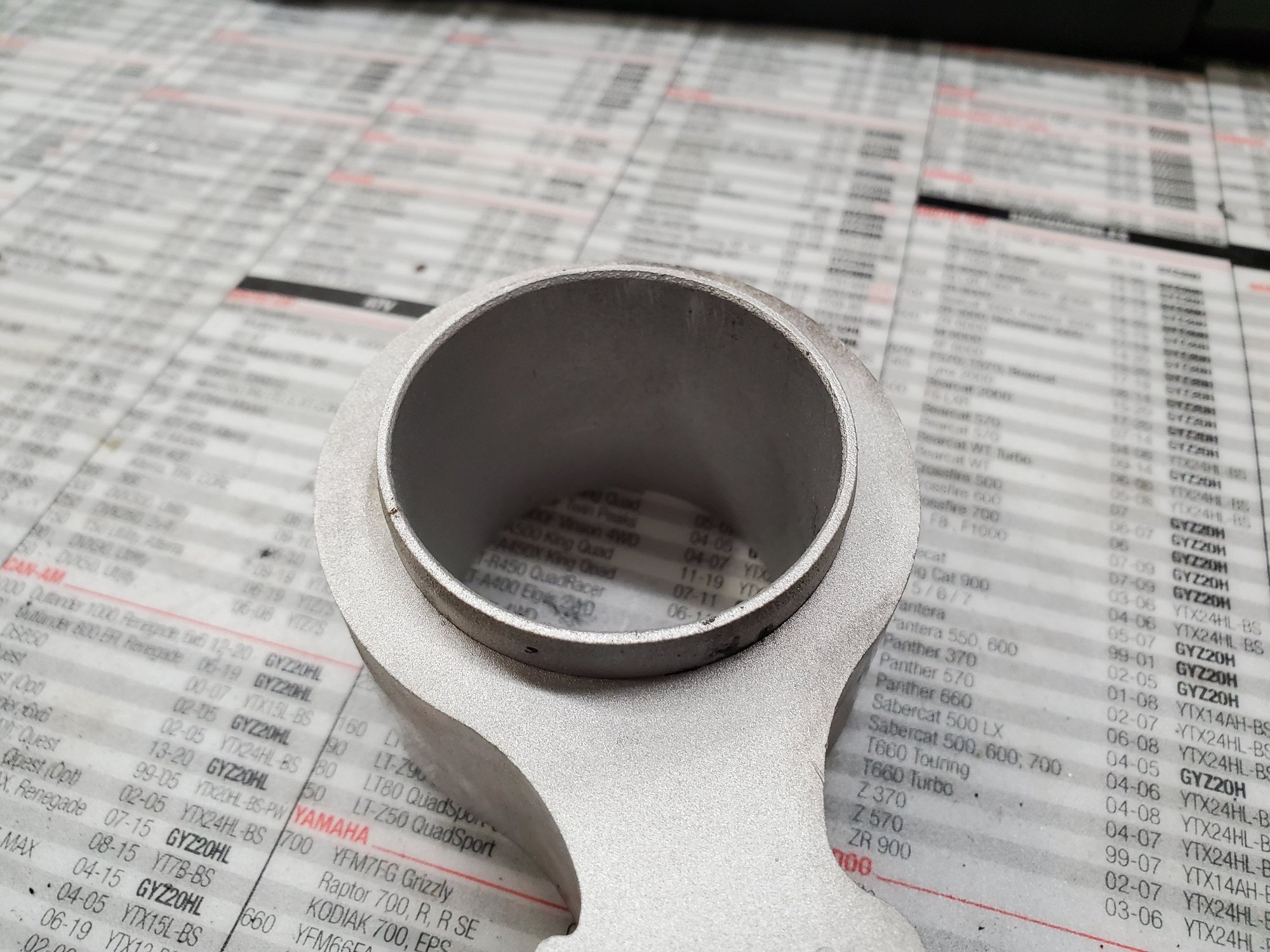

But, here's another little project I've been working on myself at work. My front diff mount must be getting squishy because i now have some light grooves on my carbon driveshaft. Which literally scares the **** out of me now that I threw a whipple on. Theres roughly 3/8 to 1/2 gap between the driveshaft and heat shield for the fuel tank and its still rubbing. So I'm guessing I'm torqueing the hell out of the mount. Since noone makes a poly one I decided to tackle it myself.
I had my buddy who works for mercedes order me a new mount and decided to tear it apart. I also ordered a 12 inch black ***** of 80A polyurethane rod stock 2 in in diameter. Made a new steel bushing insert as the original was cheap aluminum. Its not pretty but I feel its going to be pretty functional and work well...... I hope. Now I have no experience with machining poly and honestly have no idea what the **** im doing with it nor did I have the proper tooling to machine it on a lathe. But all in all I think it turned out decent and should work as intended.

Forgot to mention that I'll couple this with the kmac rear diff mounts to make it solid.

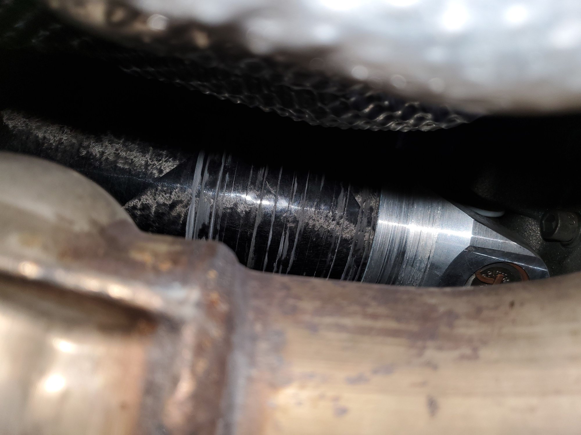

I'm torqueing the front of the diff enough under loading the car for launching and it was causing rubbing. Which is a big yikes with carbon driveshaft. I feel like if I could get machining efficiency up I could make the complete mount with new oem housing for about 100-120 bucks. So ill look into it a bit more.
Here's the grooves in my driveshaft which are hard to see. Granted I can fit my hand between the heat shield and shaft but I also have skinny fingers and not sausage links......

Yikes dude, that’s really not good, sorry. I’ve heard that carbon likes to fracture around light damage like that. Might look into getting that repaired if possible. Maybe ask QA1 or DSS what you should do.
Need to take a look at mine now...

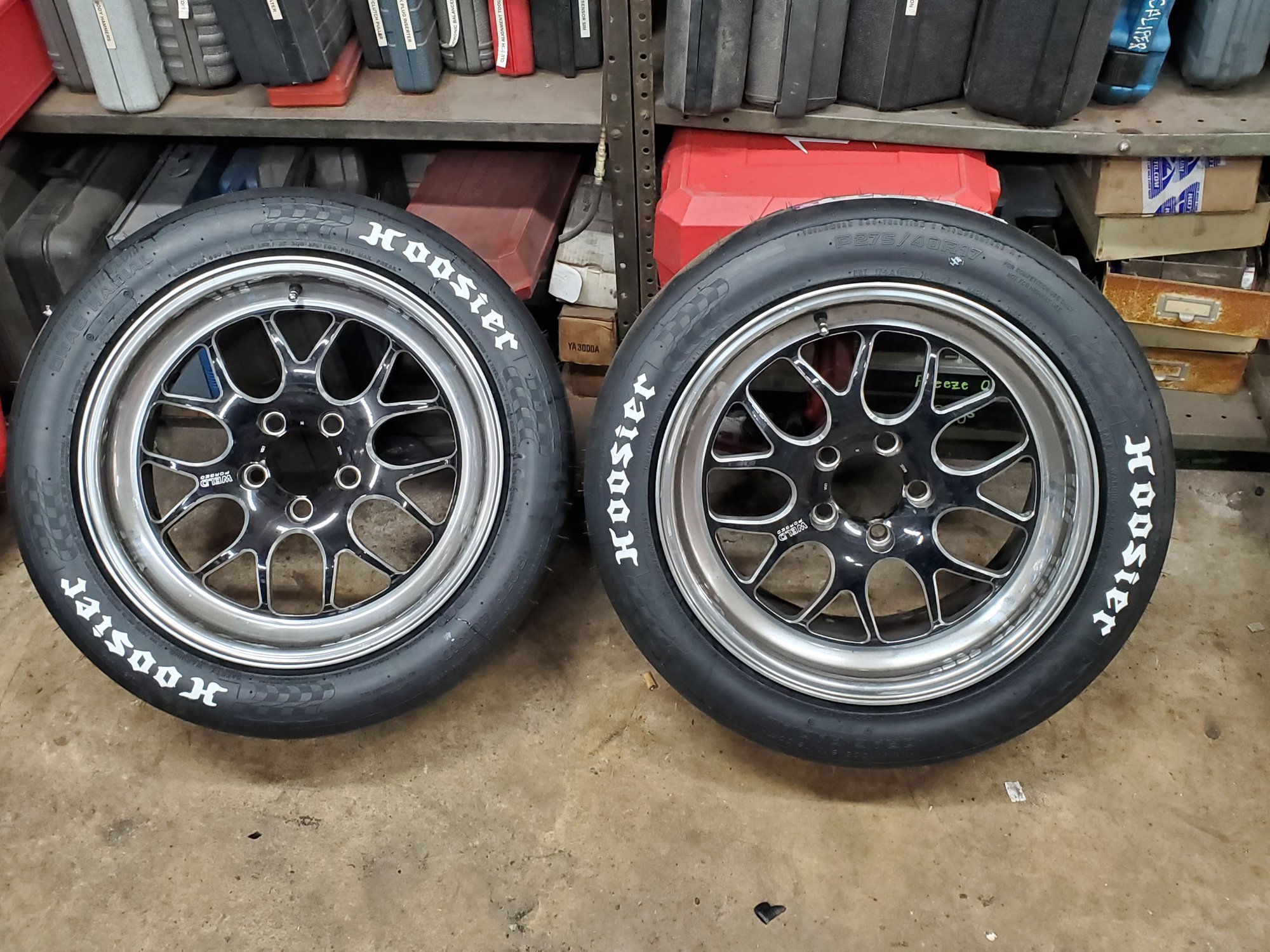

Also my new 275 hoosier dr2 mounted on my weld wheels.

Also intakes are finished and installed along with my a pic of my hoosiers

Interested to see what kind of 60' you can get with the Hoosiers. I have the same set on lightweight 17" Enkei's.
