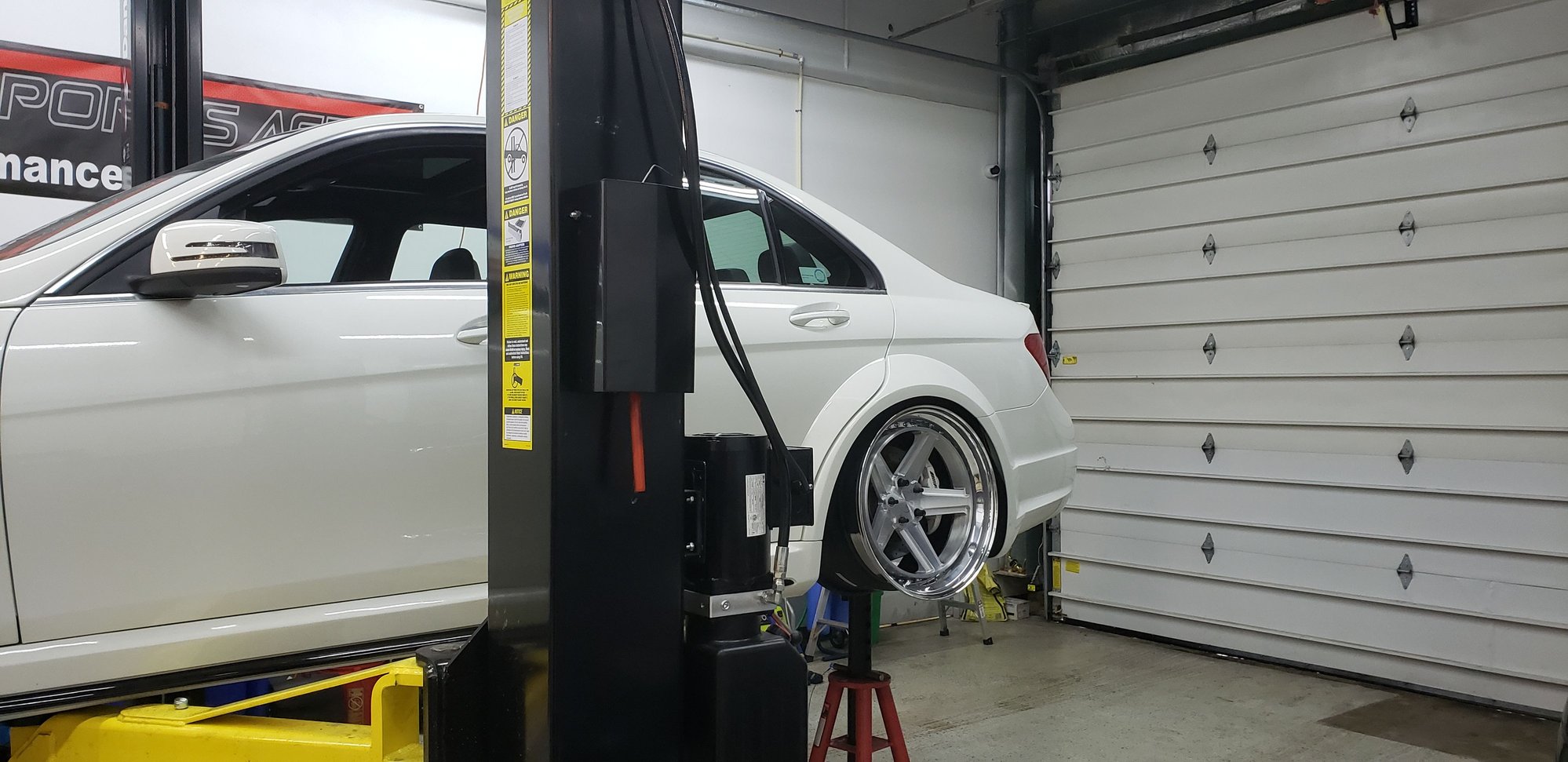

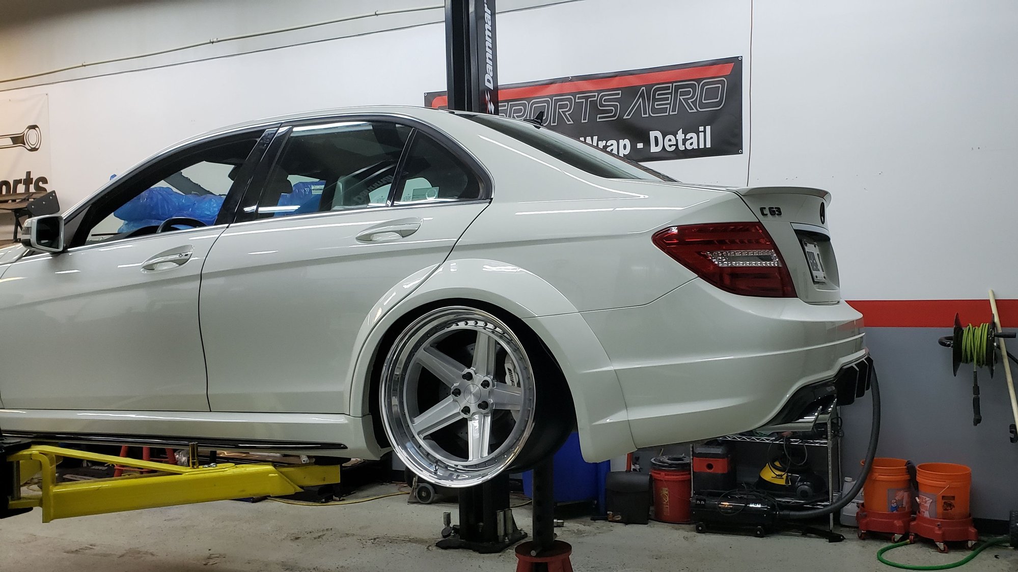

Went thru wheel fitting and it looks like I have a lot of work to do with my KMAC parts to get this car dialed in. Almost there!

How are those fronts going to work with tires on them?

I have to send out the top plates to get machined out to be able to bring them in more. I have KMAC lower bushings to bring the bottoms in as well. The whole car is on air ride, so this is the max drop height. Once that's established, I'll check clearance for travel as the tire should tuck in behind the fenders. Then, I'll raise the car up to ride height and then get an alignment to get back to as close to a stock alignment as possible.

The car is on air ride and we're just getting fitment sorted for maximum drop height. Should the air ride fail, it won't come crashing down onto the body work. The car will be raised to a reasonable low drive height and camber adjusted back to OEM as possible to get a good contact patch.
