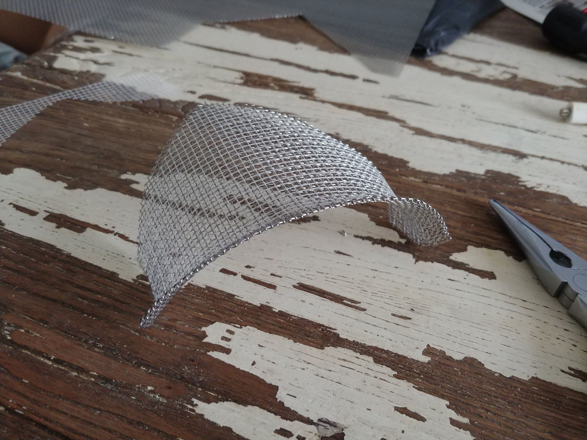

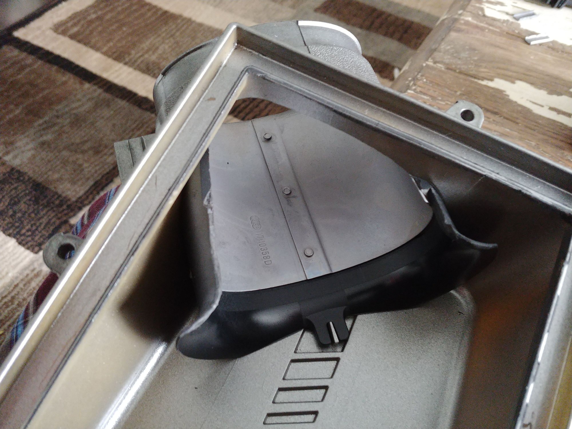

day one of the work begins...had to head out of town so plenty of work to come. many more coats and a few hours of grinding and sanding are in order, but here is what I have been working on.

Let’s use JB weld after the filter on a car with a 20K engine ... when a vendor, and the oem manufacture already make the part you are trying to recreate. Some people I’ll never understand.

i spent 52 dollars and labor, and will have a lot of excess material...that is a huge difference to the 350+ for the OEM ROW airboxes.
