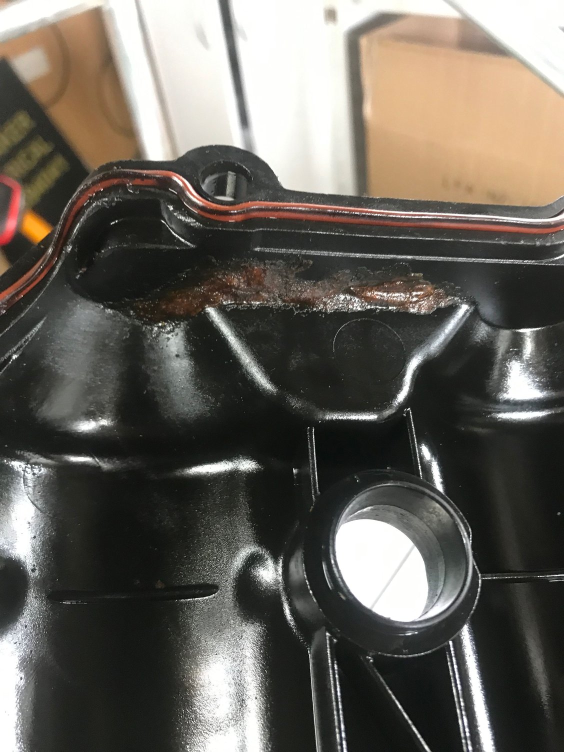

So finally got my valve cover off,
It would appear it is cracked at the back and has had a repair.
The valve cover gasket looked pretty good and most of the oil appears to be coming from coil 3, which appeared to have no spark plug gasket what so ever?!
What you guys reckon, new valve cover or let it be? If new, wheres the best place to buy one?
Thanks
Old Oct 30, 2019 | 10:20 PM
roadkillrob's Avatar
Top Answer: 1
Joined: Aug 2016
Posts: 2,405
Likes: 724
12 C63BS Magno Alanite Grey, 25 X5 Msport, 08 BMW E93, Ducati Hyper 698
I would replace maybe get a good used one as they are 250 new.
