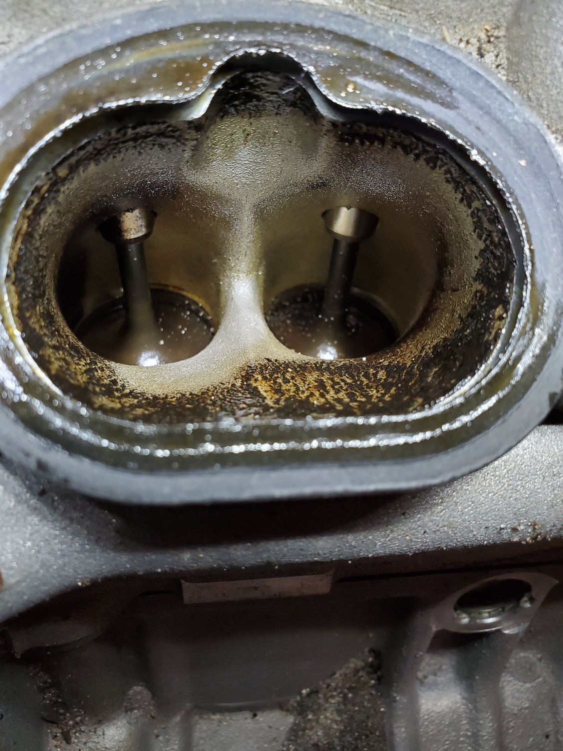

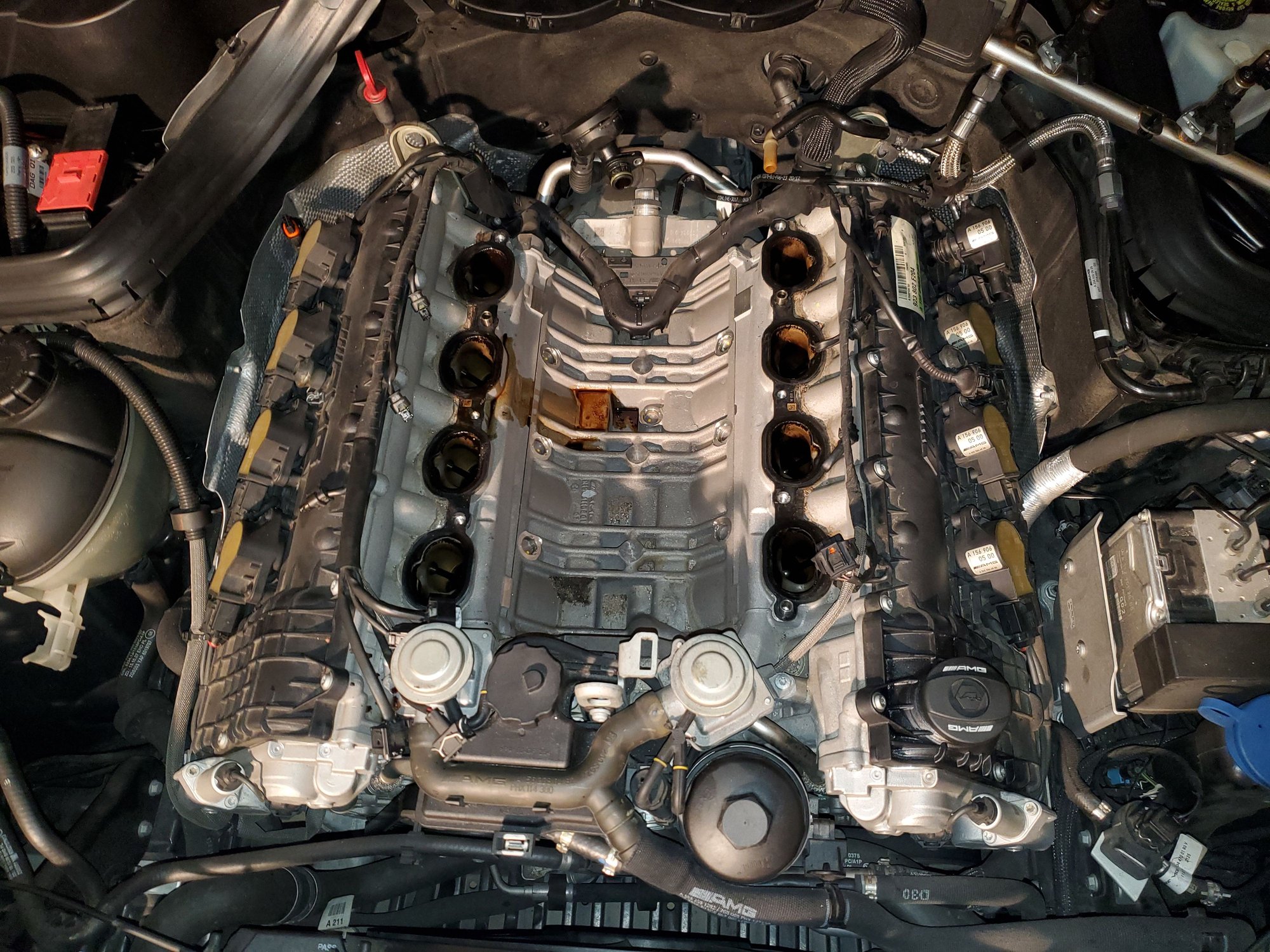

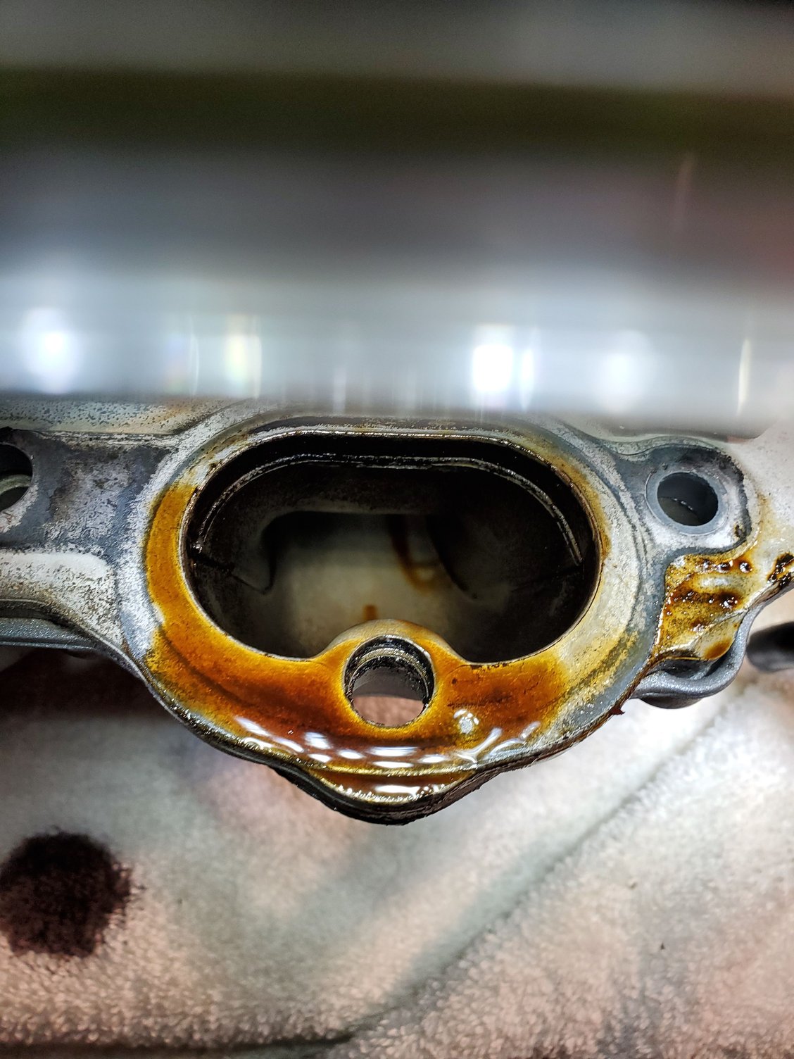

I don't know if it gives me comfort that all maintenance, cleaning, and servicing will be done to my standards or bothered by how much junk I'm finding.... Luckily, I like doing this crap.
Btw, those that have blocked off the breather to the manifold (my bad, I meant block off the inlet of the manifold) , have you gotten any codes as a result? I'm thinking it wouldn't, since it's pressure, vacuum, and mechanical. No sensors tied to it, however I'm questioning if it may throw off the O2s?

Catch can is by far the best option. Putting a filter on the outlet is a messy and sub-optimal solution. They drip, you get oil film covering anything nearby, and it’s just not the right thing to do. Plus as mentioned above you lose the scavenging effect. Sticking a filter on is something you did to an Eagle Talon 25yrs ago because you were broke and didn’t have enough money to buy a catch can. Don’t be that guy.

If you had more than 60k milres on it I wouldnt even bother because that build up you have doesn't look bad at all.
As mentioned above a catch can is your only reasonable option.

Old Nov 24, 2019 | 10:31 PM
icantthnkof1's Avatar
Joined: Aug 2014
Posts: 73
2005 E46 M3 - sold 2013 C63 Coupe
Quick pic update. Found a plug that has a positive snug fit and looks oem.
