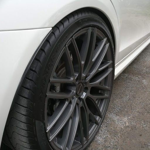

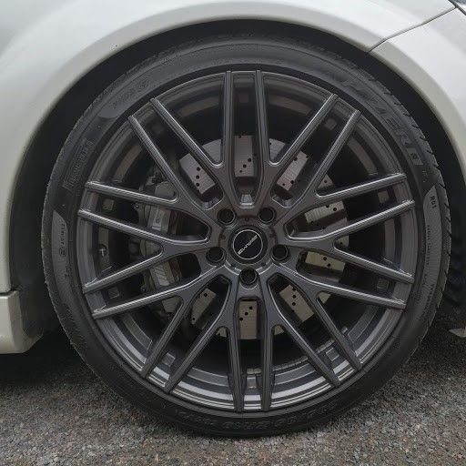

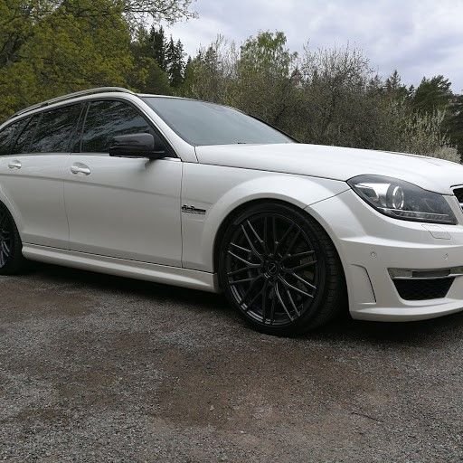

I´m running std oem 19" with 235/35 tires in front and 265/30 rear, combined with H&R 20mm loweringsprings, no problems.
I´m about to fit 5mm spacers in rear and 5 or 8mm in front, it will still not rub.

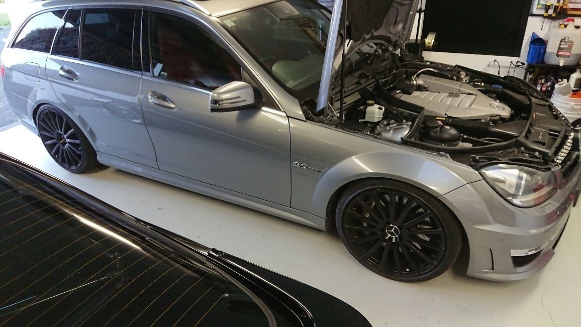

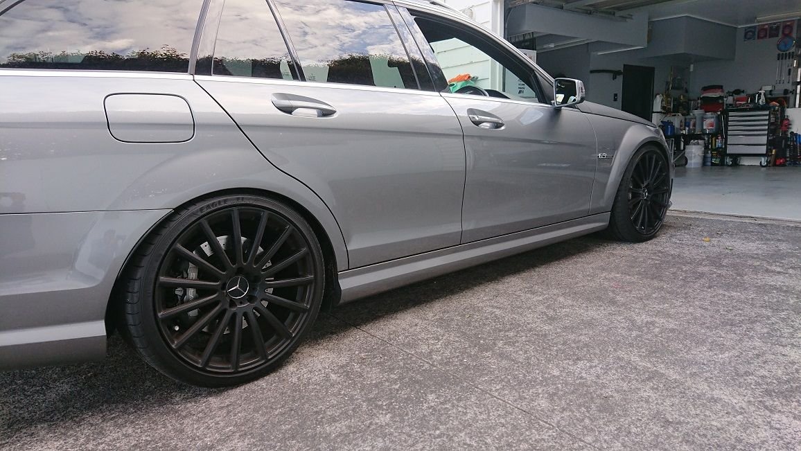

Not sure if this help but i'm running the H&R Springs on my Estate which has 19" , 235 front and 255 back with no clearance or rubbing issues can upload an image of how it sits if you would like.

FC Man If you don’t mind I’d love to see how she looks Thanks
You may have trouble with those size spacers as they will not have hub-centric rings and your wheels will no longer center on the OEM hub centers as the wheels will be spaced out too far. This will generally lead to vibrations starting at about 65mph depending on the hub face of your wheels you may get away with 5mm spacers. My experience is 3mm spacers are about the most you can run and still have your wheels center on the OEM hub centering rings. The hub centers on our C63s are 8mm high and the minimum spacer width, with a built in hub centering ring, you can run are 10 mm. A lot of people run 10 -12 (maybe even 15) mm spacers front and 10 mm rear. Not exactly sure of the fitment with a 265 on the rear but you might still be able to clear. There are a lot of posts on here and I am sure one will have that combination and explain if they fit or not and rubbed a little.

This is stock 19" wheel size but with 45 offset rear and 35 front, wheels are 275/30 and 235/35.
Lowered with no rubbing at all.
I stand corrected 265's on the rear.
