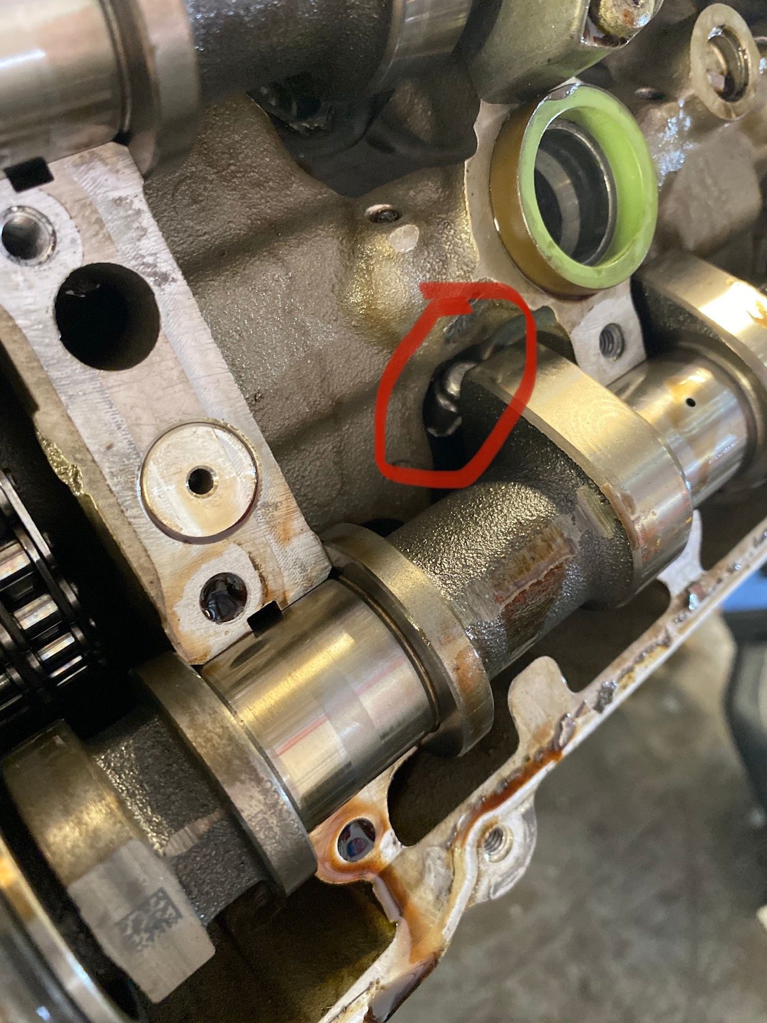

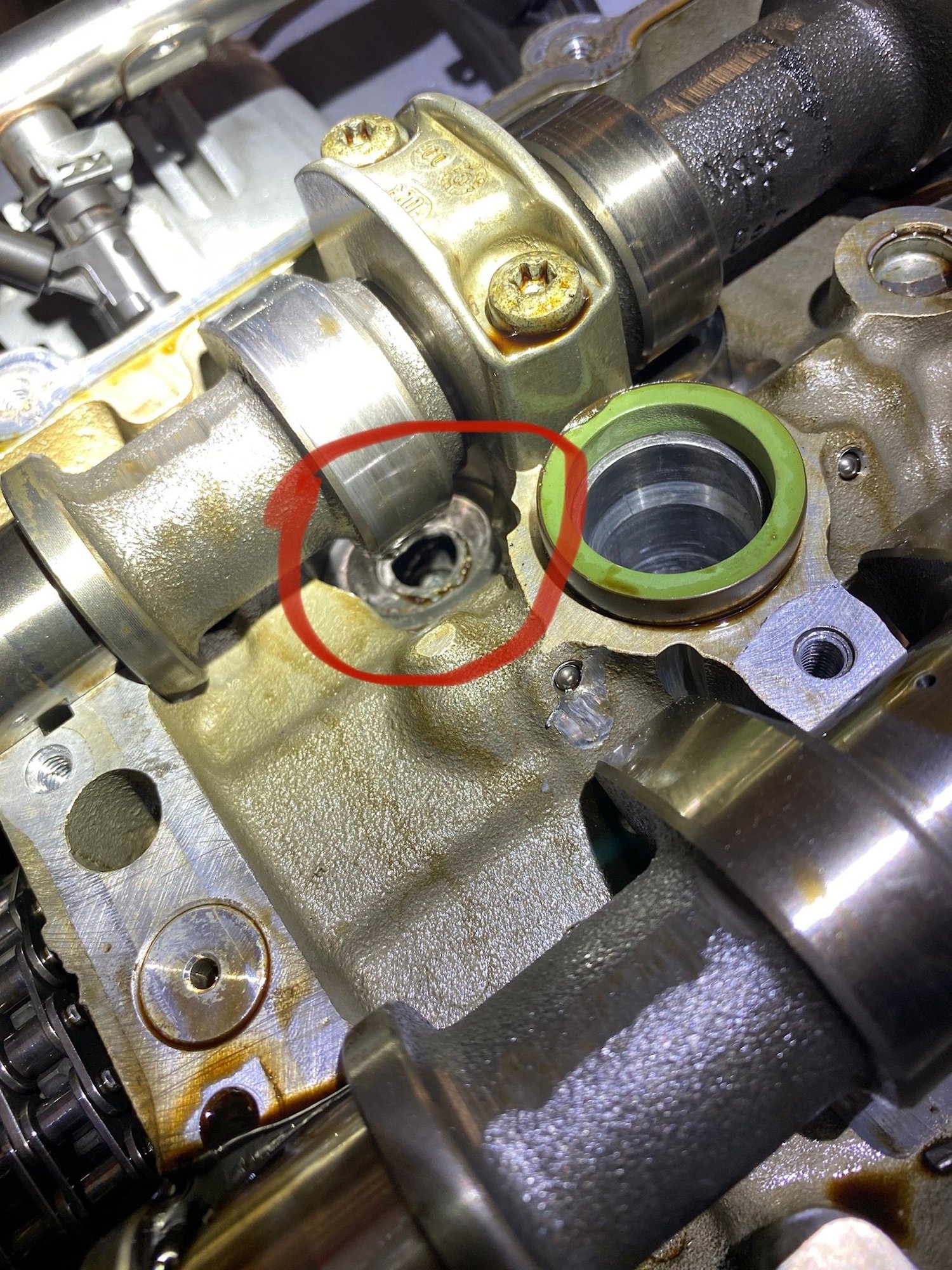

So I ended up buying a p31 engine and swapped it in. Once my old engine was out we opened it up and this is what we found:
the cams were stuck and no wiggle at all. They were really worn out as well.

Old May 15, 2020 | 08:06 PM
SROC276's Avatar
Joined: Dec 2012
Posts: 600
From: Bay Area
2010 C63 P31 AMG
Man sorry...ate through the bucket? Surprised it happened quite early at 80k miles. Was car maintained well prior to you buying it? Well glad you got a new engine now.
Old May 15, 2020 | 11:21 PM
Cwagon's Avatar
Joined: Mar 2019
Posts: 522
Likes: 129
From: Bondi Beach , Australia
2013 W204 C63 AMG P31 Estate wagon
There were no ticking noises before the engine stopped.
I changed my buckets out at 100,000 klms (60k/miles).
A few had straight across wear marks where they had stopped rotating but nothing serious.
