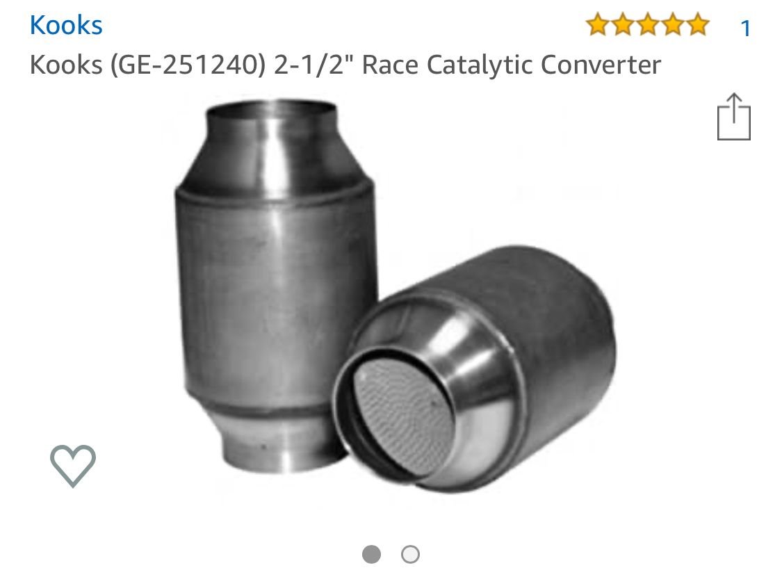

I went with Kooks Performance 2.5” 300 cell race cats.
