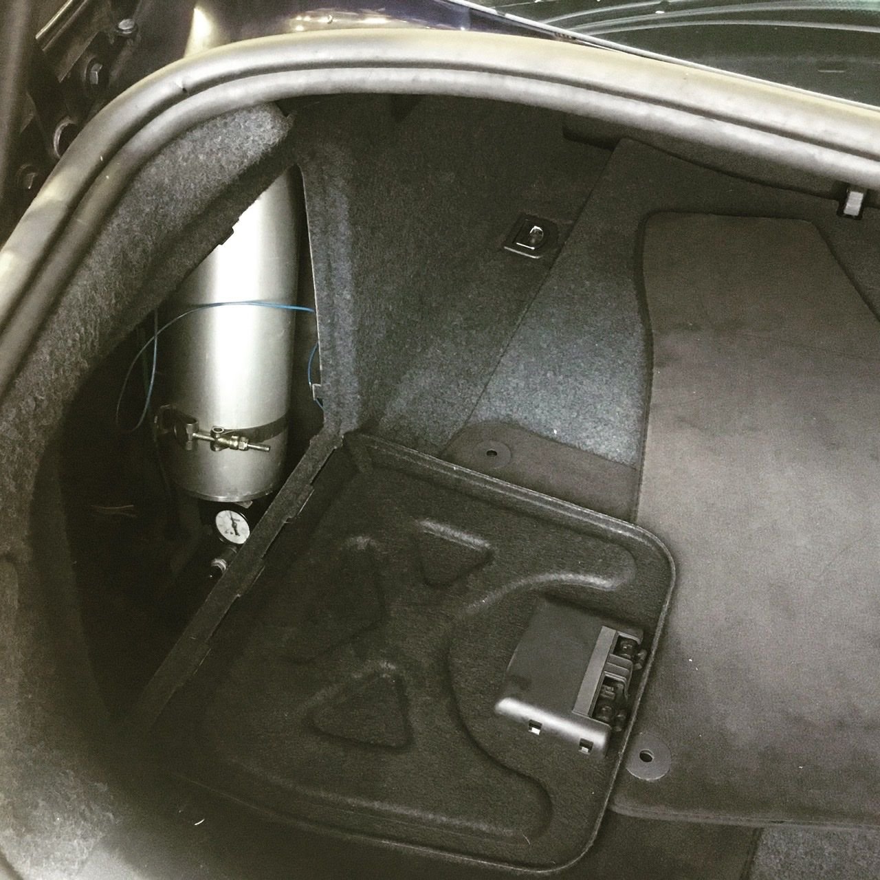

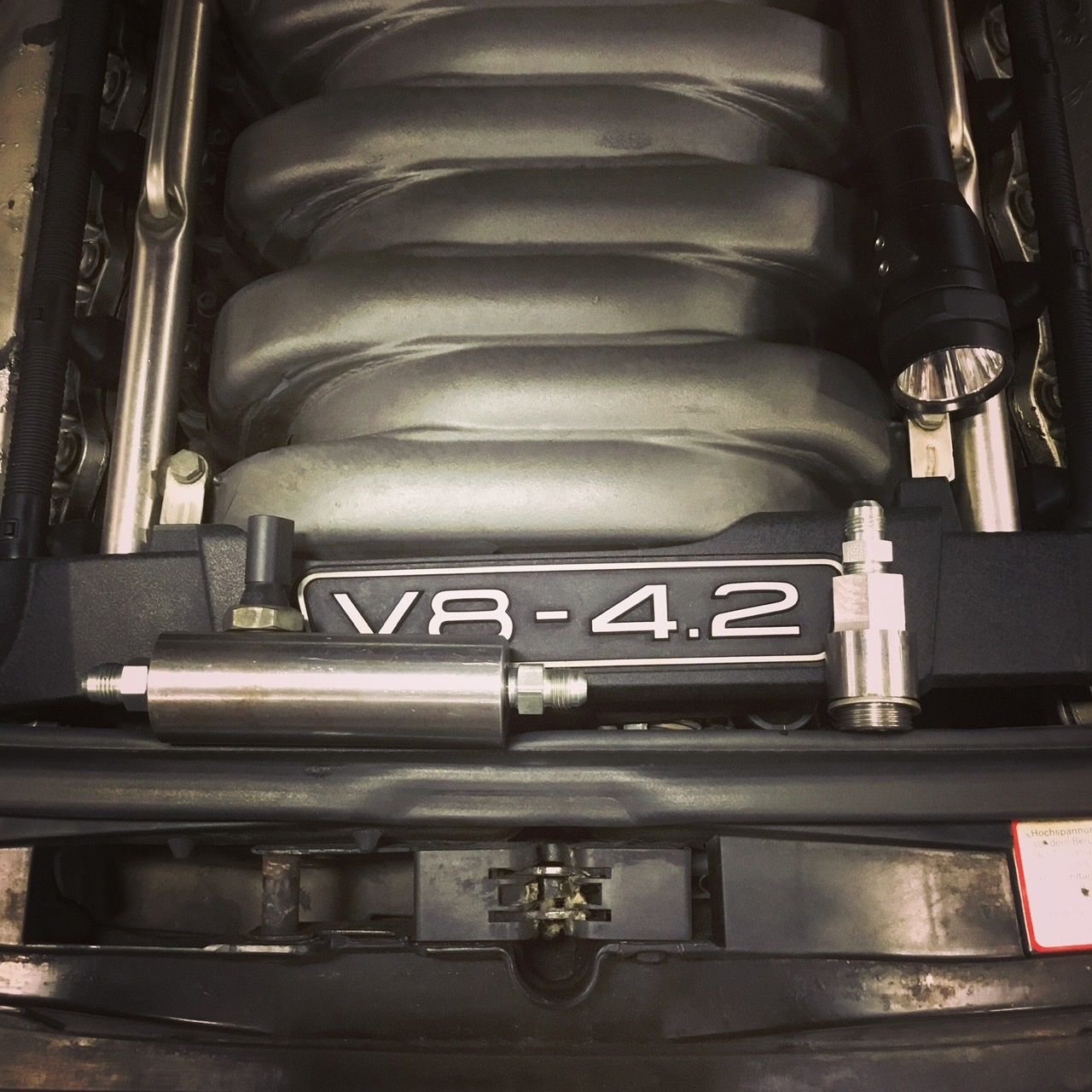

The initial fill is accomplished by preloading the Accusump air side to 80PSI. While the engine is running and with the valve open the air is slowly bled down to zero. Once the pressure reaches zero, the valve is closed, the engine shut down, and the air brought back up to 80 PSI.
The way around the pressure drop while filling the Accusump is to use the solenoid valve. Leave it closed during the fill phase.
I have a very similar system on my B6 S4. It also uses the factory oil pressure port location.
The solenoid valve acts like a check valve for the Accusump when closed, it will allow it to fill slowly, while not letting anything out.
I had similar concerns when I first installed it on the Audi. It was never an issue. That Accusump in the Audi is hidden in the trunk where the optional 6 disc CD changer is supposed to go. It has 3/4” hydraulic hose running in Adele clamps on factory studs all the way up to the vicinity of the transmission mount where it drops down to 1/2” hose.
Typical operation of the Accusump for prelube on a start is to turn the ignition on, open the solenoid valve, wait for the oil pressure to climb, once it peaks and starts to drop, close the solenoid and start the engine.
During normal driving, the Accusump remains closed to the rest of the circuit, unless the pressure of the circuit exceeds that of the Accusump, in which case the Accusump will rise in pressure to reach the system peak.
The adapters I made for the project. The one on the right adapts the M24x1.5 port to 1/4NPT—6JIC. The part on the left has a 1/8NPT port for an oil pressure gauge as well as an M10x1.0 port for the OE pressure sender, with a pass through on either end for a hydraulic hose to the Accusump.
Accusump in the trunk of the S4.
There is access to the main gallery on the M156 behind the flex plate in the bell housing where the big block off plug is, but getting a hose out of there would be labor intensive to say the least.
