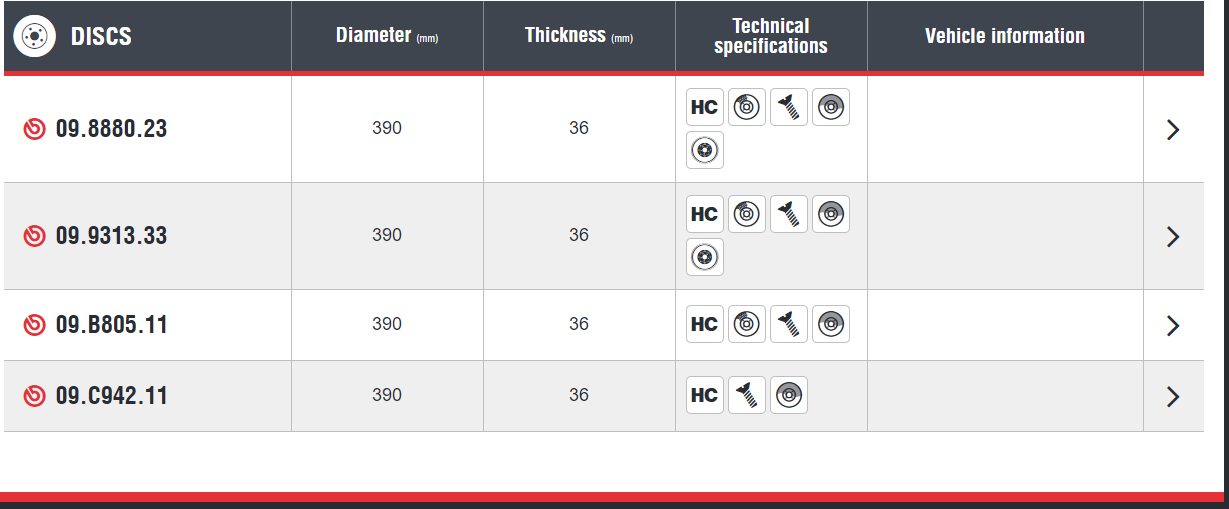

Those are all the 390mm by 36mm discs Brembo has listed. but with different offsets.

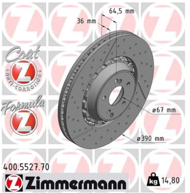

And just found a Zimmerman one piece 390mm disc.

This is fantastic info.
Any prints on the Zimmerman?
Edit, I’m stupid.
The Zimmerman is a direct fit.
If the 390 absolutely won’t fit under an 18” wheel, the 380 will.
