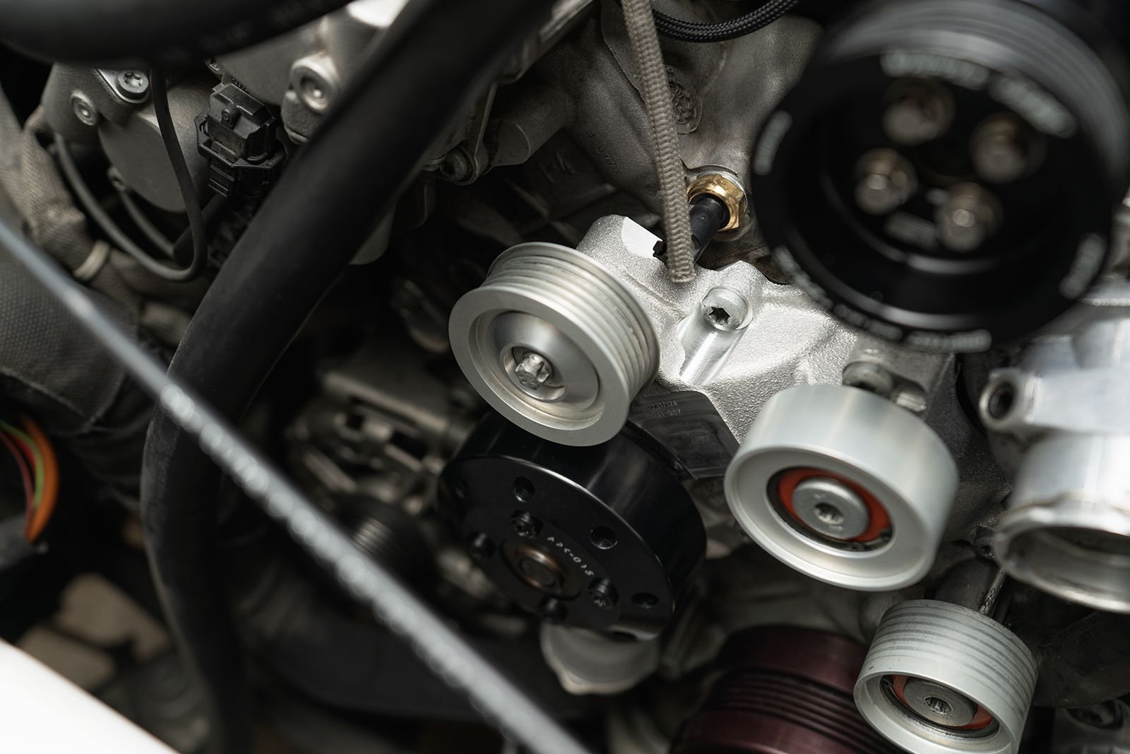

Doing some winter maintenance.
  • New water pump with light weight billet aluminum pulley and titanium bolts
  • Replaced coolant reservoir
  • Replaced coolant sensor

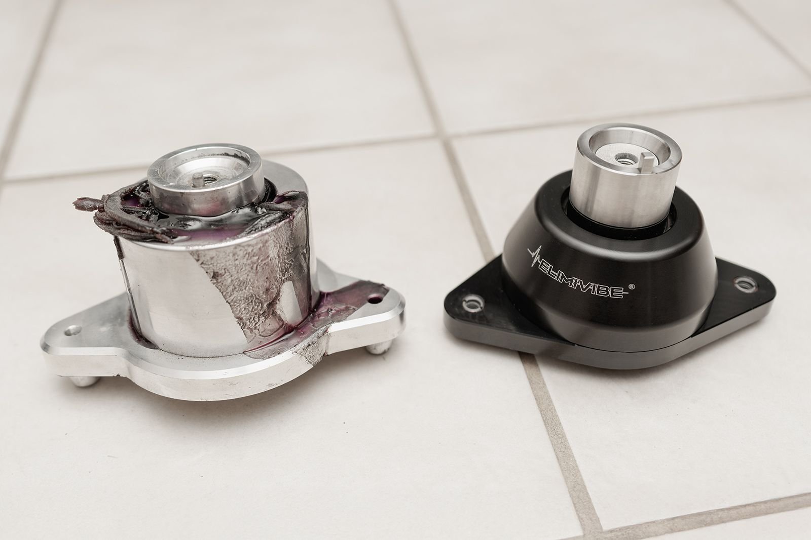

Swapped out the VRP engine mounts with Creative Steel mounts. After 2 years the polyurethane started to melt with the excessive heat of the long tube headers. I'm going to rebuild them with the updated polyurethane inserts and keep them as spares.
So far very impressed with the build quality of the Creative Steel mounts, they're more compact and a bit easier to install. We'll see how they hold up to the heat.

Out of curiosity, are your long tube headers ceramic coated?

They're not coated, the poly inserts on the VRP mounts are the softer first generation they offered. I believe they offer some high heat rating inserts now so gonna rebuild them with those. Want to test out the Creative Steel ones first to see how they hold up.

‘If you ever pull your long tubes I’d suggest getting them coated. Definitely helps keep heat out of the engine bay. 👍
