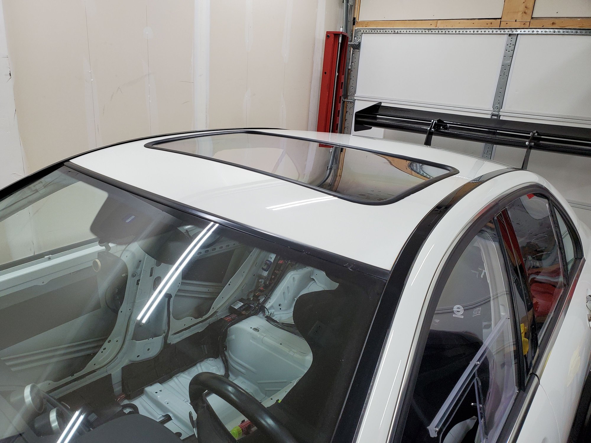

So did you have the roof reskinned with steel or aluminum then? I'd be interested in doing that way before any other weight savings since it's hot in the Summer and noisy all damn year.

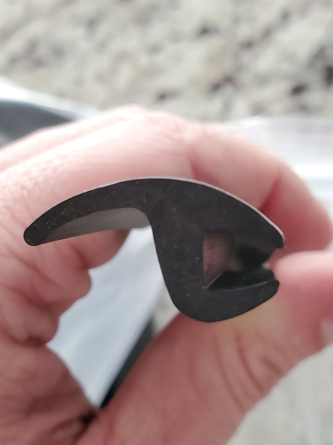

I used 1/4" polycarbonate to fill the gap. Rubber window moulding with 3M window adhesive to secure it.
Ah, I was confused and thought you'd ditched a pano roof.

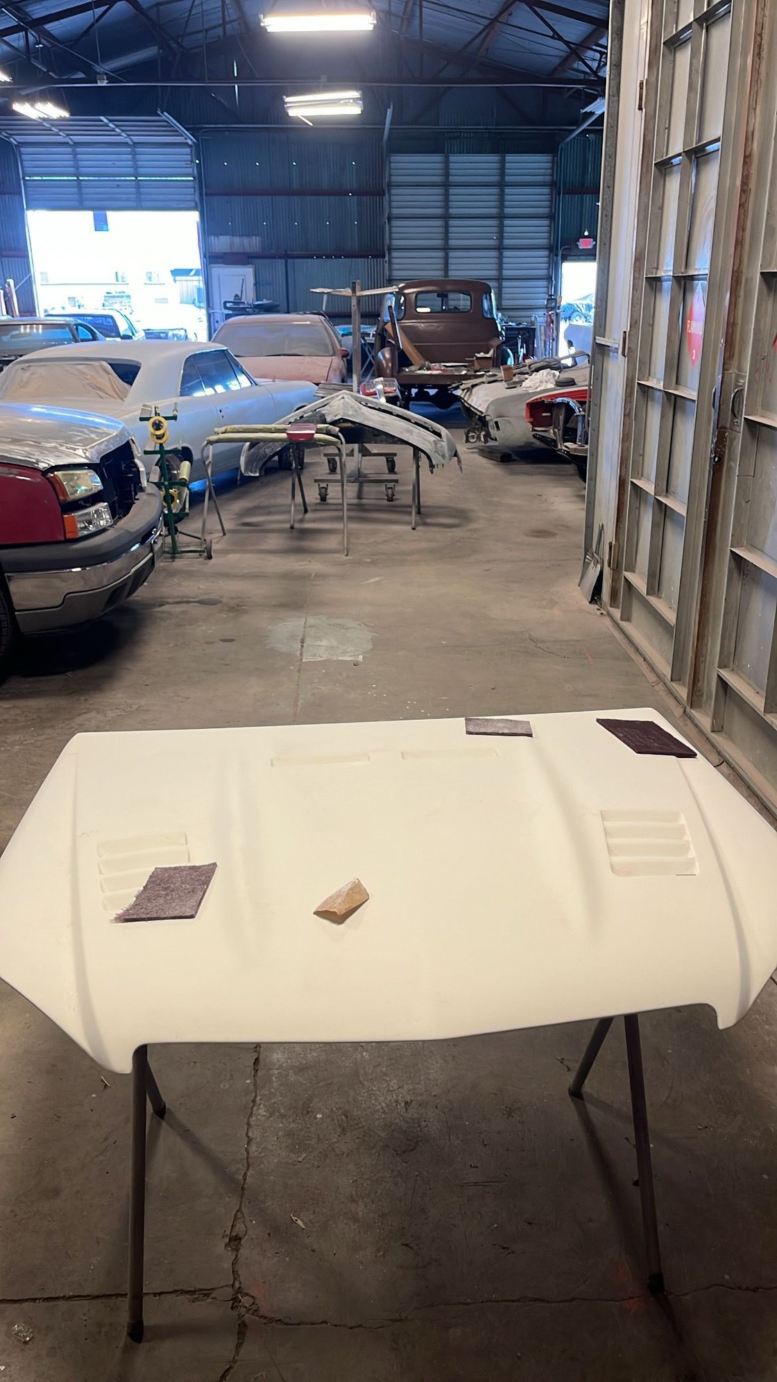

prepped cf dadsc63 hood and cf fenders for paint

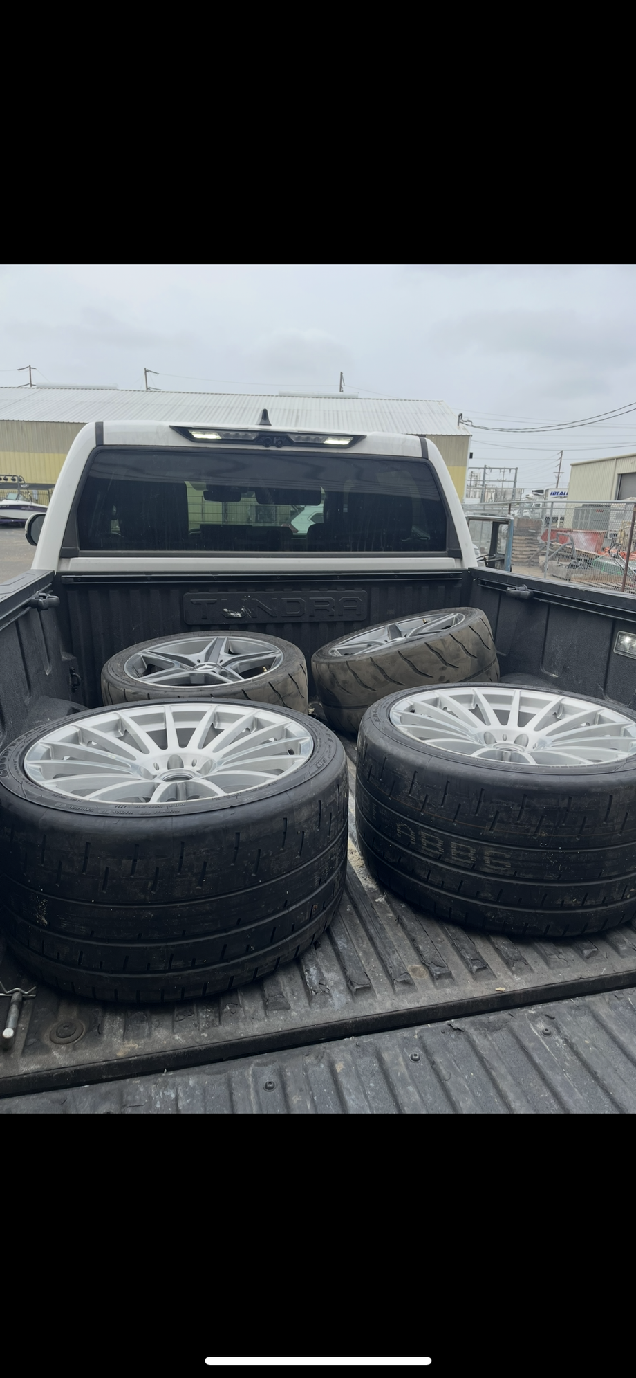

I got new sets of pirelli tires

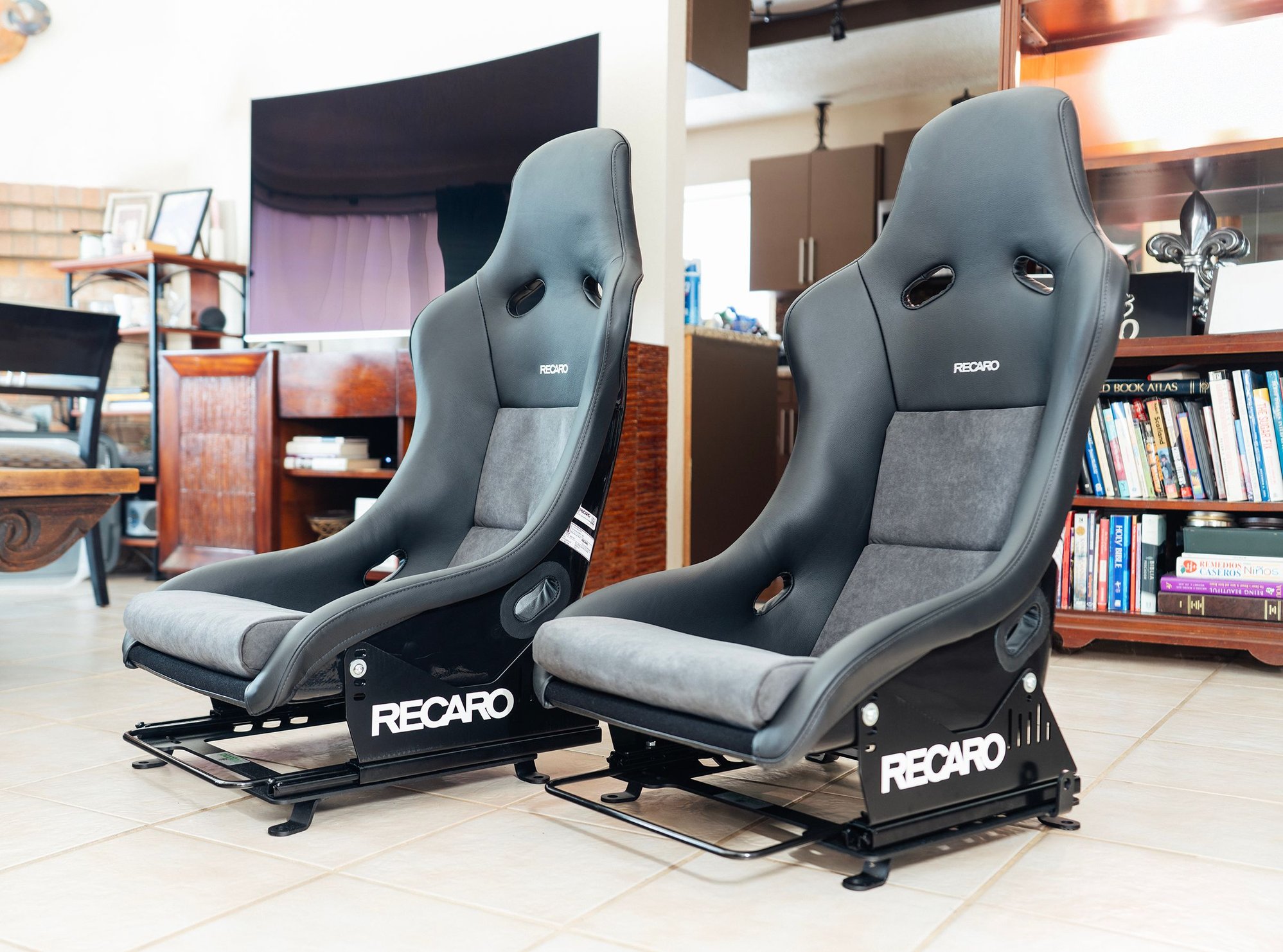

Finally got my Recaro Pole Position seats after 7 months wait caused by their bankruptcy, they started production again a few months ago but have a huge backlog of orders. Hopefully I can install them over the weekend.
Any idea on weight savings with those?
Recaro seats with mounting brackets around 35lbs each, my stock E63 seats are probably over 70lbs each so it should be a nice chunk of weight savings.
Could you share some more info on this? Did you cut the polycarbonate yourself? How's it holing up now that a little time has passed? All you did was remove the glass, wiring and motor? This seems like a more tangible option than getting a cf roof fabricated or swapping the roof from a no sunroof optioned w204

Sunroof Steps:
  • Remove complete sunroof.
  • Tape template material onto the roof to trace the opening from inside the car (I used thick underlay paper)
  • Draw a cut line on the inside of the trace minus the thickness of whatever molding you use with some wiggle room to create a template.
  • Use the template to cut out the polycarbonate panel. (I used a Jig Saw with a fine tooth blade for plastic)
  • Tape the window molding to the poly panel so you can do a dry fit first.
  • Glue the molding to the poly panel.
  • Glue the assembly into opening (just like you would with a windshield. I used 3M window adhesive)
  • I had to use weights on all 4 corners because of the roof contour and left it on for a day or so. (Whatever the cure time was on the adhesive)
It was relatively simple, just time consuming. Has been in the car since 2021 without issue.
